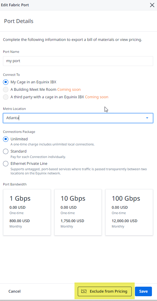

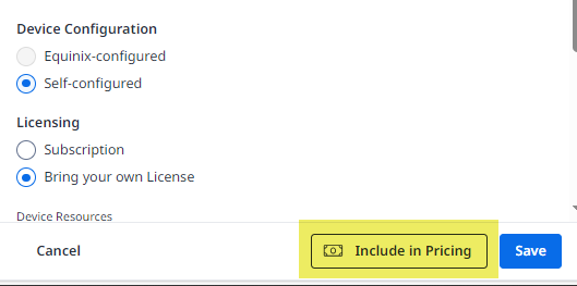

Excluding Components from Pricing​
You can exclude any of the components in your solution diagram from the pricing summary. This functionality allows you to see what new components will truly cost when added to existing devices.
To exclude a component while you are creating your diagram, hover over the new component and click the Exclude from Pricing icon.
To add the excluded components back into the pricing summary, click the Include in Pricing icon.
To exclude a component while configuring it, click Exclude from Pricing at the bottom of the dialog.
To add the excluded components back into the pricing summary, click Include in Pricing.
