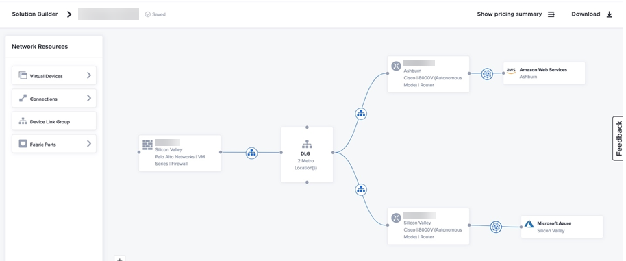

  1. In Resources, select and then drag Device Link Group to the diagram workspace. In order to calculate pricing for the DLG, your design needs to have at least two devices with metro information.
  2. Use your cursor to draw a line between the dots of your devices to the DLG resource. You cannot connect a device to DLG if the device metro is not selected.
  3. Double-click DLG object or click the pencil after selecting the object. The following options need to be selected before completing DLG pricing:
    • If the DLG is for Point-to-Point (connecting devices in two metro locations), connection bandwidth needs to be selected for those two metros. Pricing will be based on the originating metro (A-side).
    • If the DLG is connecting more than two metros, you can select a single bandwidth speed for all links, or change bandwidth speed for individual links by selecting the Individual Connection Bandwidth option. Price for the DLG link is displayed with local currency of the Metro where device is located.
    • There is no cost to link multiple devices in the same Metro.
    • Additional taxes and fees may apply, depending on the Metro.
  4. To remove a device from the DLG, click the DLG link icon and then click the trash icon. Click Remove in the Removing Network Resource box after confirming.
