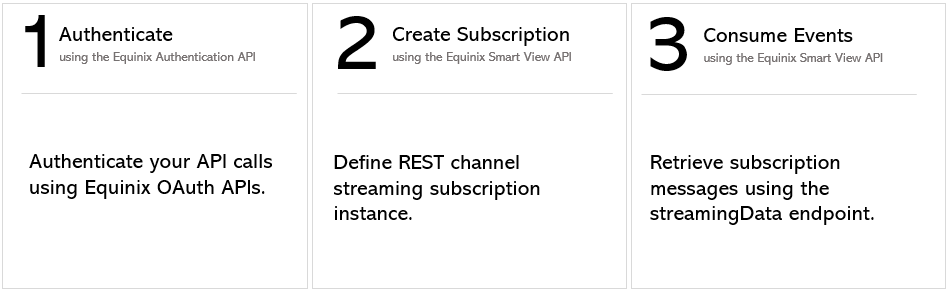

The Streaming API supports creating a subscription to enable retrieving your data from the Equinix API.
Prerequisites​
  • Submit your user credentials, Client ID, and Client Secret for OAuth2 authentication. Refer to API Authentication for more information on how to authenticate your requests to the Equinix API.
  • Create a Subscription. Send a POST request to the /smartview/v2/streaming/subscriptions endpoint and specify the channelType as REST. The Location header in the response contains the subscription ID required to consume the real-time feed. For more information, see Creating a Subscription.
Retrieving the Data​
To retrieve your REST streaming channel messages, send a GET request to the smartview/v2/streaming/subscriptionData/{subscriptionId} endpoint.
