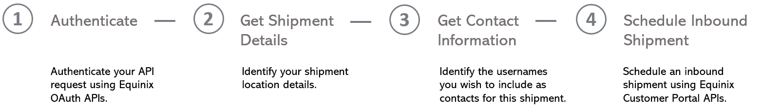

Scheduling an Inbound Shipment​
To schedule an Inbound Shipment, send a POST request to the /colocations/v2/orders/shipments endpoint. Use the "type": "INBOUND" parameter to specify that it is an Inbound Shipment, and provide the rest of the shipment details in the body of the request. An inbound shipment request minimally requires the shipment type, shipment date, associated cage, carrier, and number of boxes to be included. The other necessary information you need to pass in the inbound shipment request body depends on the following:
  • If your inbound shipment is from a cage linked to multiple accounts.
  • If the carrier delivering the shipment is from your organization, a listed carrier or an unlisted carrier. If your carrier is not DHL,FedEx, UPS, your carrier is unlisted.
Example cURL Request:
An inbound shipment from a cage associated with a single account that will be delivered by your organization.
For this scenario, your inbound shipment is delivered to your cage linked to only one account by someone from your organization. The minimum required information for this scenario is passed in this sample request.

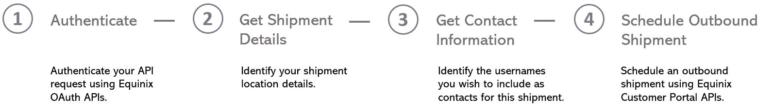

Schedule an Outbound Shipment​
To schedule an Outbound Shipment, send a POST request to the /colocations/v2/orders/shipments endpoint. Use the "type": "OUTBOUND" parameter to specify that it is an Outbound Shipment, and provide the rest of the shipment details in the body of the request. An outbound shipment request minimally requires the shipment type, shipment date, associated cage, and carrier to be included. The other necessary information you need to pass in the outbound shipment request body depends on the following:
  • If your outbound shipment is from a cage linked to multiple accounts.
  • If the carrier delivering the shipment is from your organization, a listed carrier or an unlisted carrier. If your carrier is not DHL, FedEx, UPS, your carrier is unlisted.
  • If you require a shipping label to be printed by Equinix.
An outbound shipment from a cage associated with a single account that will be delivered by someone from your organization.
For this scenario, your outbound shipment is delivered to your cage linked to only one account by someone from your organization. The minimum required information for this scenario is passed in this sample request.
