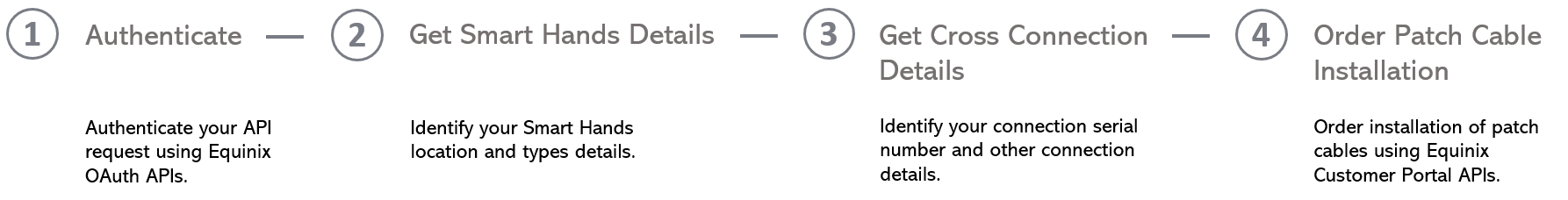

Prerequisites​
  1. Authenticate - Submit your user credentials, Client ID, and Client Secret for OAuth2 authentication. Refer to API Authentication for instructions on how to call the OAuth API to validate and authenticate your credentials.
  2. Retrieve the serial number of the Cross Connect - Send a POST request to the /v1/assets/search endpoint to search for the correct Cross Connect serial number. You may skip this step if you already have the serial number.
    If you cannot find the serial number of the cross connect, you should use "Serial # Not Found" as your serial number.
  3. To get Smart Hands details, you must have Smart Hands ordering permission.
  4. Get Smart Hands Types - Send a GET request to the /v1/orders/smarthands/types endpoint to get all Smart Hands order types. You may skip this step if you already know the Smart Hands order type.
  5. Get Location Information - Send a GET request to the /v1/orders/smarthands/locations endpoint to retrieve available IBX locations that you have access to. You may skip this step if you already know the location information.
