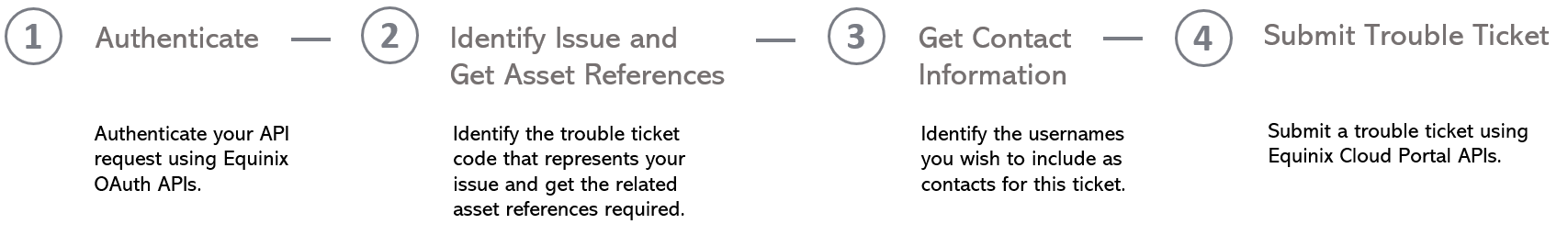

Four-step API workflow to authenticate, identify the issue and get asset references, get contact information, and submit a trouble ticket
