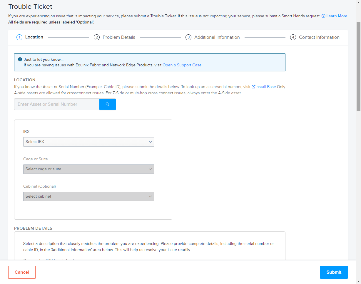

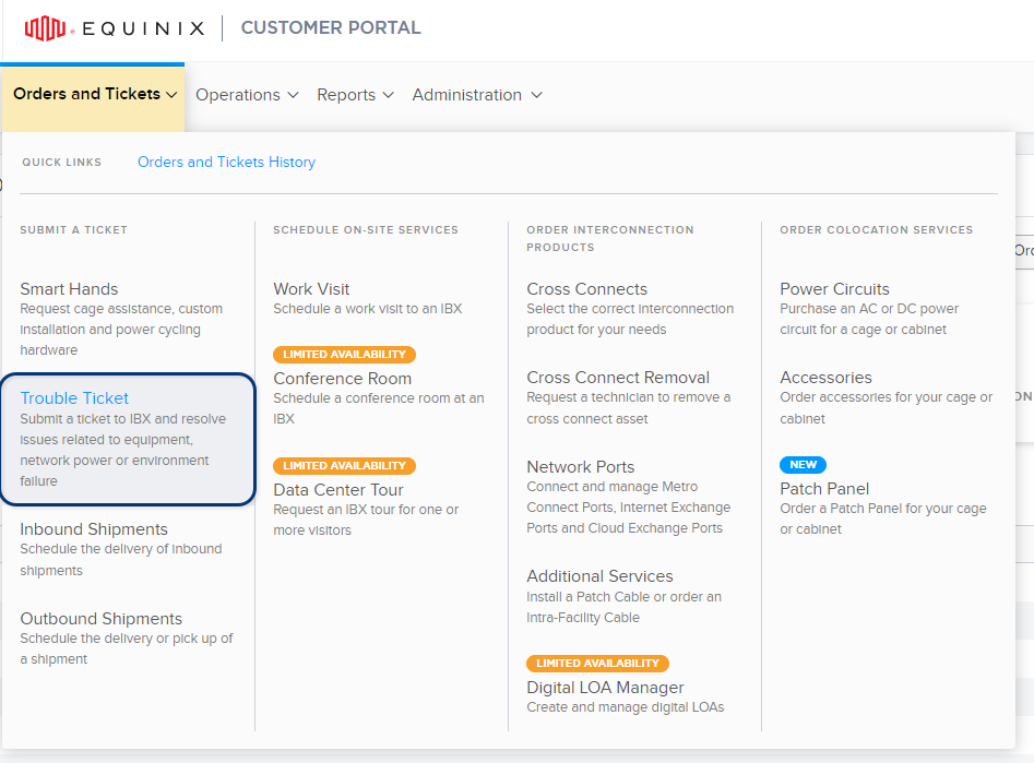

  1. From the Orders and Tickets menu in the Customer Portal, select Trouble Ticket.
  2. Select the location of the issue -- the IBX, the cage/suite, and optionally, the cabinet.
    Once you select a location, the screen displays the location details (including the street address, hours of operation, and a link to a map of the surrounding area).

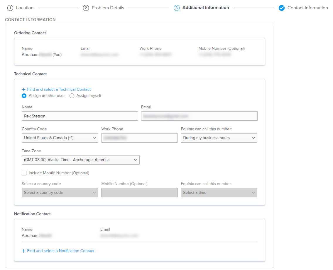

  6. Under Contact Information, specify a Technical Contact and at least one Notification Contact:
    Contact TypesDescription
    Technical ContactFor troubleshooting or clarification of the ticket. If questions arise, Equinix contacts this person.
    Notification ContactContact(s) who will receive email notices about the status (and pricing, if applicable) of the ticket.
    • The Technical Contact and the Notification Contact can be the same person.
    • You can select multiple Notification Contacts, but only one Technical Contact.
    • Technical contacts do not receive booking or completion notifications.
    • To remove a Notification Contact from the ticket, click X.

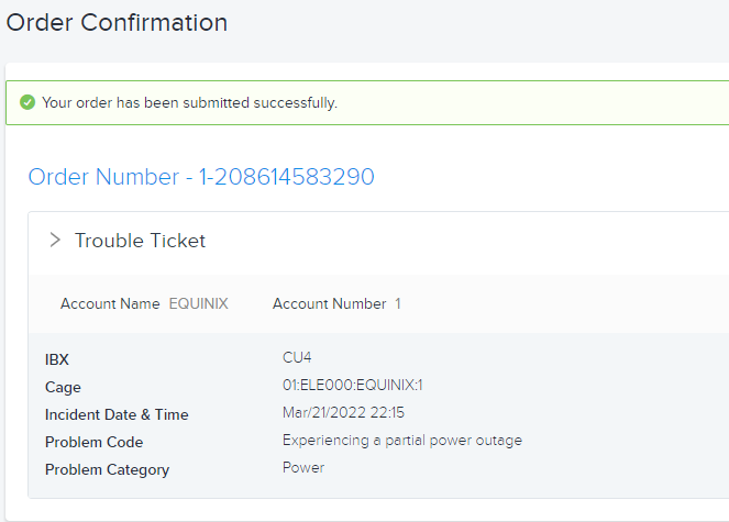

  7. Once all required fields are completed, click Submit.
    If your ticket was submitted successfully, a notification is shown.
