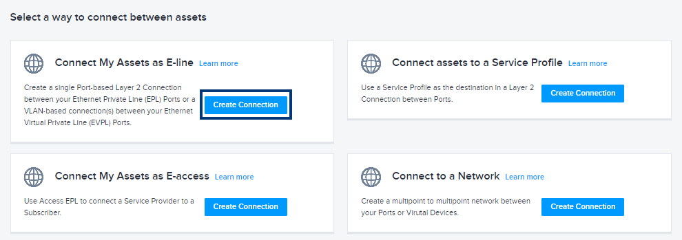

  4. No cartão Connect My Assets as E-line , clique em Create Connection.
