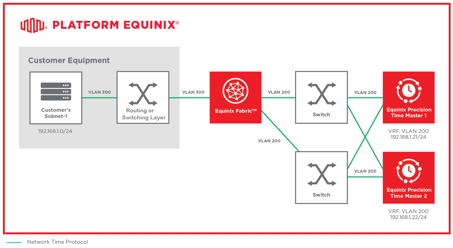

NTP network model with a single customer subnet connected through Equinix Fabric to two Precision Time masters

These examples show non-redundant network configurations for an NTP service with a single subnet on your side.
For a non-redundant configuration:
In this example, if you use subnet 192.168.1.0/24, you can use any IP for your end device within that subnet, excluding IP addresses 192.168.1.21/24 and 192.168.1.22/24 (the two IP addresses set on the time servers).
  1. Configure the end device that needs to be synchronized with an IP address that is within the same subnet range as the one configured for the time servers on the Equinix Customer portal.
  2. Ping the time server IP (here, either 192.168.1.21 or 192.168.1.22). The response should show the time server is under the same subnet that is configured for the interface of your end device (in this example, 192.168.1.0/24). Continue configuring your NTP client only if you get a successful Ping response.
  3. Configure both time server IP addresses (192.168.1.21 and 192.168.1.22 in this example) in the server section of the NTP client configuration file.
  4. Start your NTP client.

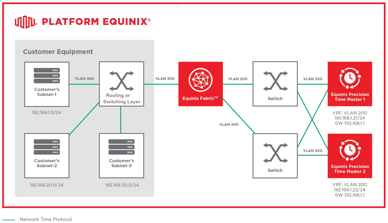

These examples show non-redundant network configurations for an NTP service with multiple subnets on your side.
NTP network model with multiple customer subnets connected through Equinix Fabric
info
When using NTP, Equinix Precision Time supports multiple subnets with only the Enterprise service tier; Precision Time does not support multiple subnets with NTP at the Standard service tier level.
  1. Provide Equinix with the configuration information for your gateway interface so that we can provision a new service connection in Equinix Customer portal.
    • The gateway interface must be within the subnet directly connected to the Equinix Precision Time service.
    • The gateway interface must be interconnected with other subnets.
  2. Configure the end device that needs to be synchronized with an IP address that is within the same subnet range as one of your configured subnets.
  3. Ping the time server IP (for example: 192.168.1.21 or 192.168.1.22). Continue to configure your NTP client only if you get a successful Ping response.
  4. Configure both time server IP addresses (here, 192.168.1.21 and 192.168.1.22) in the server section of the NTP client configuration file.
  5. Start your NTP client.

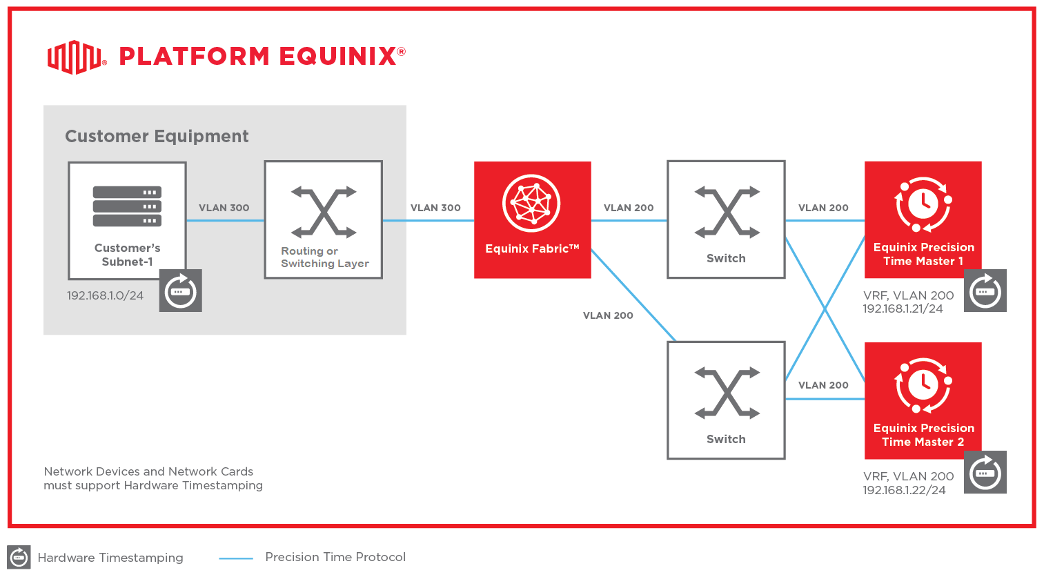

These examples show non-redundant network configurations for a PTP service with a single subnet on your side.
PTP network model with a single customer subnet connected through Equinix Fabric
  1. Ensure all devices in the integration have network interface cards that support hardware timestamping.
  2. Run ethtool -T <interface_name> to ensure the network interface supports IEEE 1588 PTP and the necessary hardware timestamping options.
  3. Configure the end device that needs to be synchronized with an IP address that is within the same subnet range as the one configured for the time servers on Equinix Customer portal. In this example, if you use subnet 192.168.1.0/24, you can use any IP for your end device within that subnet, excluding IP addresses 192.168.1.21/24 and 192.168.1.22/24 (the two IP addresses set on the time servers).
  4. Ping the time server IP (here, either 192.168.1.21 or 192.168.1.22). The response should show the time server is under the same subnet that is configured for the interface of your end device (192.168.1.0/24 in above diagram).
  5. If you get a successful Ping response, you may start your PTP client in multicast mode.
Because the client operates in multicast mode, a primary clock IP does not need to be specified. The client automatically discovers the time source within the subnet.
