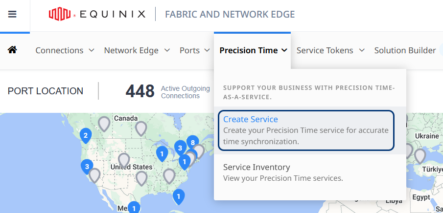

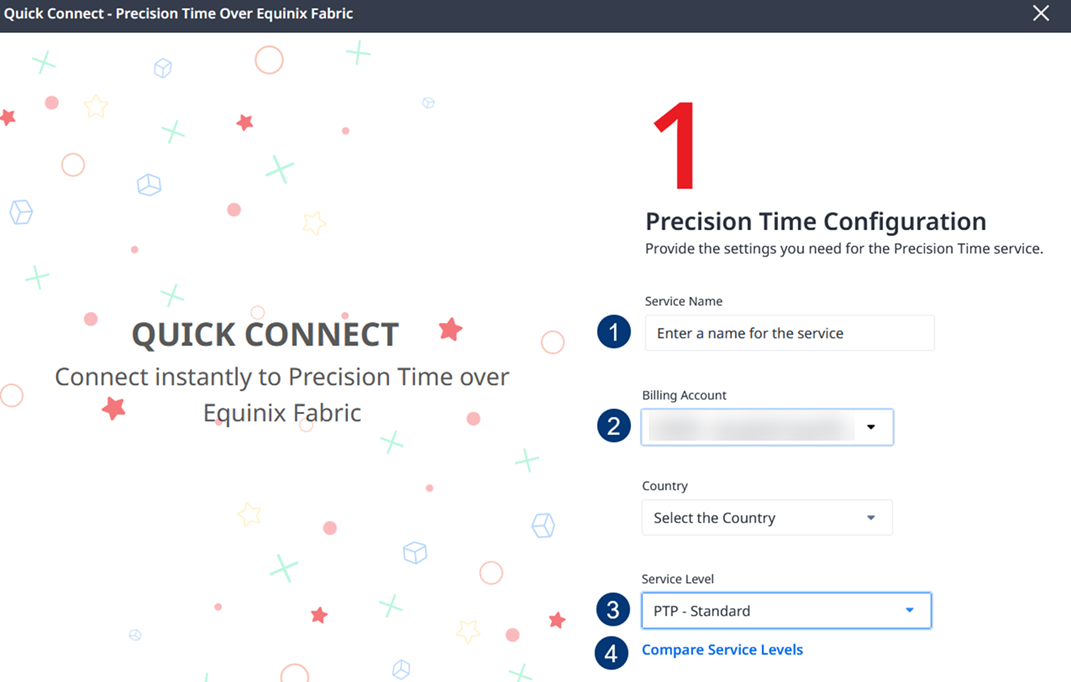

  1. Sign in to the Customer Portal and navigate to Fabric. Use the Project Selector to select the project to create your service in.

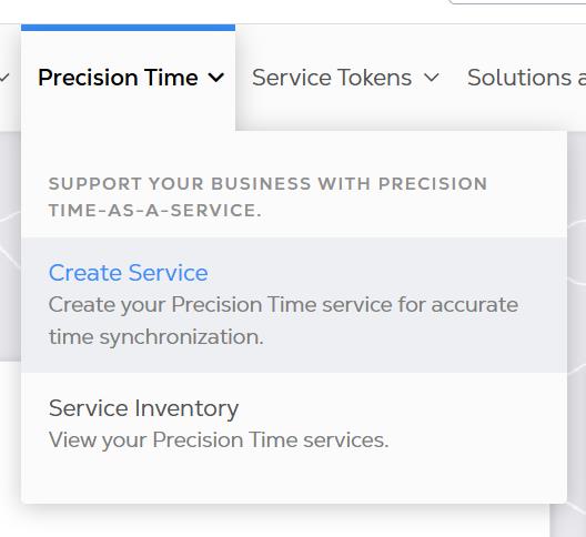

  2. From the Precision Time menu, click Create Service.
Precision Time Configuration

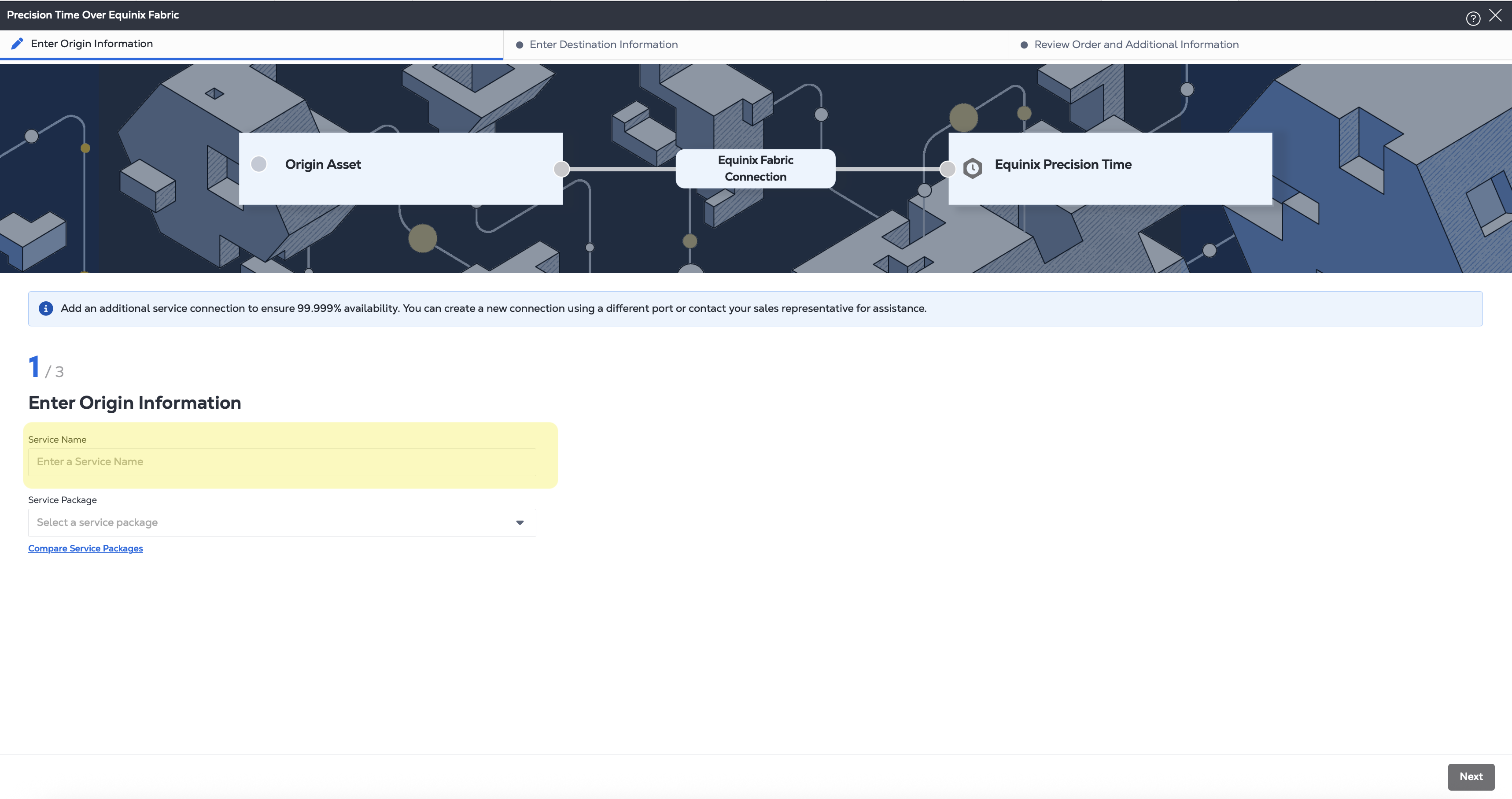

Origin Information

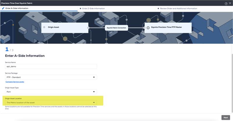

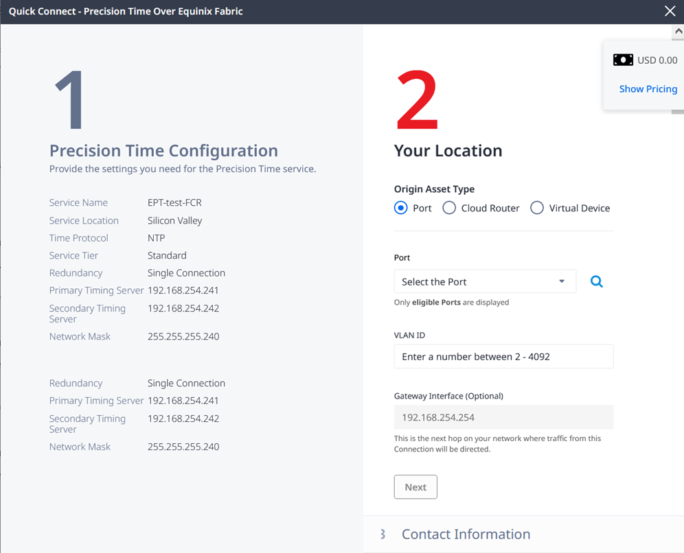

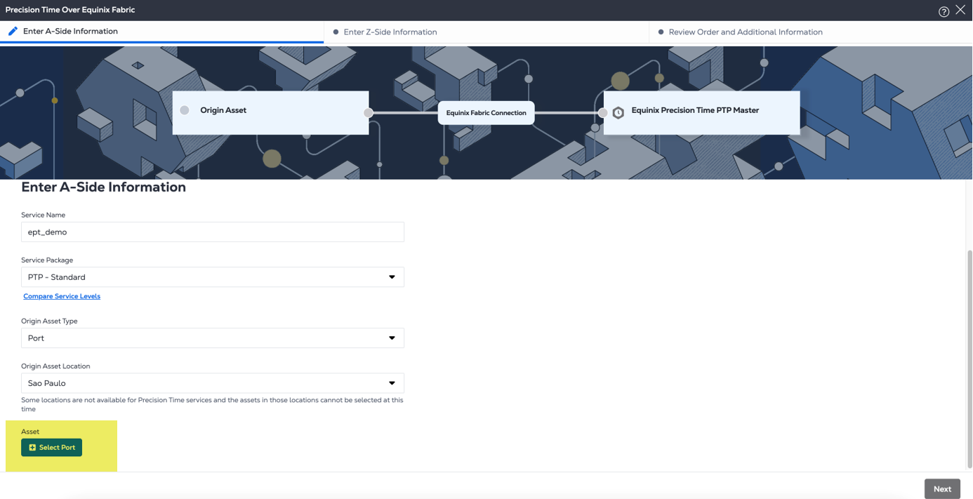

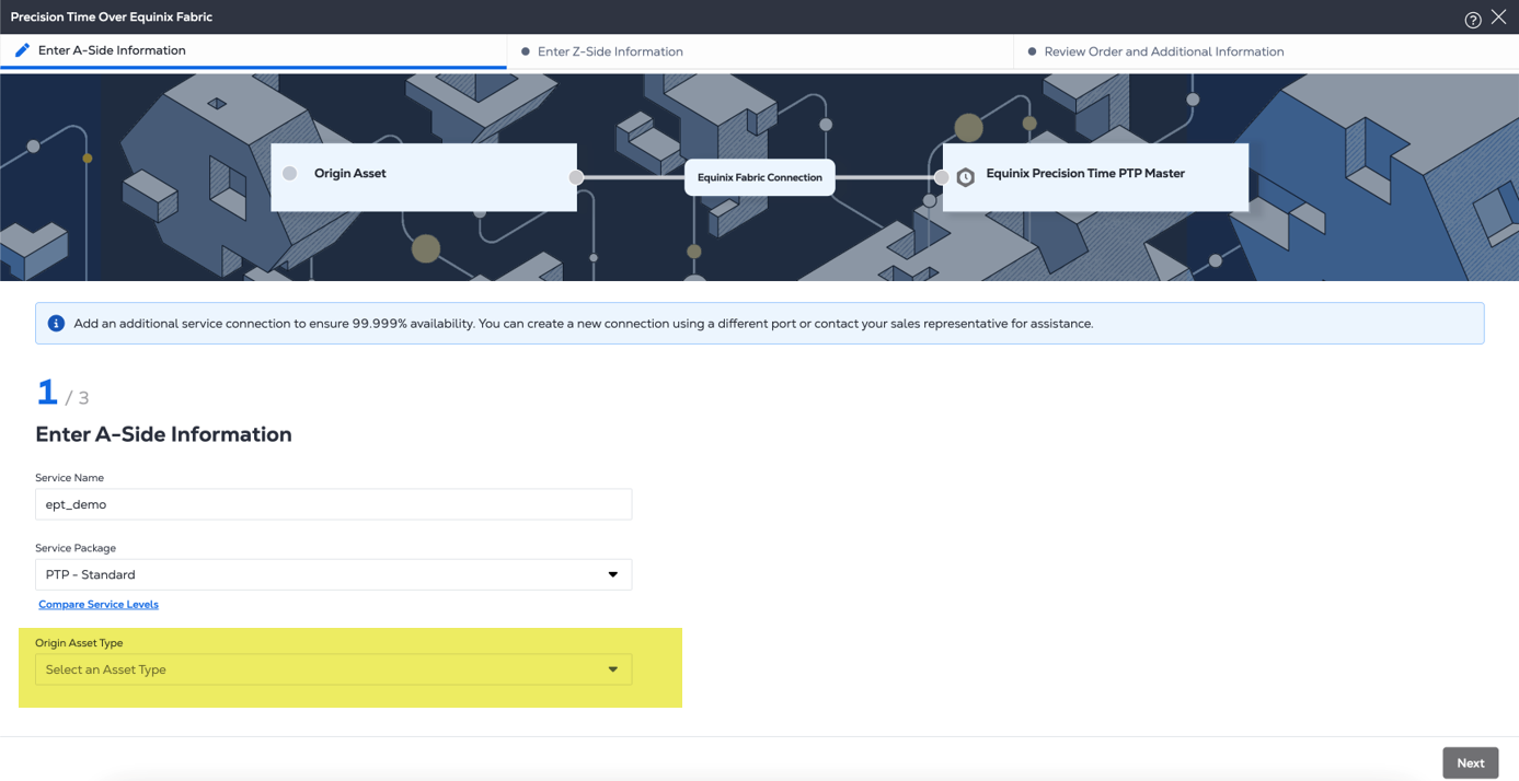

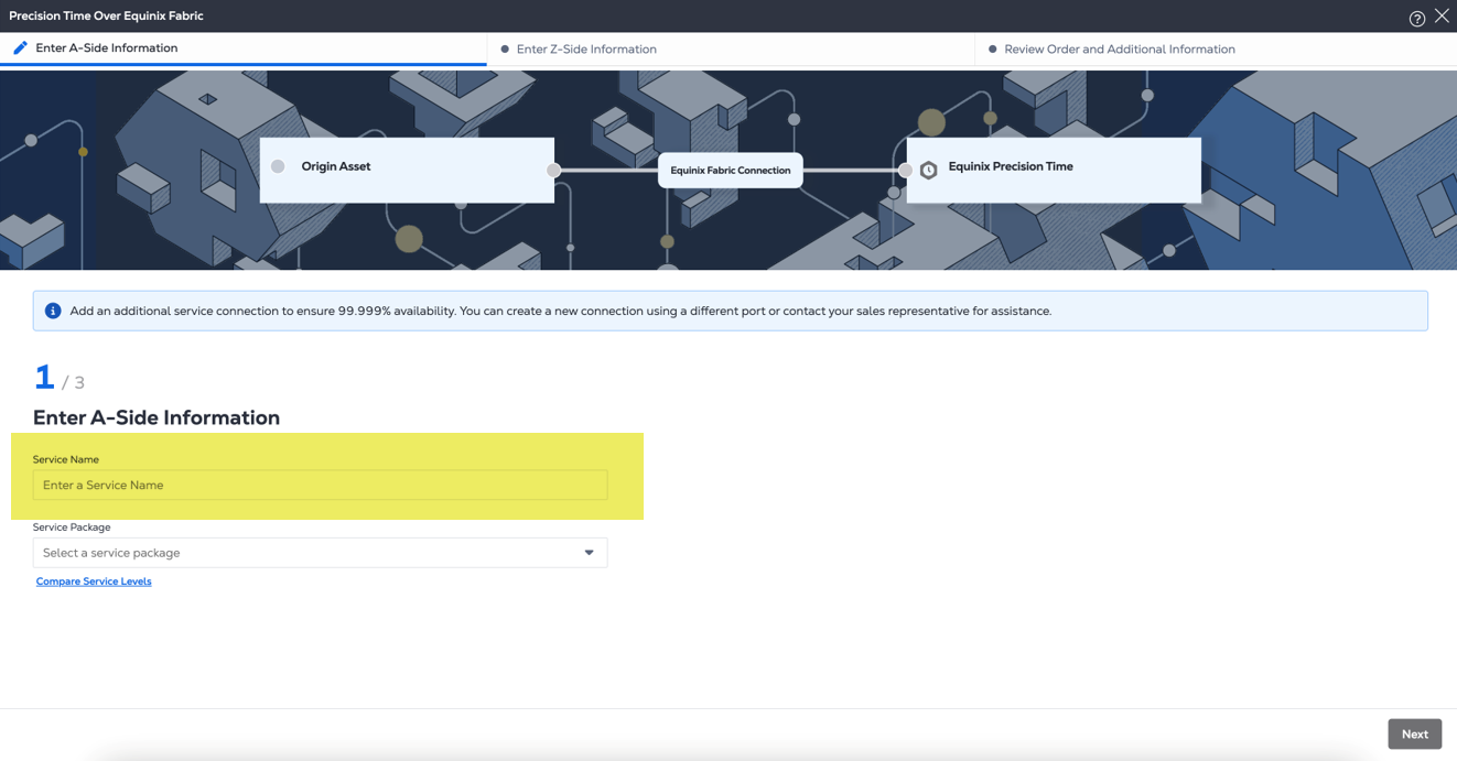

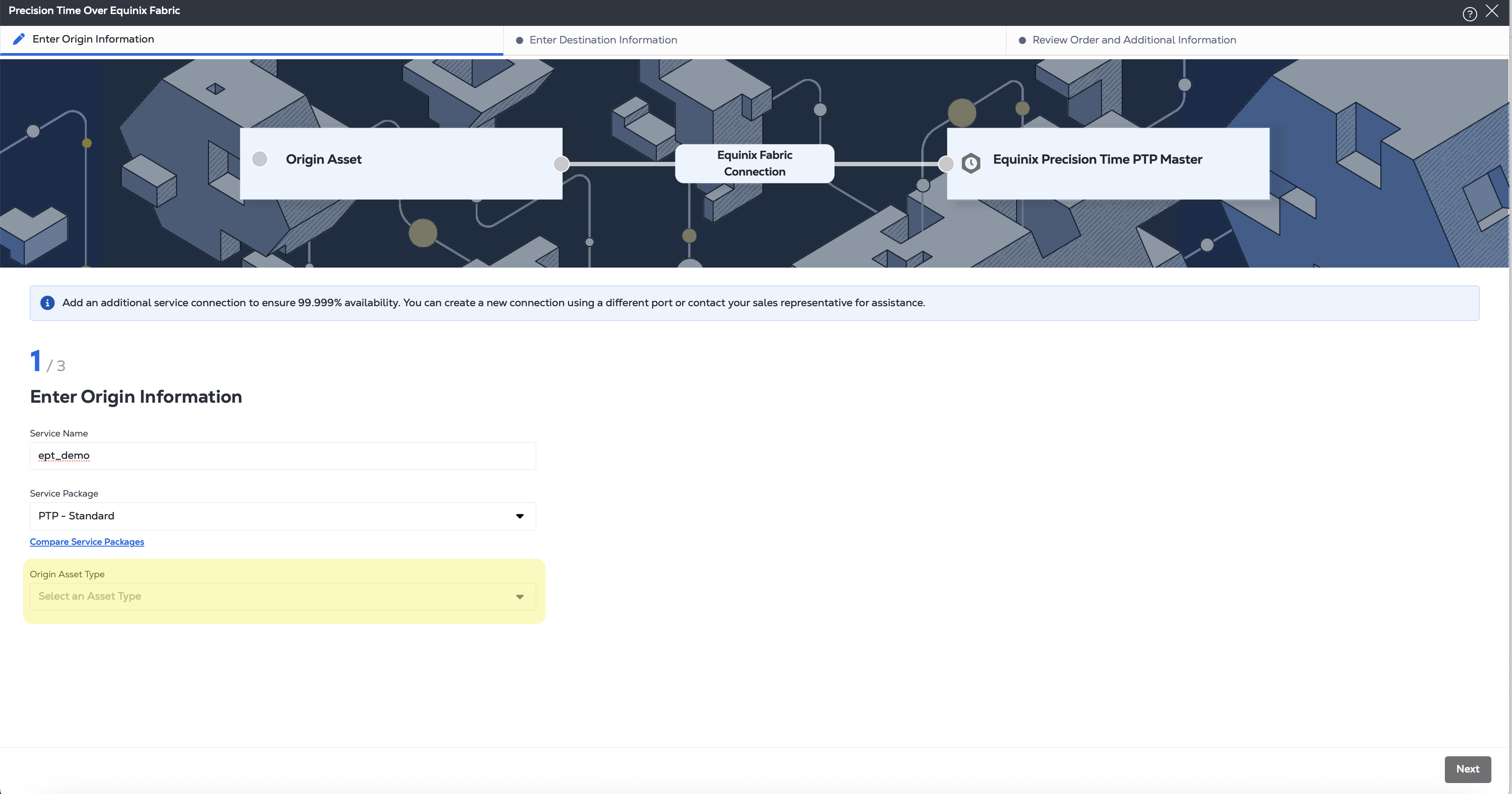

  1. In the Quick Connect screen, enter a Service Name.
  2. Select the Origin Asset Type.
  3. Select the Origin Asset Location.
    • For PTP packages, when you use Port assets, only eligible ports in metros with PTP service locations can be selected. The destination service location is automatically restricted to the same metro as the Origin Asset Location.

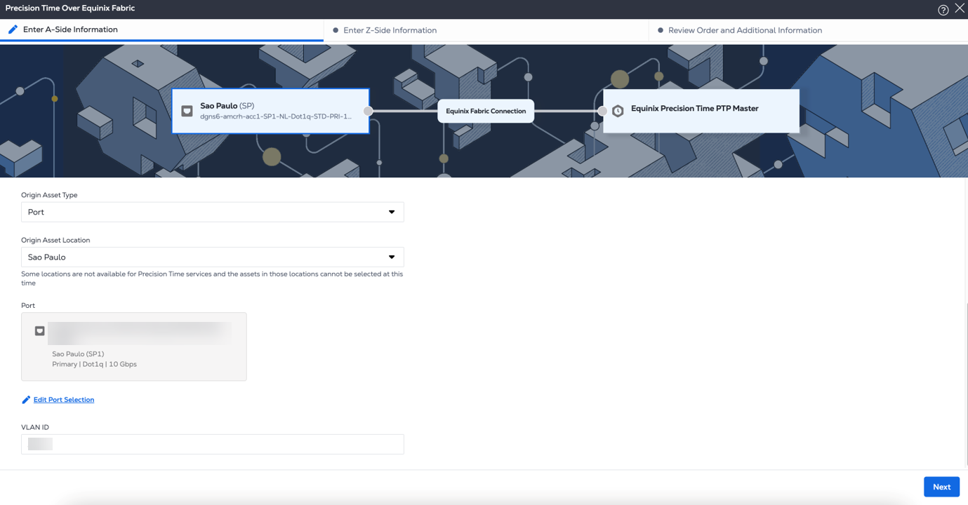

  4. Select an asset.
  5. Choose a VLAN.
  6. Click Next.

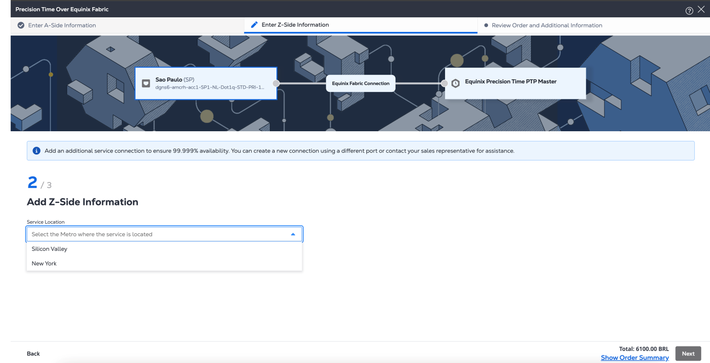

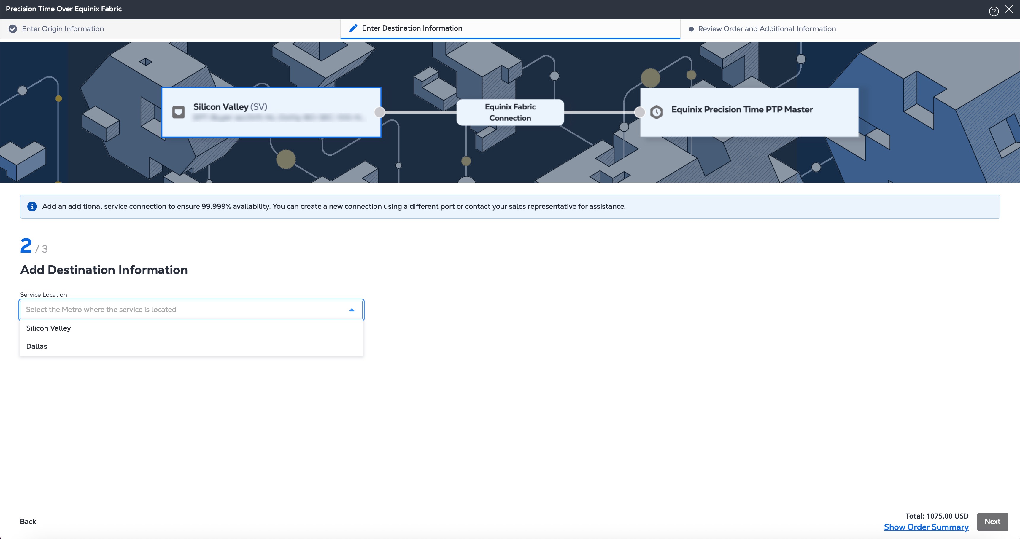

Destination Information

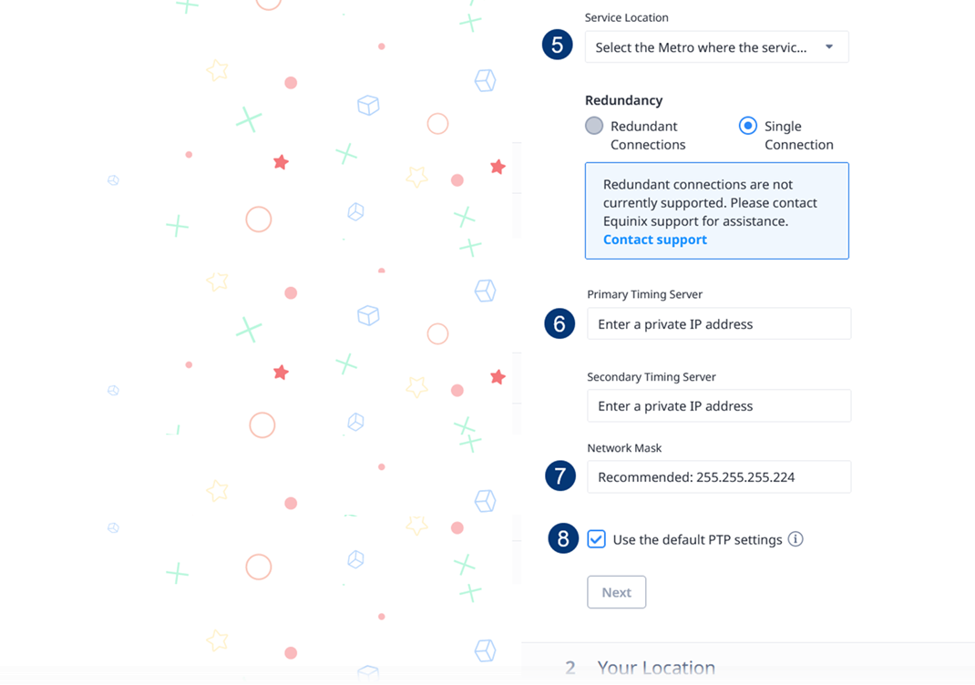

  1. Select the Destination Service Location.
    • For PTP packages, the service location is automatically restricted to the same metro as the Origin Asset Location.
  2. If needed, enter an IP address for the Primary Timing Server and the Secondary Timing Server.
    • The recommended values are provided.
    • If your new service is set up with the NTP Standard service tier, values for these fields are supplied.
  3. If needed, enter a Network Mask.
    • The recommended value is provided.
    • If your new service is set up with the NTP Standard service tier, the value for this field is supplied.

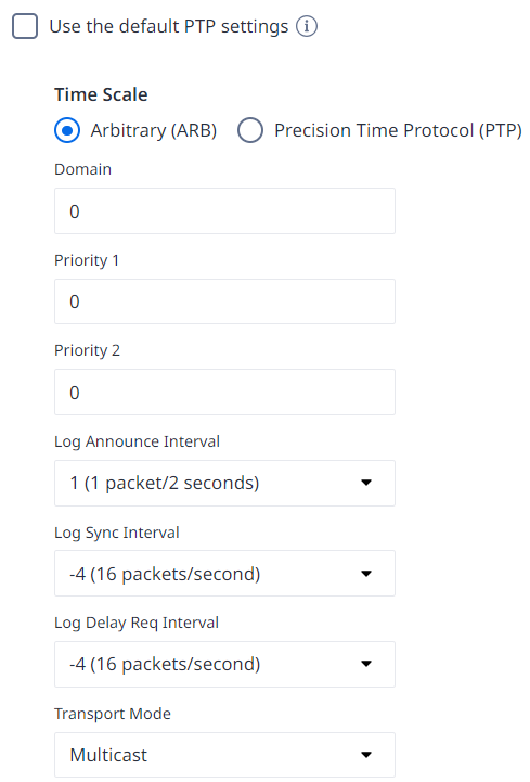

  4. For PTP services, default settings are applied automatically. To modify these values, deselect the Use the default PTP settings checkbox and enter the required information:
    • Time Scale:
      • ARB – Generates timestamps in UTC format with UTC offset as 0. (This is the default.)
      • PTP – Generates timestamps in TAI format with current UTC offset value.
    • Domain – Enter a PTP domain value for the time server. Any clocks that synchronize with this server should be configured with the same domain value. The range is 0 (the default) to 127.
    • Priority 1 and Priority 2 – Enter a value between 0-248. Lower values indicate a higher priority.
    • Log Announce Interval – Choose an option from the drop-down list. This logarithmic value controls the rate of PTP Announce packets from the PTP server. The default is 1, which indicates 1 packet every 2 seconds.
    • Log Sync Interval – Choose an option from the drop-down list. This logarithmic value controls the rate of PTP Sync packets. The default is -4, which indicates 16 packets every second.
    • Log Delay Req Interval – Choose an option from the drop-down list. This logarithmic value controls the rate of PTP DelayReq packets. This setting might also need to be specified on the PTP client. The default is -4, which indicates 16 packets every second.
    • Transport Mode – Choose Multicast (default), Unicast, or Hybrid. In the Unicast Grant Time field, enter the number of seconds from 30-7200.

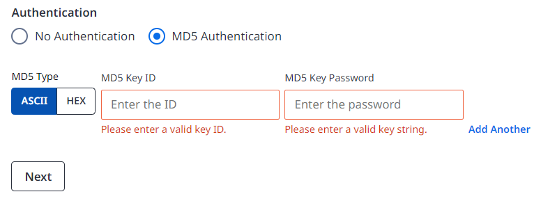

  1. For NTP Enterprise services, you can enable additional authentication. Select MD5 Authentication and enter the required information:
    • MD5 Type – Select the type of key string, ASCII or HEX.
    • MD5 Key Id – Enter the key ID. Integers from 1-65535 are valid.
    • MD5 Key Password – Enter a password that contains 10-40 characters. Click Add Another option to add up to 25 more keys.
      • For HEX passwords, only HEX characters 0-9 and A-F can be used.
      • For ASCII passwords, all ASCII characters can be used, including numbers, letters, and special characters.

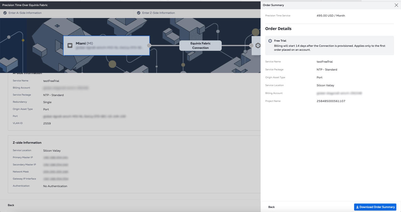

Trial Precision Time Service
Users can complete the entire ordering flow as usual and should see the trial banner at the end. No additional steps are required to enable the trial, provided your account meets the standard Precision Time Prerequisites. Billing begins 14 days after the Connection is provisioned. The trial applies only to the first order placed on an account.

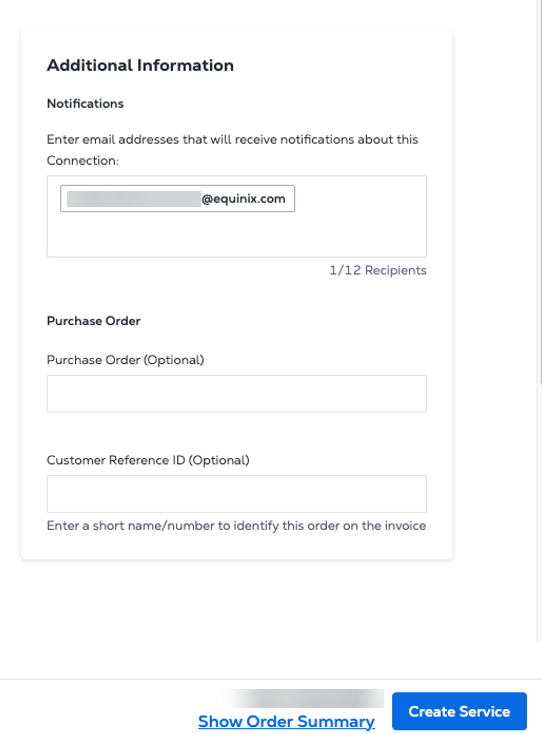

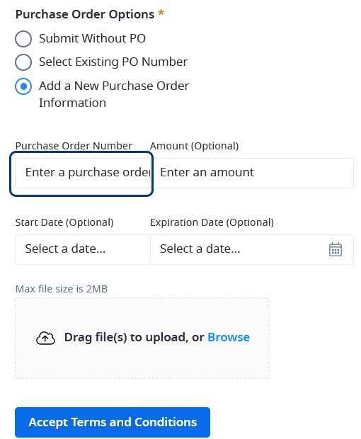

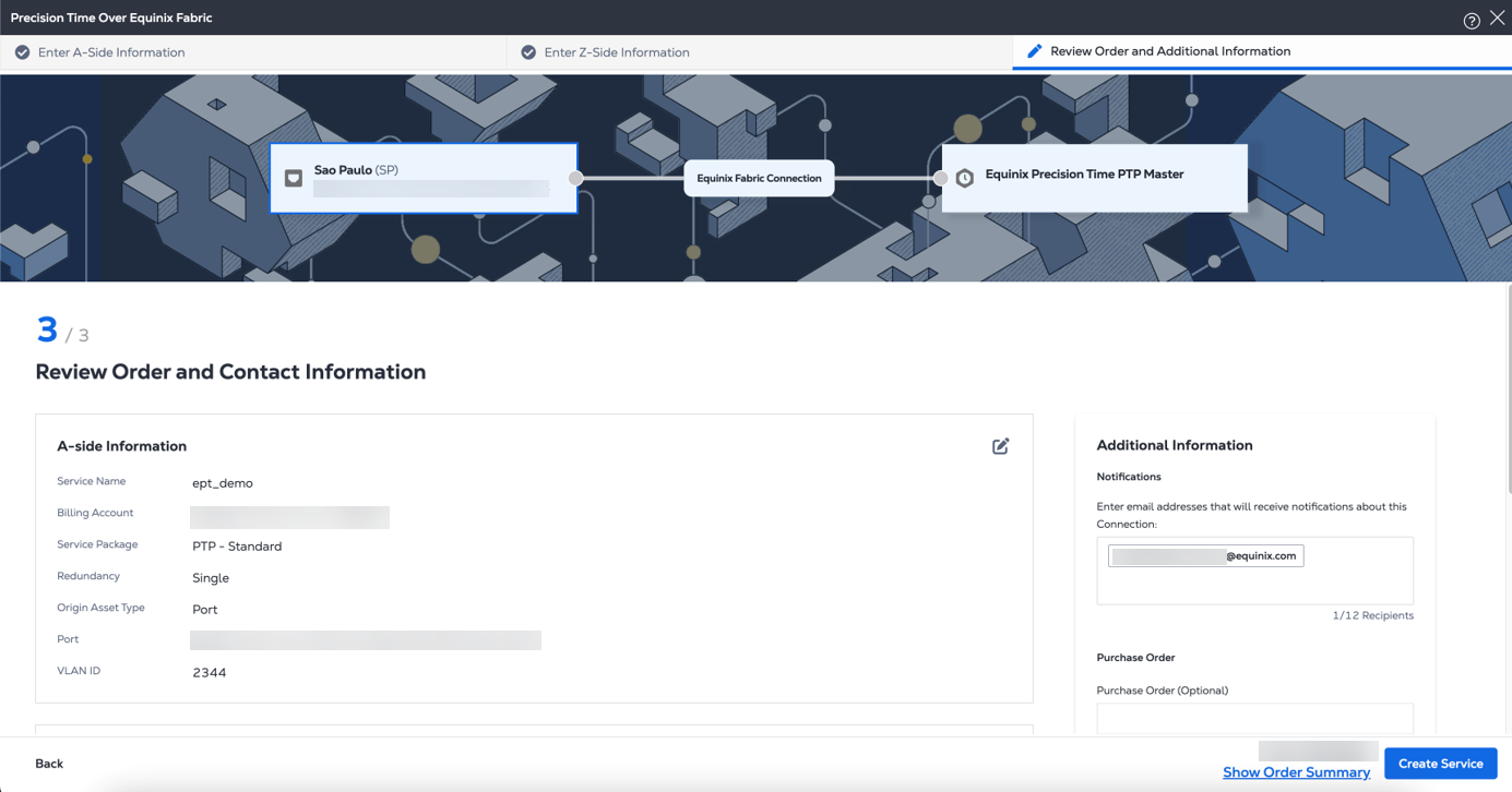

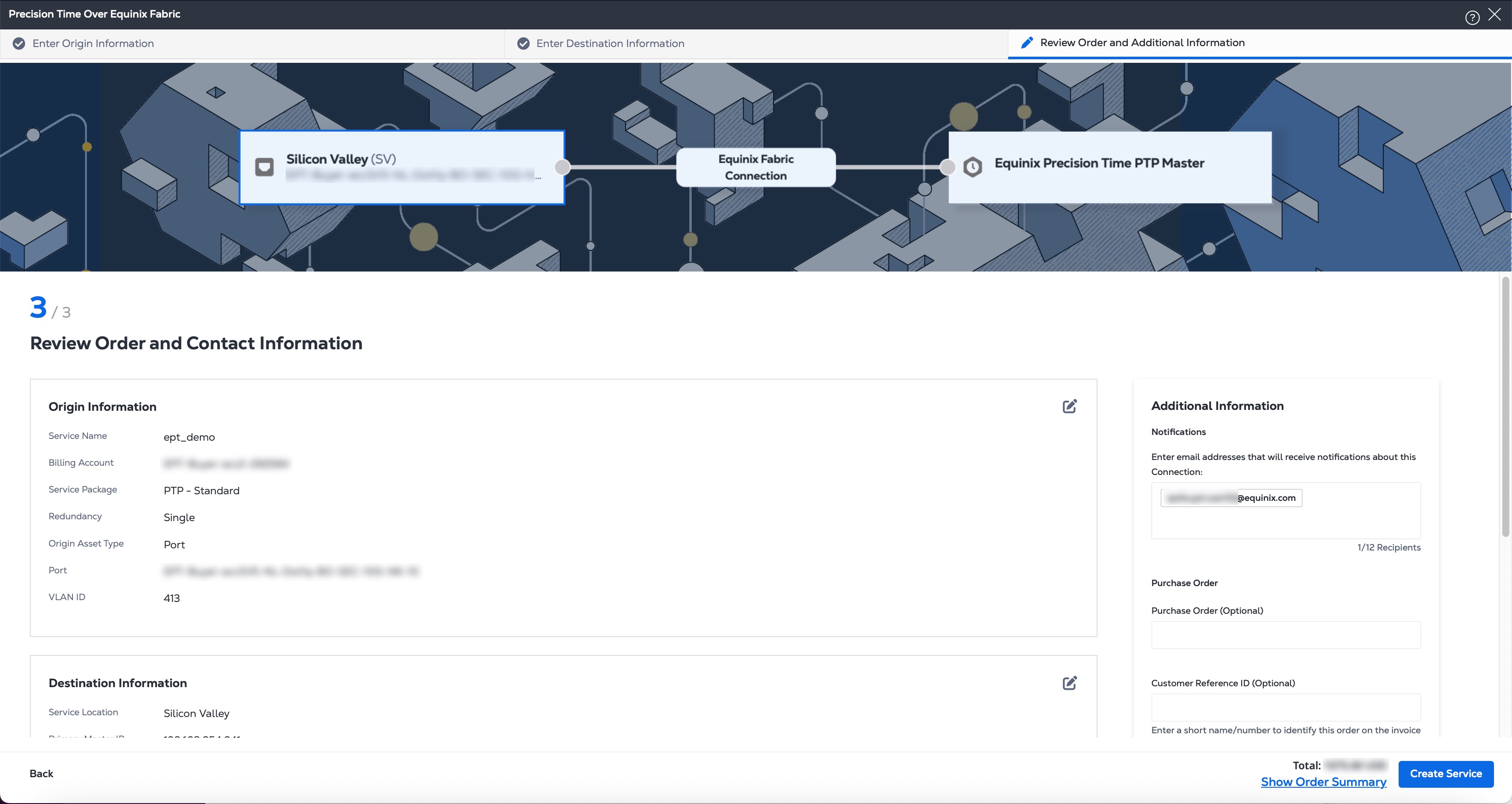

Contact Information, Terms and Conditions
In the Additional Information prompt, the email address associated with your account is displayed in the Notifications field.
  1. Enter additional email addresses for anyone who should receive notifications.
  2. (Optional) Enter the Purchase Order number.
  3. (Optional) Enter the Customer Reference ID.

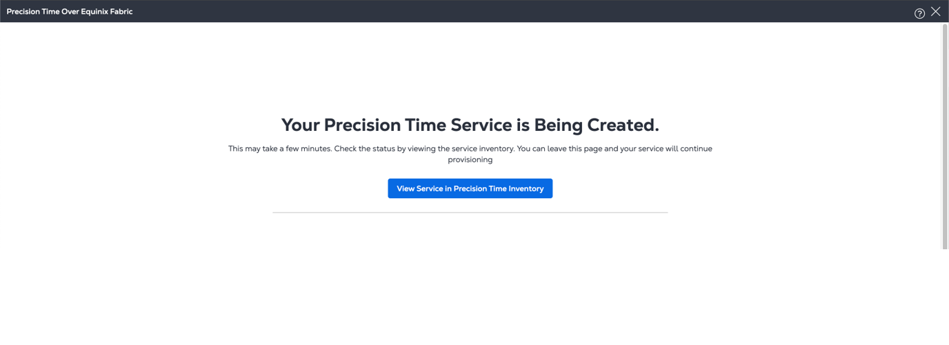

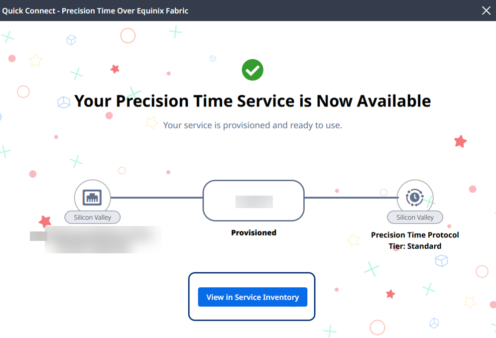

  4. Click Create Service. Your browser displays a confirmation message with the provisioning status.
Next Steps
You can view your new service in the dashboard. To display the Equinix Precision Time dashboard, click View Service in Precision Time Inventory.
