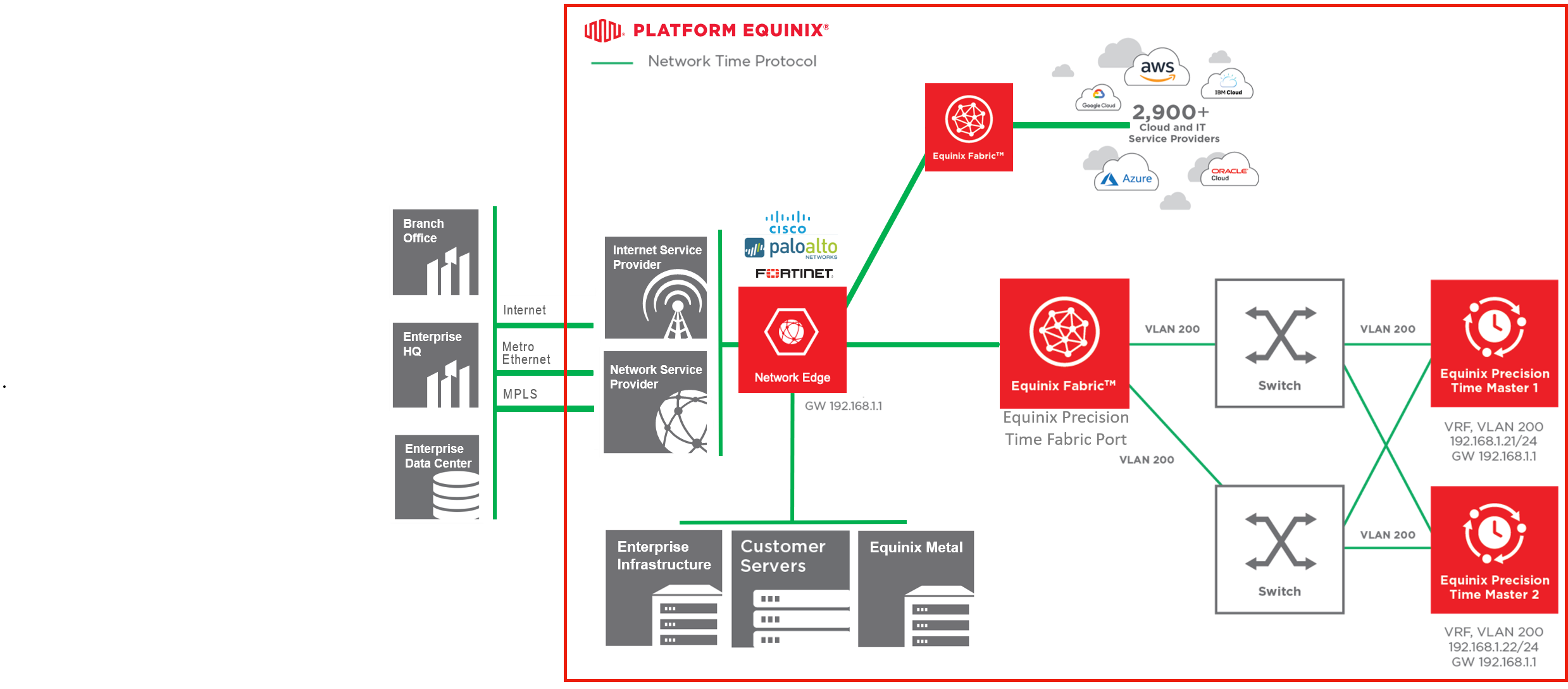

This diagram shows an Equinix Precision Time configuration that uses a Network Edge firewall or router as the timing Gateway. The customer side connects over Equinix Fabric.
Network Edge firewall or router as the timing gateway between the customer network and Precision Time

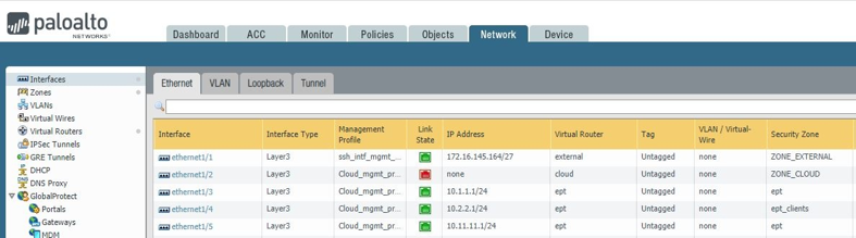

  1. In the Palo Alto interface, go to Network > Interfaces. Select the interface that you want to configure.
  2. Select Interface Type > Layer3.
  3. In the IP section, add your IP address and assign it as the gateway for your timing network.
    Palo Alto network interfaces list with Layer3 interfaces and IP addresses

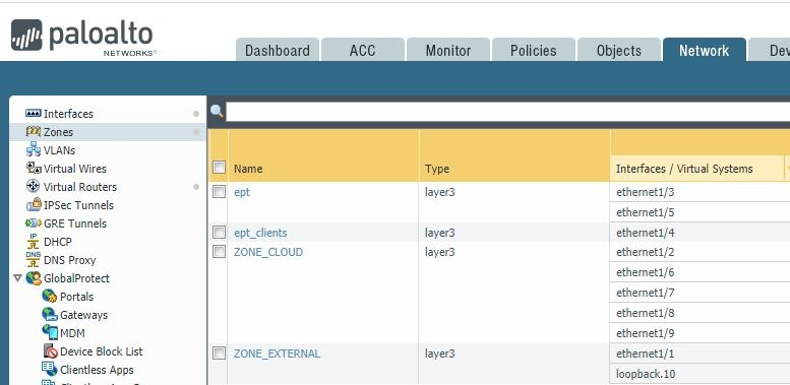

  4. Configure the Palo Alto zones by navigating to Config > New Zone > Security Zone > define a name. Click Ok.
    Palo Alto zones list with the ept and ept_clients zones

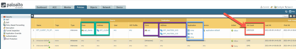

  5. Create a policy for access from the client to the timing server.
  6. Provide access to ICMP packets and NTP service for the EPT client from the EPT_CLIENT zone to the timing servers in the ept (timing server's) zone.
    Palo Alto security policy allowing ICMP, NTP, and ping from the ept_clients zone to the ept zone

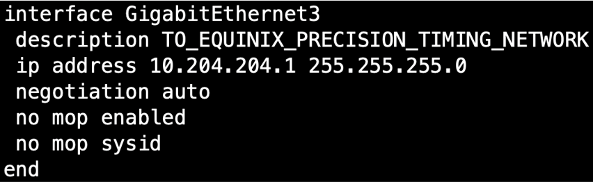

  1. Assign the gateway IP address from your Precision Time connection to the respective interface on the Network Edge virtual router.
    GigabitEthernet3 interface configuration with the timing network IP address

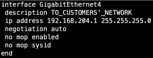

  4. Configure the LAN-facing interface of the NE routers towards your network.
    LAN-facing interface configuration toward the customer network
