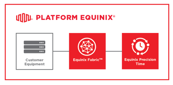

Precision Time sources time from redundant GNSS (GPS) receivers with antennas located within the Equinix IBX infrastructure. The time source servers distribute accurate time over Equinix Fabric.
Customer equipment connected to Equinix Precision Time through Equinix Fabric
