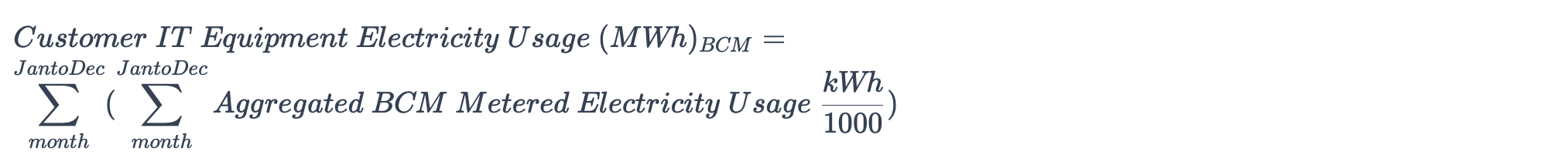

Customer IT equipment electricity usage data utilized by the Sustainability Tool is collected through Branch Circuit Monitoring (BCM) power metering where available. BCM data is metered at the circuit level and aggregated into monthly, cage-level totals for use in the Sustainability Tool. For the small number of sites that are not BCM-enabled and any other instances in which no metered power usage is available for a given cage, monthly IT usage is estimated.

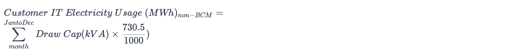

BCM versus non-BCM IT usage calculations are determined as follows:
  • If all BCM data is available for the reporting period, IT usage is calculated using metered BCM data.
A mix of BCM metered data and estimates based on draw cap is used to estimate monthly cage-level usage when one or more days in the month have BCM data but one or more days are missing BCM data.
If BCM for the reporting period is incomplete due to missing or inaccurate monthly totals, the following steps are taken to estimate monthly totals:
  • If BCM data exists for the months surrounding the month with no BCM data, an average of the two surrounding months' usage is used for the missing month.
  • If data does not exist on either side of the missing month, but exists for the previous three months, an average of the previous three months' data is used for the missing monthly total.
  • If there are no available values for the previous three months, but there is an available value four months prior, this value is used for the missing monthly total.
  • If none of these options are available, the missing monthly total is estimated using customer draw cap.
Calculations for BCM IT electricity usage are as follows.

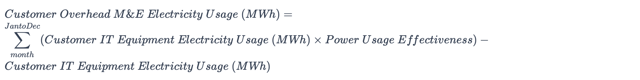

Customer Overhead M&E Usage​
M&E overhead electricity usage is allocated to each customer based on the intensity of their IT consumption relative to the site's total IT consumption. M&E consumption is calculated as follows, where Power Usage Effectiveness (PUE) is total site IT electricity consumption divided by total site electricity consumption.
In the Overview Dashboard, Scope 2 Dashboard, and Green Power Report, PUE values used in this calculation are derived from verified operational data. For Scope 2 Estimate Reports, PUE values are preliminary and subject to change as additional operational data becomes available.

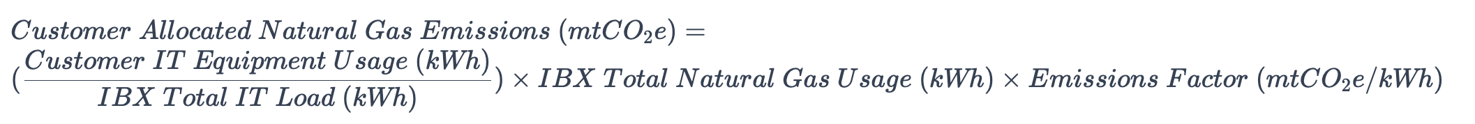

Scope 1 Emissions​
Scope 1 emissions are allocated to customers based on the intensity of their IT consumption relative to the site's total IT consumption. Relevant Scope 1 emissions sources include natural gas, generator consumption (diesel or hydrotreated vegetable oil fuel), and refrigerant leakage. Data can be displayed for a 12-month period, with generator and refrigerant emissions evenly distributed across each month for reporting purposes.
Not all sites will have nonzero values for emissions related to these three activities every year:
  • Not all sites use natural gas for heating. In the case where a customer does not have presence in sites where natural gas is used for heating, natural gas emissions will show as "N/A."
  • As generator consumption and refrigerant leakage are intermittent activities, "0" is an expected and valid value.

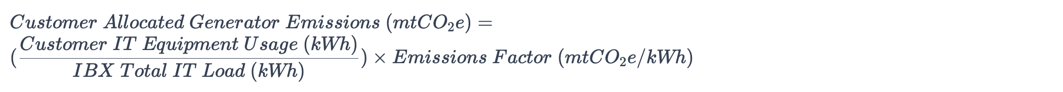

Generator Emissions​
Generator emissions occur when backup generators are utilized due to an outage onsite. Hydrotreated vegetable oil is relevant for Generator Consumption at MA5, PA4, and SK1; all other sites use diesel in their backup generators.

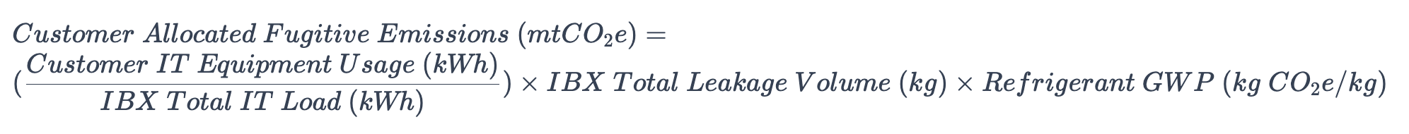

Fugitive Emissions​
Natural Gas Emissions​

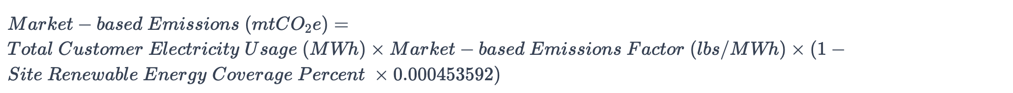

Scope 2 Emissions​

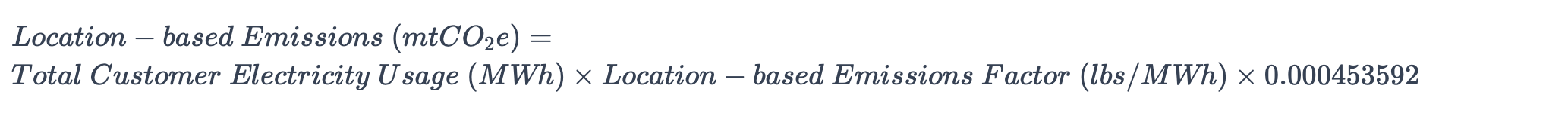

In the Overview Dashboard, Scope 2 Dashboard, and Green Power Report, location-based and market-based emissions factors are third-party verified. For Scope 2 Estimate Reports, these values are preliminary estimates based on the previous year’s emissions factors.
Location-Based Emissions​
Market-Based Emissions​

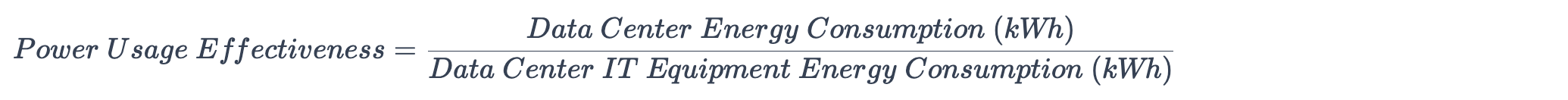

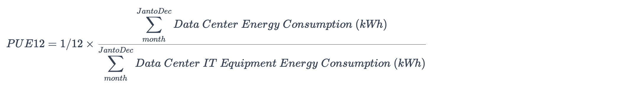

Power Usage Effectiveness​
The Sustainability Tool provides site-level, rolling 12-month Power Usage Effectiveness average (PUE12). PUE12 is available only for sites that have been operational for a full year. Equinix calculates Power Usage Effectiveness in accordance with Category 1 of the ISO/IEC 30134-2 standard.

Draw Cap Estimate of Customer IT Equipment Electricity Usage​
Conversion Factors​
ConversionConversion Factor
kVA to kWh730.5
kWh to MWh.001
kVA to kW1
