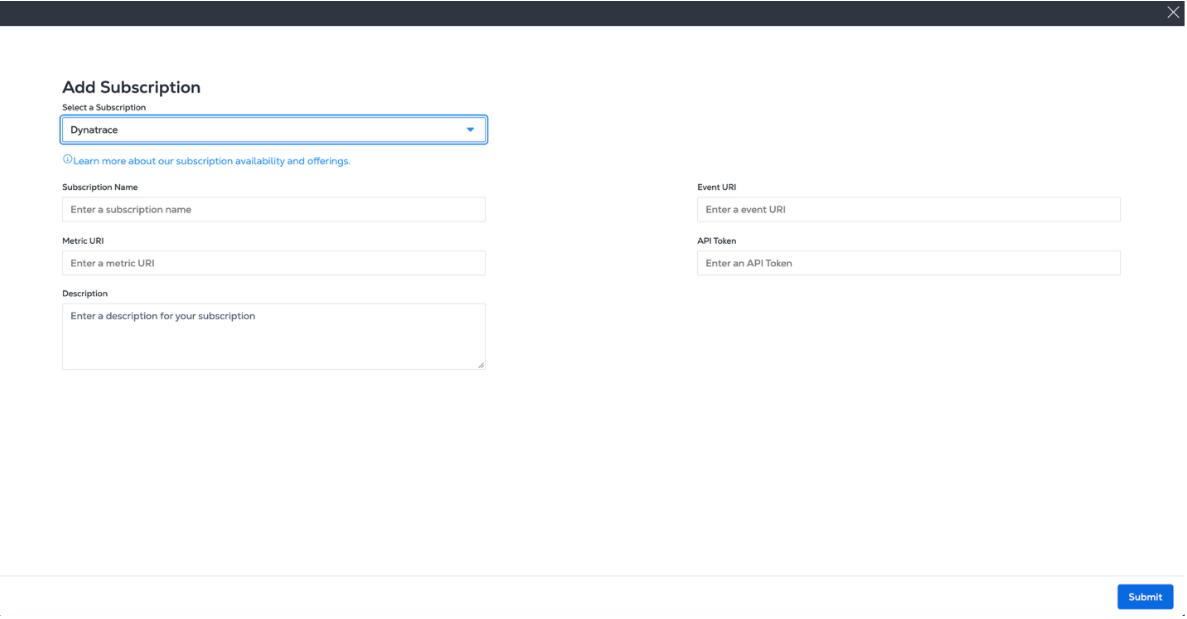

Dynatrace
To create a Dynatrace subscription, create an event index to receive events, a metrics index to receive metrics or both, then create an HTTP Event Collector.
- Portal
- API
On the Add Subscription page, enter your Dynatrace information, including:
- a Subscription Name
- your Dynatrace HTTP Event Collector URI
- your Dynatrace Access Token
- your Dynatrace Event Index (required)
- your Dynatrace Metrics Index, if you plan to ingest metrics into Splunk
- and provide a description (optional)
To create a subscription, send a POST request to the /fabric/v4/streams/<streamId>/subscriptions endpoint. Specify the Stream ID in the stream path of your request.
