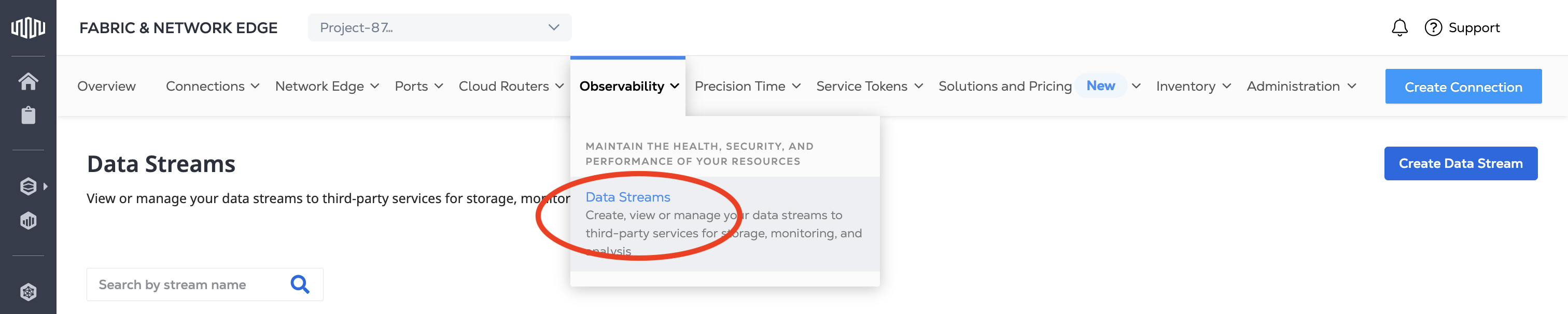

Log in to the Customer Portal > Fabric Dashboard.
From the Observability menu, select Data Streams.

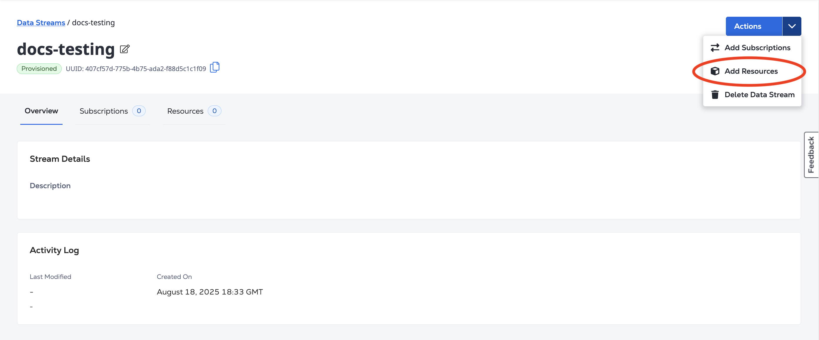

Click the Stream Name you want to add resources to.
From the Actions drop-down menu, select Add Resources.

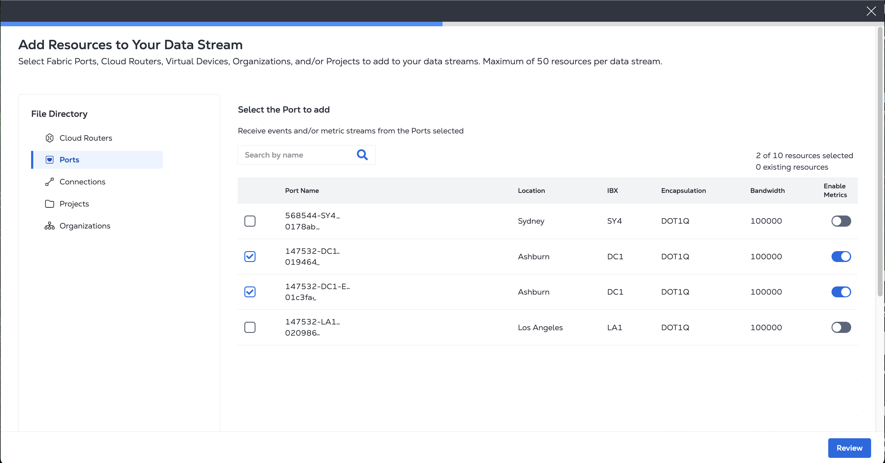

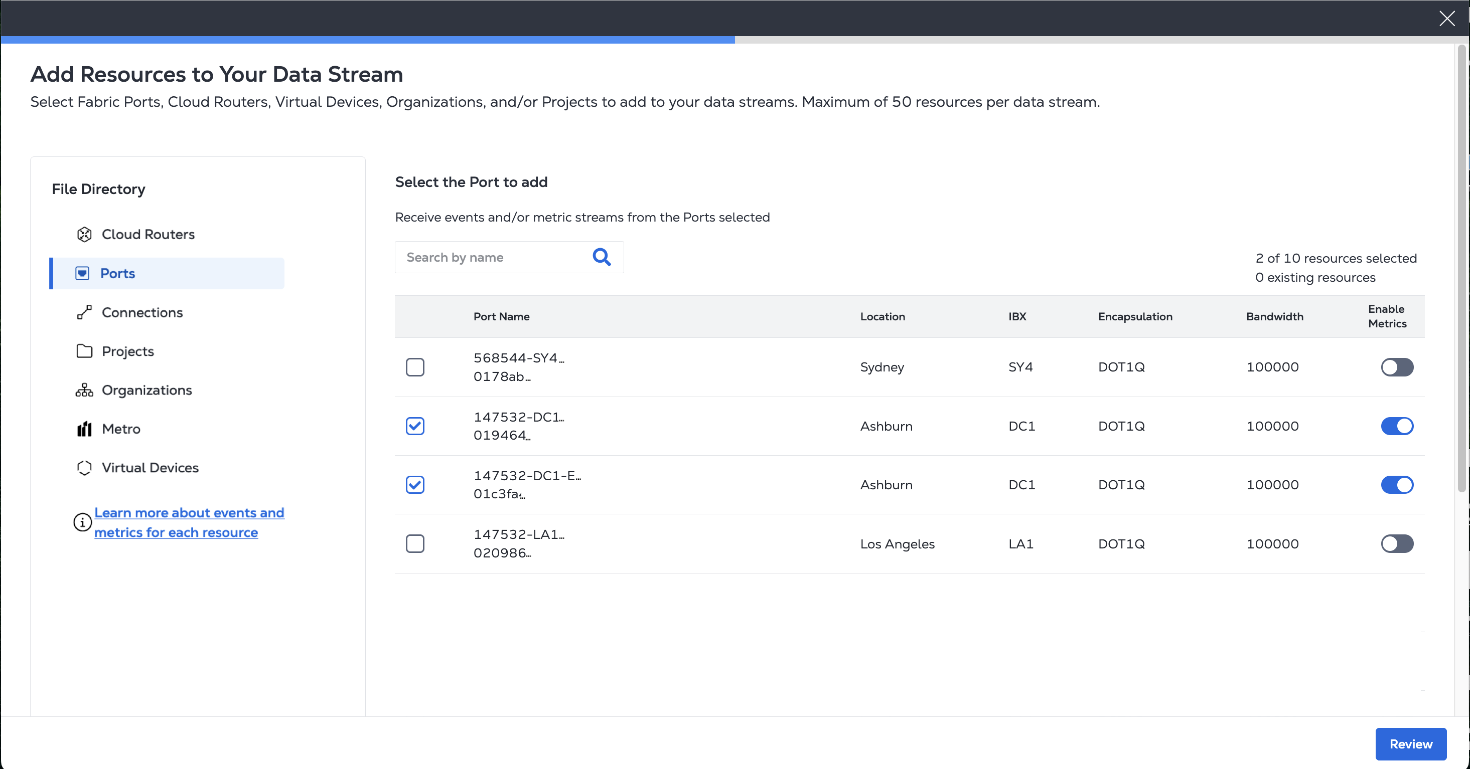

Use the File Directory menu to filter the available resource types.

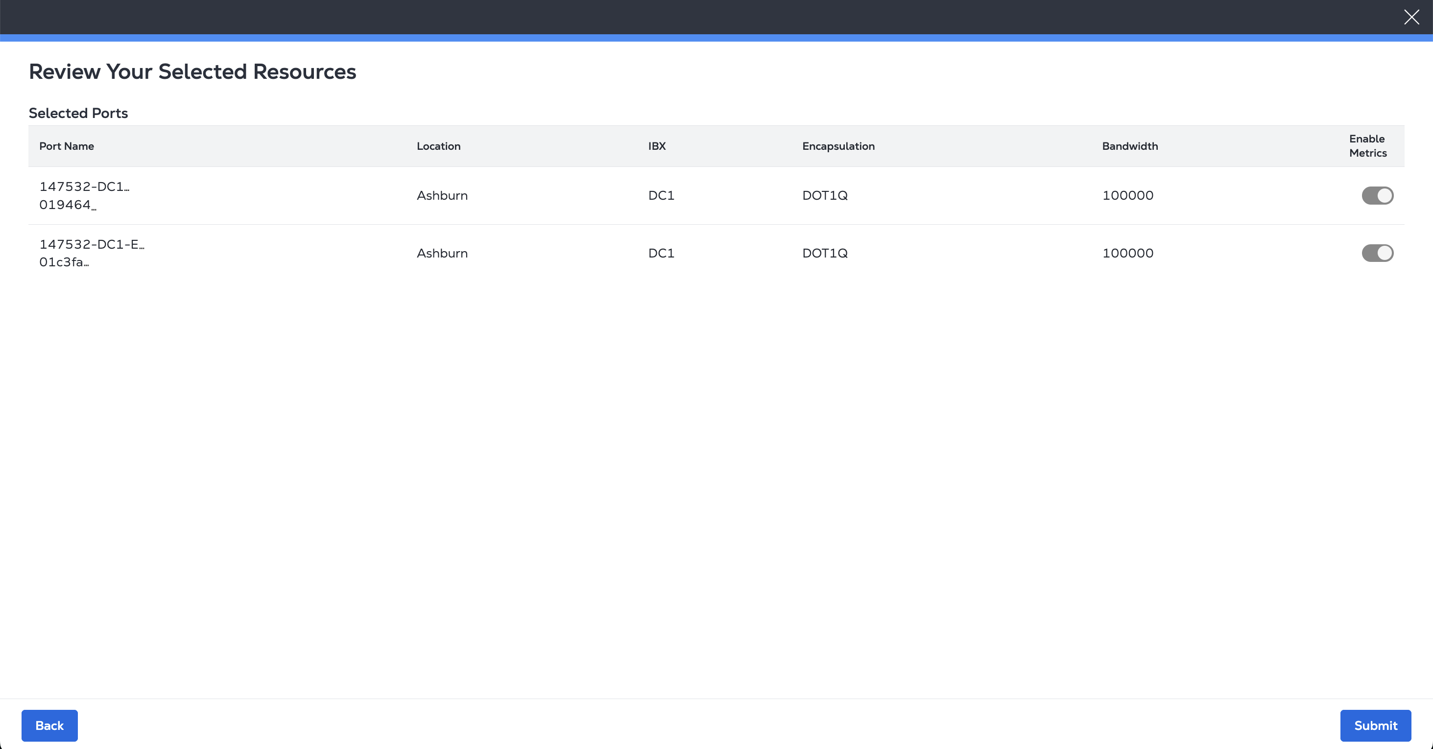

Select the specific resource or resources to add to the Stream. Added resources send event data and if you want to also send metrics, toggle Enable Metrics. Once you have selected your desired resources, click Review.
Review the list of assets to attach to the stream.
Click Submit.

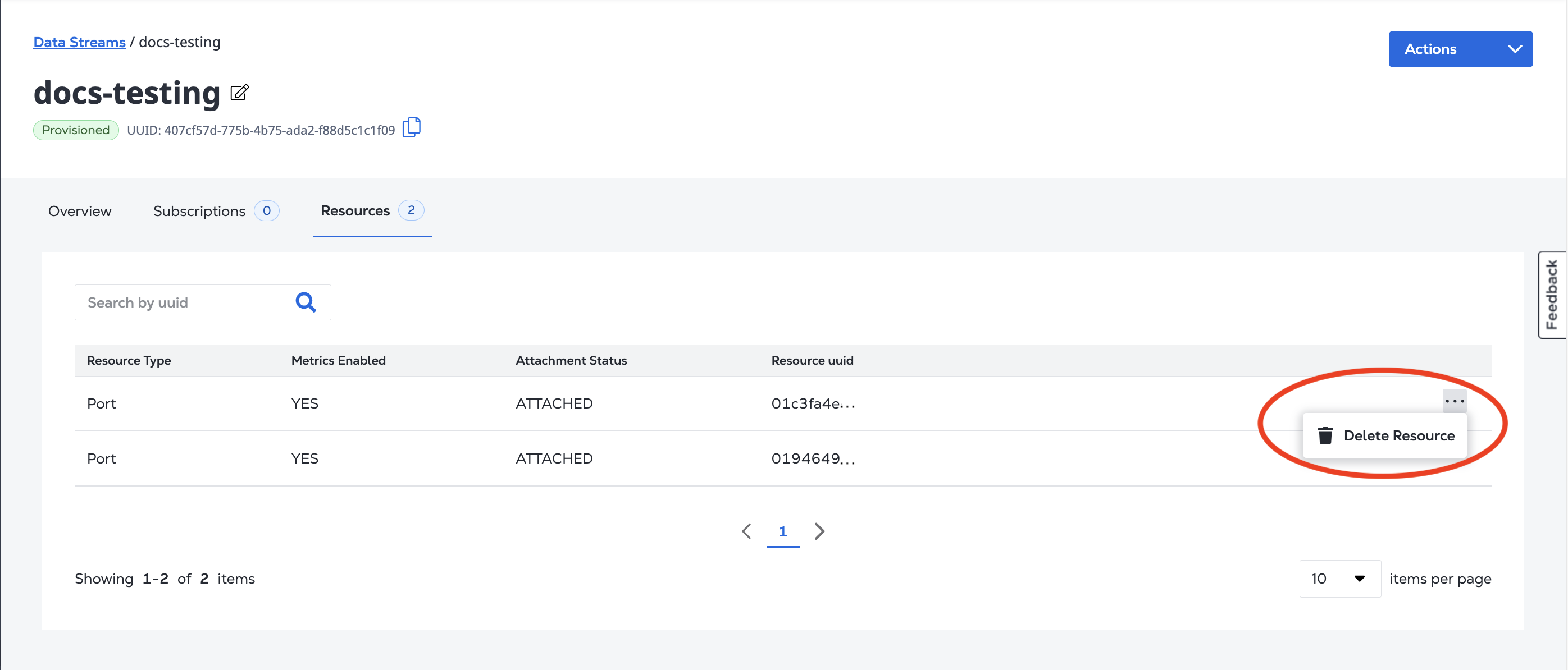

To delete a resource from a stream, select the stream from your Data Streams Inventory. From the Stream Details page, click Resources to view the Resource List.
From the resource's options menu, click Delete Resource.
