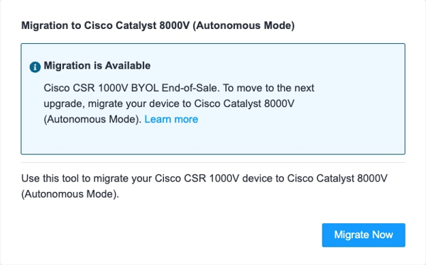

- Select the Cisco CSR1000V self-configured device you want to migrate. A banner will display indicating that Cisco CSR1000V BYOL is end of sale.
- Click the Tools tab.
- Click Migrate Now.

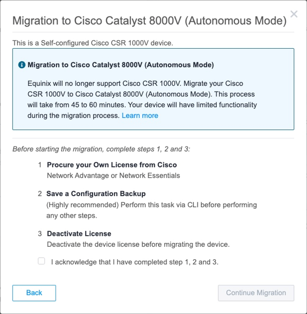

- Review and complete the steps:
- Procure your license from Cisco (either Network Advantage or Network Essentials).
- Save a configuration backup via CLI.
- Deactivate the old license.
- Select I acknowledge that I have completed steps 1, 2 and 3.
Click Continue Migration.

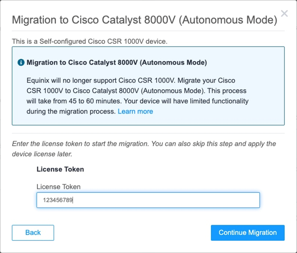

Enter your License Token and your Smart License Server URL. This step can be skipped, and your device license can be applied manually later.

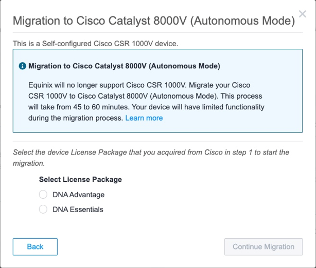

Select your License Package (DNA Advantage or DNA Essentials).

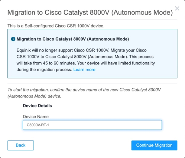

Confirm the hostname and device name of your Catalyst8000V router identified by the migration tool.
- Device name is an identifier used in the Network Edge portal.
- Host name is a name configured in your VNF configuration.
If you want to change those names after the migration, enter the device name and host name in the appropriate fields.

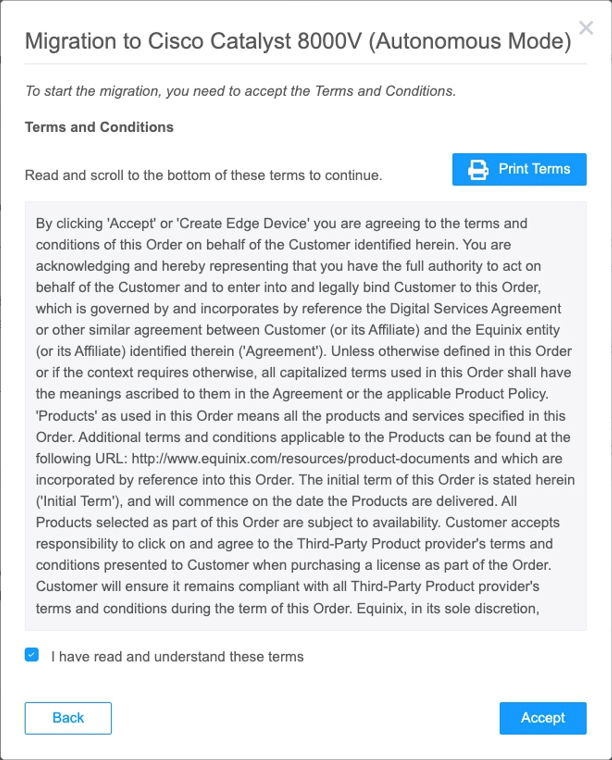

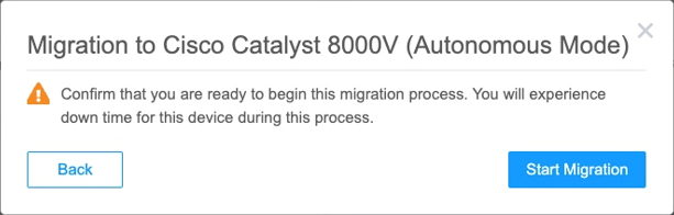

Review the Terms and Conditions. Select I have read and understand these terms and click Accept.
In the confirmation box, click Start Migration.

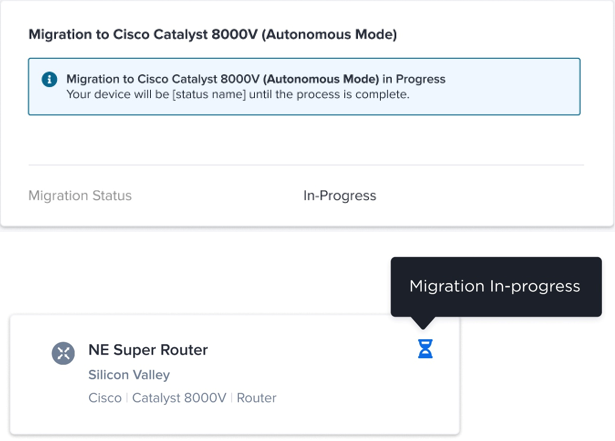

After the migration starts, the status in the Migration section changes to In-Progress. You will see an In-Progress status in the migration section. If you hover over to the device card on the top, the status changes to Migration In-Progress.
When the migration is successfully completed, the status icon on your device details page will change to Provisioned.

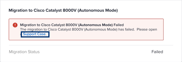

If the migration fails, a warning prompt will display. Click the Support Case link to open a support case.
