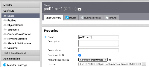

  1. Sign in to the VCO Orchestrator.
  2. Select Configure > Edge, select the Edge that needs to be reactivated.
  3. Click the Edge Overview tab.

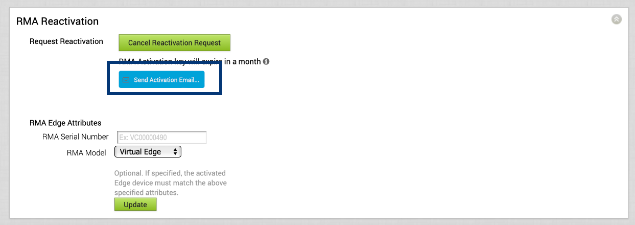

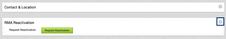

  4. Scroll to RMA Reactivation and click the arrows to expand the section.
  5. Click Request Reactivation. This step generates a new activation key and places the Edge status in Reactivation Pending mode.
    The reactivation key is only valid for one month from the time when the reactivation request was made

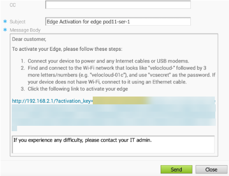

  6. Click Send Activation Email.
  7. In the email pop-up, click send to send the new activation key.
    The new activation key is included in the hyperlink provided in the email. The activation key is used during the recovery process in the Network Edge portal.

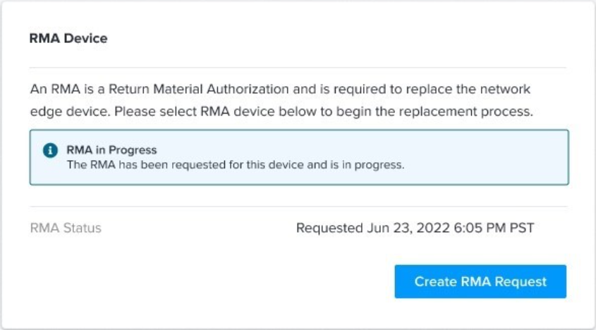

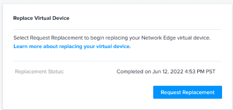

  5. In the Replace Virtual Device section, click Request Replacement.
  6. Enter the Activation Key obtained in the RMA process in the VMWare SD-WAN web interface, and click Request.

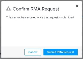

  7. Click Submit Request to confirm your request.
    warning
    This process can’t be canceled once the request is submitted.
  8. The device card will indicate that your request is in progress.
  9. The device status will indicate Provisioning. After the replacement process is done, the status changes to Completed with a timestamp. The Provisioning status changes to Provisioned. If any issues prevent the process from completing successfully, the status will indicate to Failed (displayed in red). If you see this failure status, please open a customer support case.
