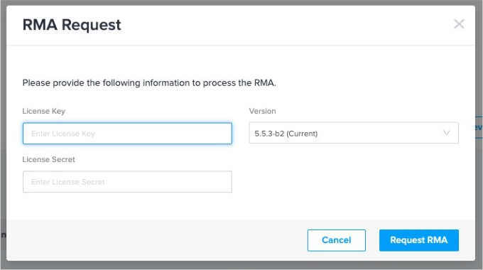

  6. Enter the License Key and License Secret obtained in the virtual device replacement process in the Palo Alto Networks Prisma SD-WAN web interface.
    RMA Request dialog with License Key, License Secret and version fields and a Request RMA button
  7. Click Submit to confirm your request.

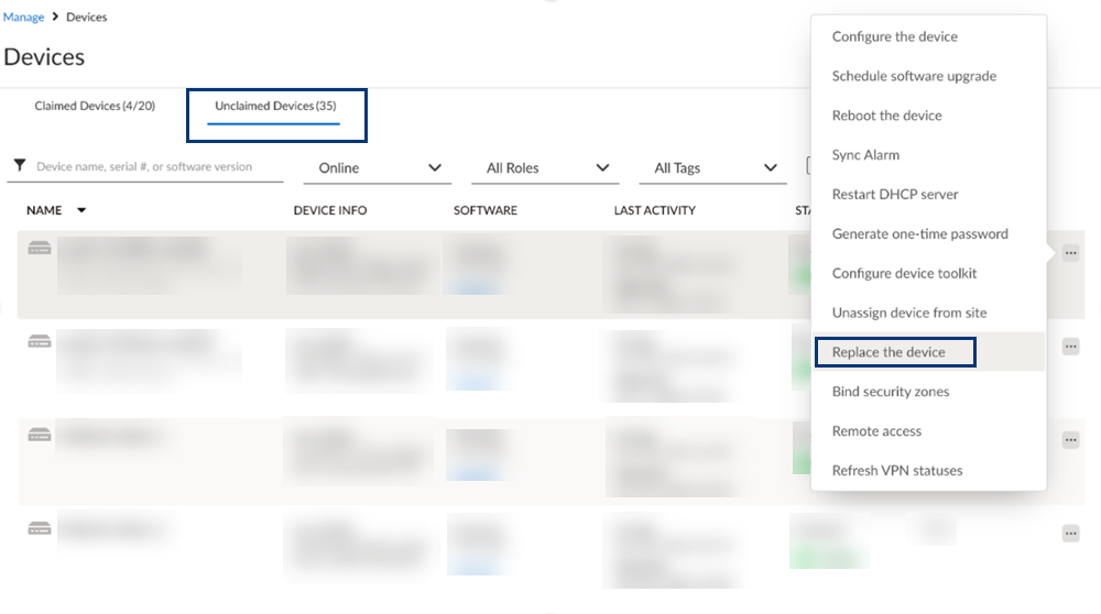

  2. Select Manage > Setup > Devices > Unclaimed Devices.
    Devices page with the Unclaimed Devices tab and the Replace the device menu option highlighted
  3. From the ellipsis menu, select Replace the Device.

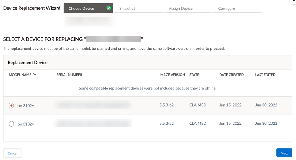

  4. Select a replacement device.
    Device Replacement Wizard Choose Device step listing compatible replacement devices with one selected
    There can be multiple replacement devices, so make sure you choose the correct one.

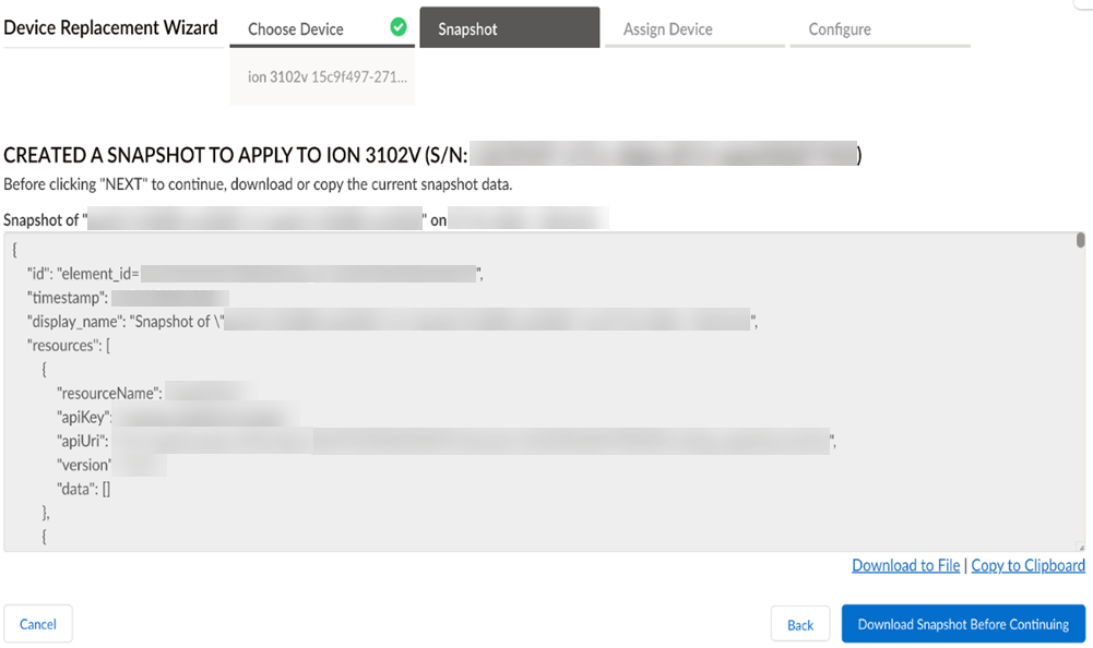

  5. Click Next to select a snapshot for the replacement device.
    The replacement device must be online and claimed to apply the snapshot.
  6. After the snapshot is created, click Download Snapshot Before Continuing.
    Device Replacement Wizard Snapshot step showing snapshot data with a Download Snapshot Before Continuing button
  7. Select Download to File or Copy to Clipboard as required.

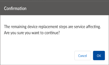

  8. Click Next to continue after you have downloaded the snapshot. Click OK after confirming that the remaining device replacement steps are service affecting.

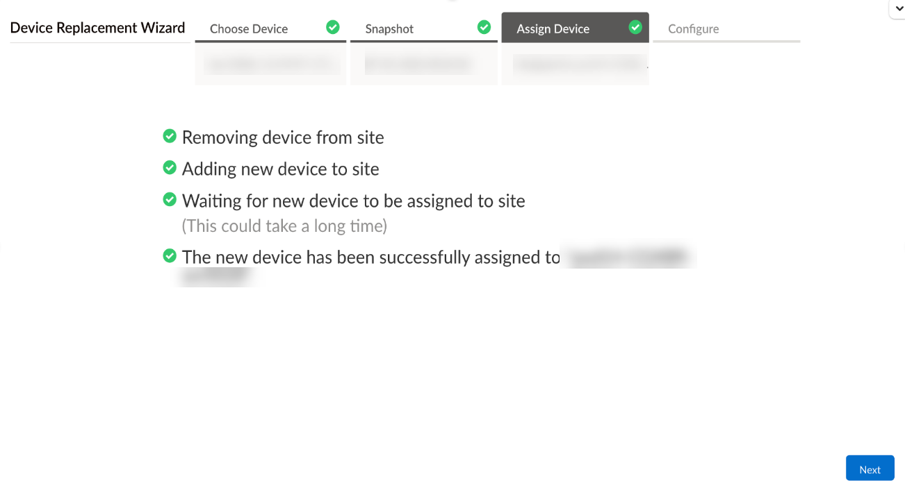

  9. Assign the replacement device to the site.
    Device Replacement Wizard Assign Device step with all progress checks complete and a Next button
    The Replacement Wizard will take the site information from the failed device and transfer it to the replacement device. When the replacement device is assigned to the site and the faulty device is unassigned, the service may be affected temporarily.

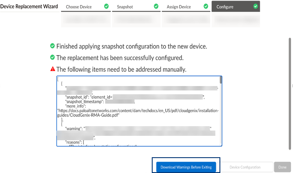

  10. Click Next to configure the service.
    Device Replacement Wizard Configure step with manual-action warnings and Download Warnings Before Exiting button
  11. Click Done when you have copied the manual configurations to complete the replacement process.
    The Replacement Wizard automatically transfers the configuration from the old device to the new device. There may be flags for the functions that need to be manually configured. Configurations that are not copied will be listed in a text box.
    The final screen displays when the device is successfully configured. If there are any warnings, download them before you exit the wizard.
  12. Click Done to complete the device replacement process.
