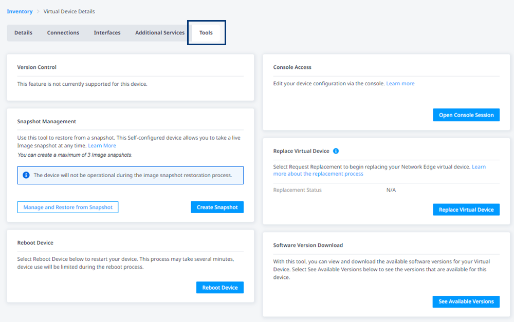

  4. Click the device name, and then click Tools.
    Virtual Device Details Tools tab highlighted, with snapshot, reboot, console, replace and software version cards

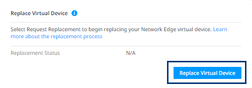

  5. In the Replace Virtual Device section, click Replace Virtual Device.
    Replace Virtual Device section with the Replace Virtual Device button highlighted
    Click Request Replacement.
    Replace Virtual Device card showing replacement status and the Request Replacement button

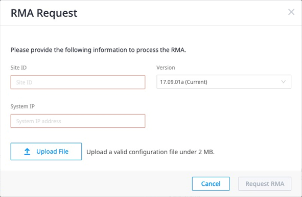

  6. In the Request box, enter the Site ID, System IP, and click Upload File to upload your Bootstrap file.
    info
    The System IP must be different from the IP for the failed device. However, it is highly recommended you use the same Site ID as the one used for the device you are replacing.
    The Bootstrap file extension must be .cfg and the file size can’t be larger than 2 MB.
    RMA Request dialog with Site ID, System IP, version and Upload File fields

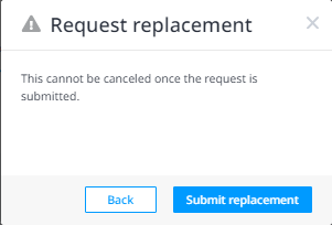

  7. Click Request.
  8. In the Confirm Request box, click Submit Request.
    Request replacement confirmation warning that it cannot be canceled, with Back and Submit replacement buttons
warning
Once the request has been submitted, this process can’t be canceled.
