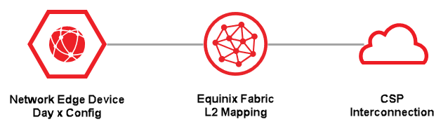

Day 0 Configurations
Equinix creates the initial or Day 0 configuration of a Network Edge device based on a configuration template and applies it to all deployed Network Edge devices. The Day 0 configuration is persistent so that all initially deployed and recovered Network Edge devices have the same Day 0 template.
The template differs based on the type of device.
Day 1 Configurations
Day 1 configurations are configured by you and are common to all devices, for example, NTP, Syslog, SNMP trap destination.
Day 2..N Configurations
You create Day 2 and beyond configurations that are unique to your devices.
The process of restoring a Day 1 or Day 2..N configuration varies by device and is explained in the Recovery page.

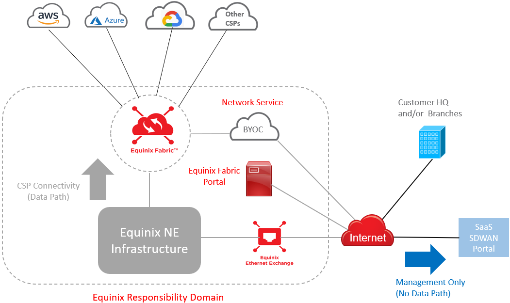

SD-WAN Support Responsibilities
Responsibility for resolving SD-WAN issues depends on the nature of the issue. Some issues are the responsibility of Equinix, while other issues require you to contact your device vendor.
This table lists common SD-WAN issues and indicates the responsible party.
| Issue Type | Your Responsibility | Equinix TAC Responsibility |
| CSP & BYOL Connectivity through Equinix Fabric | Equinix will triage and troubleshoot the issue. | |
| Equinix Internet Access Connectivity | Equinix will triage and troubleshoot the issue. | |
| Network Edge Device Life Cycle | Equinix will triage and troubleshoot the issue. | |
| BYOL Licensing | You handle license-related issues | |
| Controller Log in & Password Issues | You contact SD-WAN vendor | |
| Device Discovery in Controller | Vendor and Equinix work together to troubleshoot | |
| Controller Version Upgrade | You contact SD-WAN vendor | |
| Controller Usability and Feature Related Questions | You contact SD-WAN vendor | |
| Device Upgrade from Controller | You contact SD-WAN vendor | |
| Device Configuration and Management using Controller | You contact SD-WAN vendor | |
| Controller Programmability & API Related Issues | You contact SD-WAN vendor | |
| Administration and Managing the Controller | You contact SD-WAN vendor |
