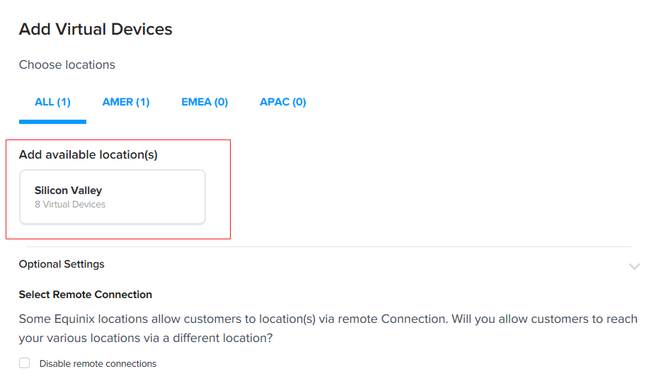

Select the Location​
  1. In the Add available locations section, click a location.
    Add Virtual Devices step with the Add available location(s) section highlighted and a Silicon Valley location card

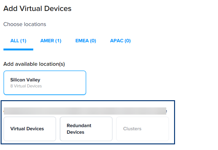

  2. Select Virtual Devices, Redundant Devices, or Clusters.
    Add Virtual Devices step with a location selected and Virtual Devices, Redundant Devices, and Clusters options highlighted

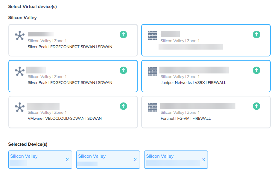

  3. In the Select Virtual Devices section, select the devices.
    Select Virtual device(s) list with chosen devices shown in the Selected Device(s) section
    The devices you selected will display in the Selected Device(s) section.

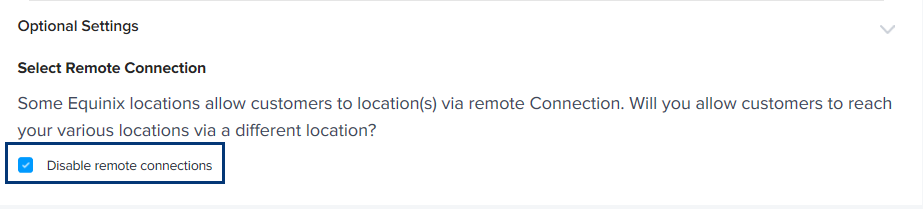

  4. If you do not want customers to reach your location(s) through a different location, select the Disable remote connections checkbox.
    Select Remote Connection option with the Disable remote connections checkbox checked and highlighted

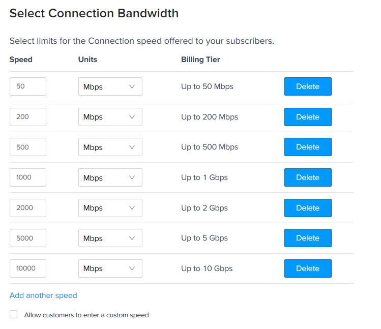

Choose Bandwidth​
  1. In the Select Connection Bandwidth section, determine connection speed limits for your subscribers.
    • Click Delete next to any of the speeds listed.
    • Click Add another speed if you want to add a speed that isn't listed.
    Select Connection Bandwidth table with speed rows, Delete buttons, Add another speed, and a custom speed checkbox
  2. If you want to allow subscribers to add a custom speed, select the Allow customers to enter a custom speed checkbox.

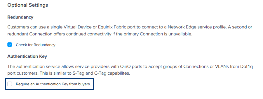

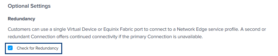

  1. In the Optional Settings section, click Check for Redundancy if you want Network Edge to check the customer's device for redundancy when connecting to the service profile.
    Optional Settings Redundancy section with the Check for Redundancy checkbox checked and highlighted
  2. Select the Require an Authentication Key from buyers if you want port customers to use a key to access.
    Authentication Key section with the Require an Authentication Key from buyers checkbox highlighted

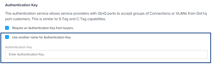

  3. If you checked Require an Authentication Key from buyers and you want to use another name for the authentication key, select Use another name for Authentication Key and enter the key in the Authentication Key field.
Authentication Key options with Use another name for Authentication Key checked and the key name field highlighted
