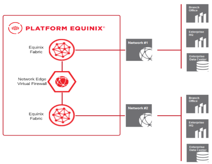

The topology shown below depicts two disparate networks that must be interconnected as part of an acquisition. The immediate need is to deploy an agile solution that can create interconnectivity between the networks to allow for further integration.
This solution reduces the number of deployed devices and creates a single security control point between the networks. You can also deploy this at distributed control points for inter-region connectivity if needed for performance or regulatory requirements.
Communication between the networks is provided by direct private Layer 2 interconnections over the Equinix Fabric, with the Network Edge device providing Layer 3 routing and security services. The Network Edge device is a virtual network function (VNF) that is hosted by the Network Edge network function virtualization (NFV) platform.
Network Edge virtual firewall between two Equinix Fabric connections to separate networks and sites
