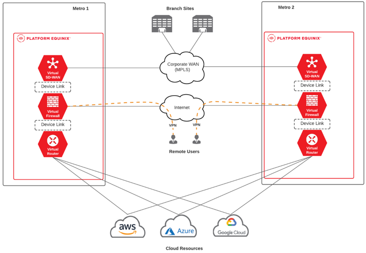

Architecture​
The geo-redundant design in this reference architecture is deployed across just two metros. However, this approach can scale to any Network Edge-enabled location, providing a higher degree of fault tolerance. As described above, each metro deployment provides more localized access to the resources being consumed, but more importantly, provides a path to consume those resources through an alternate metro in the event of a failure.
The deployment shown below is comprised of a three-tier architecture, consisting of a router, a firewall, and an SDWAN appliance in both metros. However, this approach can be applied to any of the use cases outlined in this document. The idea is to create a templated approach based on the specific connectivity requirements. This consistent design can then be deployed across the Network Edge infrastructure, closer to users and resources. It's to this point that care should be taken with the deployment locations to ensure that cloud, ISP (Internet Service Provider), and NSP (Network Service Provider) services are available in that metro. This is further outlined in the Considerations section below.
