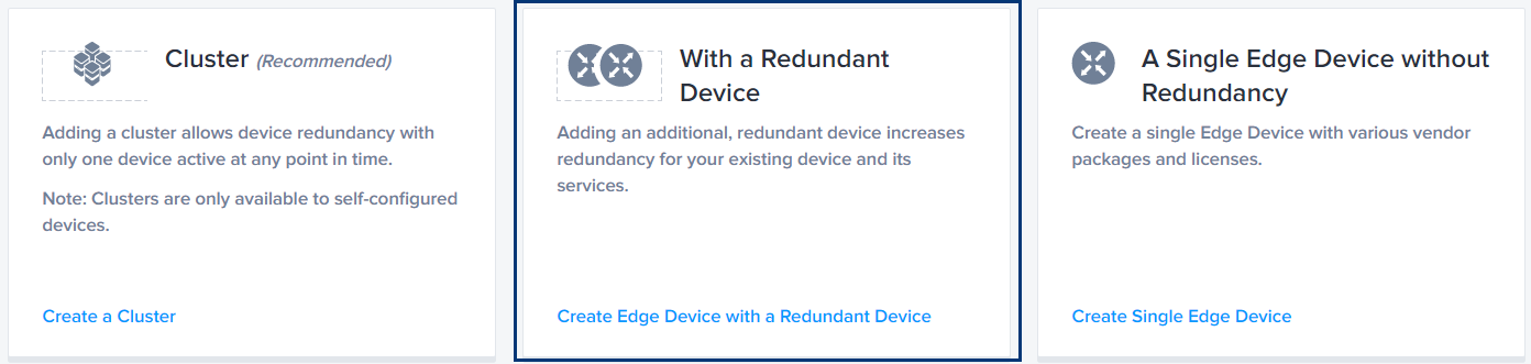

The first High Availability (HA) option released in Network Edge was the ability to deploy VNFs with redundancy. When creating a device in the Equinix portal, HA is the middle option labeled With a Secondary High Availability Device.

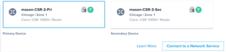

Choosing this option creates two devices that are logically grouped together in the Equinix Portal. The devices can be installed in the same Equinix metro (most common) or they can be deployed in different metros (for example, Chicago and Dallas). One VNF is designated as Primary and the other is Secondary. Redundant devices can only be deployed in pairs and support manually configured device linkages that enable additional features that are vendor-specific.
Both devices will have uniquely addressed interfaces, and both will actively forward traffic (Active/Active). For management and licensing, redundant devices are treated as two independent devices by Network Edge. No other device linkages are created at VNF inception.

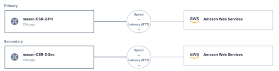

Redundant devices in Network Edge are depicted in the Equinix Portal as shown in Figure 2. This ensures a consistent methodology as services and connections are created on the redundant devices. Virtual connections can be created to one or both devices.

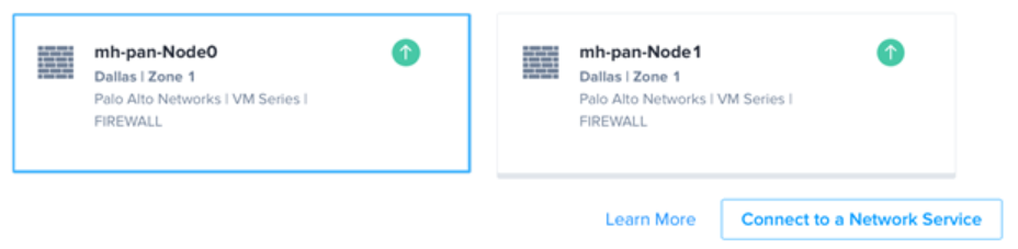

With clustering, the two VNFs are created in separate hardware planes but share the same management address. One VNF is designated as “Node 0” and the other as “Node 1” and can only be deployed in pairs. Currently clustering is supported for Juniper, Palo Alto Networks, and Fortinet. Clustering is only supported with Self-Configured devices using the Bring Your Own License (BYOL) option.
During the VNF creation process, Network Edge orchestration builds the required device linkages between Node 0 and Node 1. These linkages are based upon the vendor’s requirements. Unlike the Redundant Devices option where these linkages are supported but must be manually configured, clustering follows the guidelines set by the VNF vendor.
Clustering allows for two VNFs to present as one logical device to the rest of the network. If Node 0 should fail then Node 1 will automatically take over. How fast this failover occurs is dependent on each vendor and the specific configuration. Clustering allows VNFs to take advantage of features like configuration syncing and state-sharing. Note that these features vary by vendor and licensing.

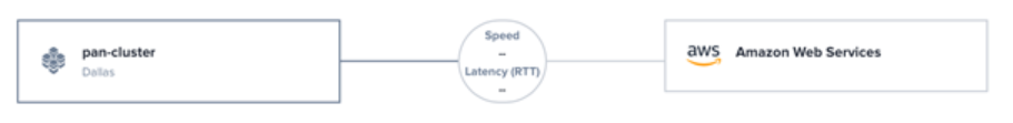

Clustered devices are treated as a single device in the Equinix Portal. Virtual connections that are built to the cluster are connected to both devices but only show as a single connection, because the standby unit inherits the connections of the active unit.
