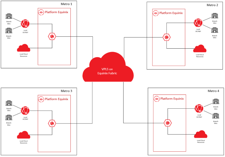

The global SD-WAN backbone deployment in this reference architecture utilizes SD-WAN virtual appliances deployed in different metros on the Network Edge infrastructure, connected together using the Equinix Fabric.
These Network Edge deployments will act as the regional hubs. Being integrated directly into Equinix Fabric, Network Edge devices have the necessary interconnection to clouds and networks to make this architecture successful. Additionally, Equinix Fabric will be used to provide the underlay connectivity for the global SD-WAN overlay.
When looking at Equinix Fabric for global connectivity between Network Edge devices, two main networking approaches are supported:
  • Virtual Circuit – This is the typical Equinix Fabric connectivity model in which a virtual circuit is created between two devices to create a point-to-point connection.
  • Device Link – This is a full-mesh globally available VPLS that will place all connected devices into a single broadcast domain.
More information about device linking, see Device Link.
it's also worth noting that each networking service (both point-to-point virtual circuits and device links) use one interface on the virtual appliance, making device link a lot more scalable across large deployments. However, if a semi-meshed network topology is desired, a combination of both of these services can be used.
The diagram below assumes that device link is used to connect all of the virtual SD-WAN hubs across the different metros, as this provides the most scalable solution as additional metros are deployed in the future.
