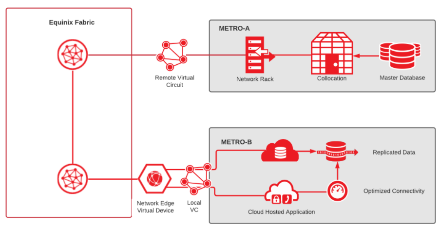

Architecture​
This reference architecture scenario consists of a primary database deployed in an Equinix colocation cabinet in Metro A that must be replicated to a cloud-hosted database in Metro B. There are no plans to deploy hardware in Metro B, so all components must be deployed virtually. Metro B also includes a hosted application that will access data from the replicated database. To optimize application performance, the hosted application and the replicated database must be in close proximity.
Network communication between the metro locations is provided by Equinix Fabric over a remote virtual circuit. The low latency connections between the replicated database and the hosted application are provided over local virtual circuits, which interconnect the application to the replicated database hosted on different cloud providers.
Equinix Components​
  • Equinix Fabric – Equinix Fabric is a switching platform that provides private connectivity to a wide selection of providers that are participants on the Fabric. Virtual circuits are provisioned on the Fabric using software-defined networking to establish connectivity to providers that are connected to the Fabric. Virtual connections can be created using the Customer Portal or APIs.
  • Equinix Network Edge – Network Edge is an ETSI-compliant NFV platform that hosts virtual network functions (VNFs) (routers, firewalls, and SD-WAN) from various vendors such as Cisco, Juniper, Palo Alto, Fortinet, Versa, Aruba, and Check Point. VNFs can be deployed in real-time and, once deployed, you can start building virtual connections to providers on the Fabric.
  • Remote virtual circuit – Remote virtual circuits are used to build Layer2 circuits across the Fabric. The Layer 2 underlay is stitched together using a combination of VNIs and VLANs so you can form Layer 2 adjacencies to establish Layer 3 connectivity. Virtual circuit bandwidth can be dynamically adjusted as application needs change.
  • Local virtual circuit – Local virtual circuits function the same as remote virtual circuits and are deployed within the same metro when building interconnections to Fabric participants.
  • Network rack/colocation – Network equipment and the primary database would be hosted in an Equinix data center in Metro A and the network equipment would be connected to the Equinix Fabric. The network equipment in the network rack would establish Layer 3 peering over the remote virtual circuit to the Network Edge virtual device in Metro B.
Cloud Service Provider (CSP) Components​
  • Private interconnection – Private interconnections from the CSP are Layer 2 partner or hosted connections that connect to the Equinix Fabric. Partner or hosted connections provide an intermediate switch between a device and the CSP router it peers with. Once the private Layer 2 interconnection has been established, you can set up Layer 3 peering with the CSP gateway. Private interconnections bypass the internet.
  • Cloud hosted service – The application and replicated database are hosted in cloud providers located near the Network Edge virtual device in Metro B.
  • Optimized connectivity – Due to the proximate location of the cloud-hosted components and the Network Edge virtual device that are interconnected through virtual circuits, the application is optimized for performance.
