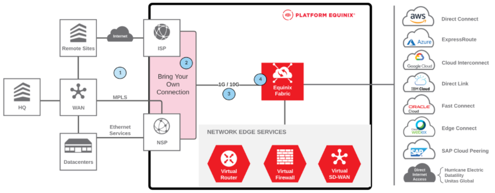

Architecture​
Components​
  1. Network Service Provider
    • Layer 2 Ethernet services / Layer 2.5 MPLS / Layer 3 Internet
    • NSP service provisioned as Tagged or Untagged (802.1q or 802.1ad)
    • Handoff - SMF
  2. Network Service Provider Facilities
    • Letter of Authorization (LOA) / Channel Facility Assignment (CFA)
    • NSP tiedown location
    • NSP deployment of Network Interface Device (NID)- NSP Demarcation
  3. Equinix Physical Cross Connect
    • Equinix IBX Technician extends physical circuit from NSP patch panel
    • 1G / 10G
    • Dedicated circuit
  4. Network Edge Remote Fabric Port
    • Physical termination of cross connect circuit to a dedicated port on the Equinix Fabric
    • Designated NSP Virtual Connection associated with Network Edge VNF services
    • Virtual Connection scalable to maximum of physical port
