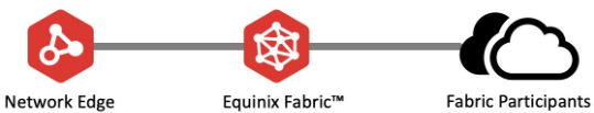

Imagine a network design from the origin of a data packet and moving from inside outward to its destination. In that case, each point where traffic is processed or traversed becomes a possible point of failure. The key is to design against an impacting event at the traversal points.
In a simple network flow from a Network Edge device to an Equinix Fabric participant, as shown in the next graphic, the traffic flows have three distinct points: Network Edge virtual device, Equinix Fabric, and the Fabric participant connection. There is inherent redundancy between the Network Edge virtual device and Equinix Fabric, so the Leaf or Spine architecture that interconnects the underlying NFV platform to the Fabric is redundant. There is no inherent redundancy between Equinix Fabric and the Fabric participant. To achieve maximum redundancy, you must deploy a solution that utilizes different planes of connectivity to take advantage of the complete network flow.

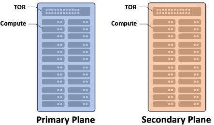

Primary and Secondary Planes
The Network Edge is built upon a standard data center redundancy architecture with multiple point of deployments (PODs) that have dedicated power supplied. The concept of Primary and Secondary planes is behind the deployment of Network Edge and Equinix Fabric. Network Edge utilizes the Primary and Secondary planes using compute separation through affinity. Each virtual device in a fault-tolerant pair is deployed in its respective cluster. While referred to as Primary Plane and Secondary Plane, there are multiple compute planes in each Network Edge PODs. The actual number varies based on the size of the metro. This allows devices to be deployed in a manner where they are not co-mingled on the same compute plane, eliminating compute as a single point of failure (SPOF).
Equinix Fabric switches are part of a chassis group that consists of Primary and Secondary switches. The Primary and Secondary switch designations for the chassis group are simply a way to identify the switches from a nomenclature standpoint and do not show traffic flows. Active-Active or Active-Standby from a routing standpoint are configured on Network Edge device and are completely under your control. The Platform Architecture documentation discusses more details on the Network Edge foundational architecture.
Example
A firewall VNF called NGFW-A is deployed previously. To deploy a router VNF on the secondary plane, use Diverse Compute from an Existing Single Device feature and select NGFW-A from the drop-down menu.
