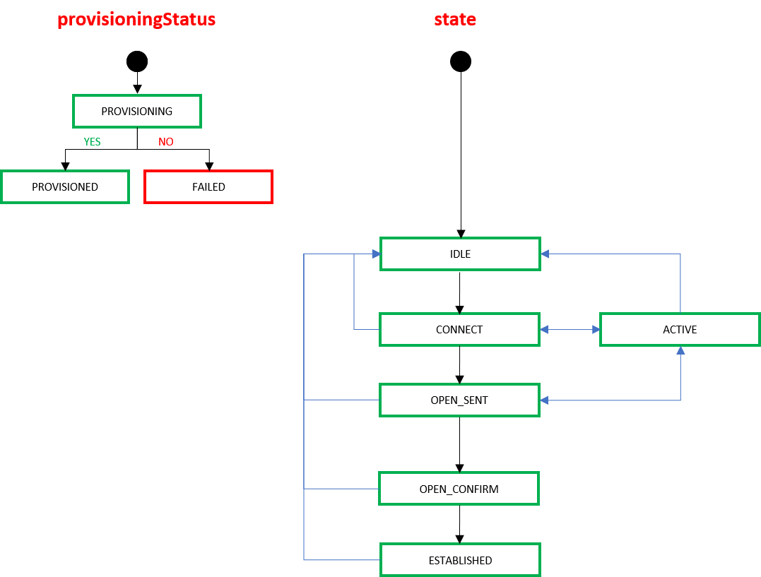

BGP Status
After you create BGP peering, you can check the status of your BGP peering by calling GET BGP {uuid}.
BGP provisioningStatusDescription
PROVISIONINGBGP peering is provisioning.
PROVISIONEDBGP peering is provisioned.
FAILEDBGP peering failed.
Possible BGP states: Idle, Connect, Active, Established, OpenSent, and OpenConfirm.
The BGP states can be only be seen after the BGP is provisioned.
