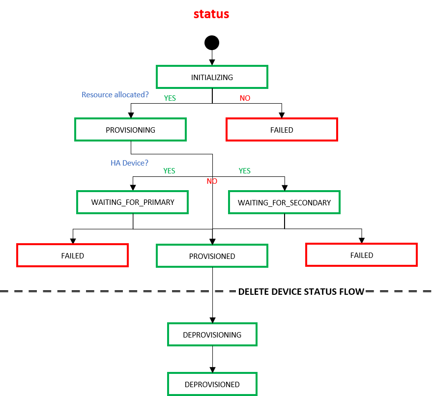

Device Status​
Monitor the status of your device by calling Get Virtual Device {uuid}. Your device must be provisioned and your license must be registered before you can connect to cloud service providers.
Virtual device "status"Description
INITIALIZINGEquinix is in the process of reserving resources and creating the device.
PROVISIONINGThe device is booting.
PENDING_ORDERThe order has come to NE from Siebel. Customers need to log in to the NE portal and submit the order.
PENDING_SIGNATUREThe customer has signed up for the offline acceptance of NE terms but has not yet accepted the terms.
CANCEL_ORDERThe order from Siebel to NE is canceled.
WAITING_FOR_PRIMARYThe secondary device is ready but the primary is not. This state might appear only if you have created a secondary device for redundancy.
WAITING_FOR_SECONDARYThe primary device is ready but the secondary is not. This state might appear only if you have created a secondary device for redundancy.
FAILEDThe device creation failed.
PROVISIONEDThe device is ready.
When end-users delete a device using the Delete Virtual Devices API, the device transitions through the following states within the Equinix infrastructure.
Virtual device "status" under /ne/v1/devices/{uuid}Description
DEPROVISIONINGEquinix accepted the customer's request to delete a virtual device.
DEPROVISIONEDThe device is de-provisioned/deleted.
