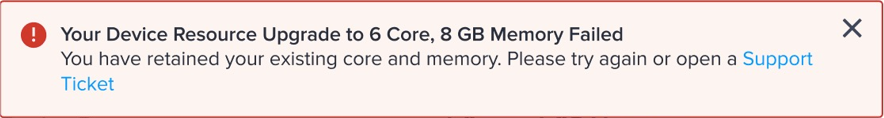

If your device resource upgrade fails, a failure message will be displayed in the Device Resource section of the Device Details page.
When the resource change process fails, the system automatically retains the existing resource configuration. You can retry the resource change or open a support case to start investigation on this process failure.

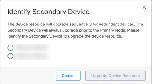

In the Identify Secondary Device box, select the secondary device.
Click Update Device Resource.
The upgrade of the secondary device will begin. Once the secondary device upgrade is complete, the primary device resource resize starts.
