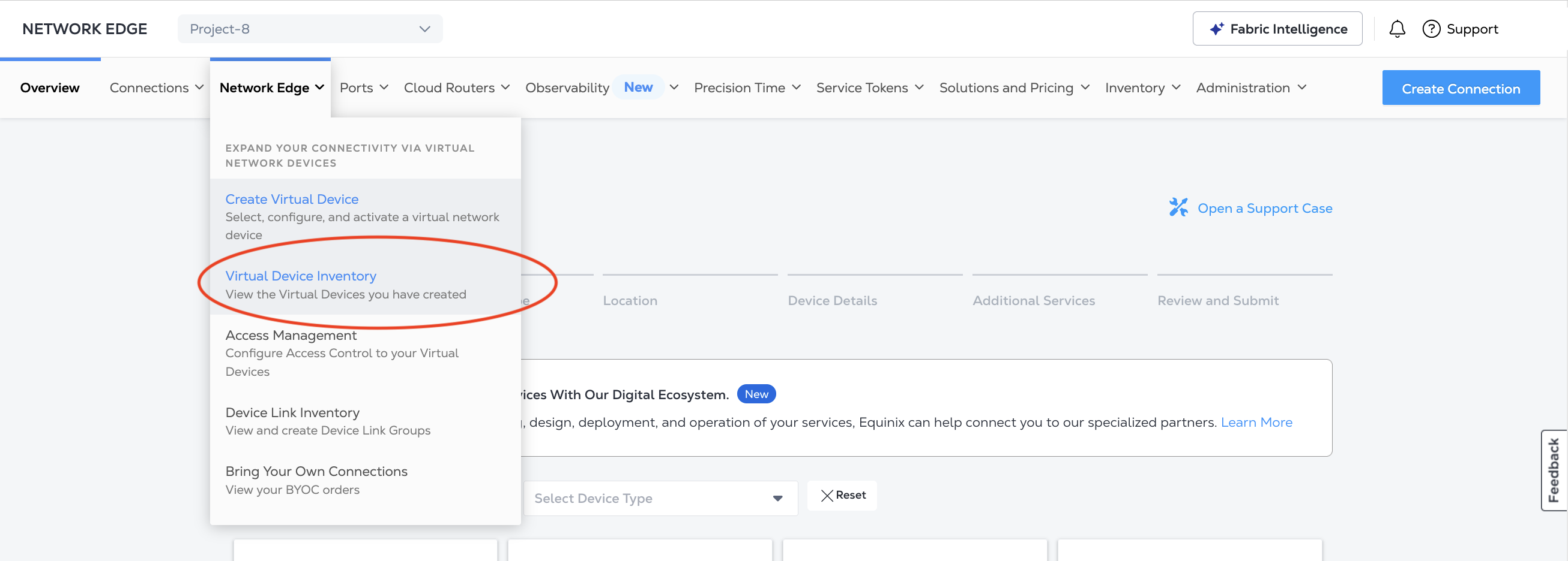

Sign in to the Equinix Customer Portal and go to Network Edge.
From the Network Edge menu, select Virtual Device Inventory.

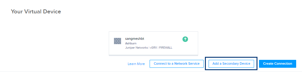

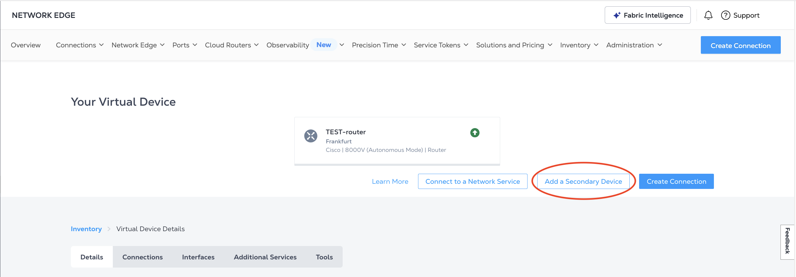

From your Virtual Device Inventory, click the name of the virtual device to view its Virtual Device Details.
Click Add a Secondary Device.

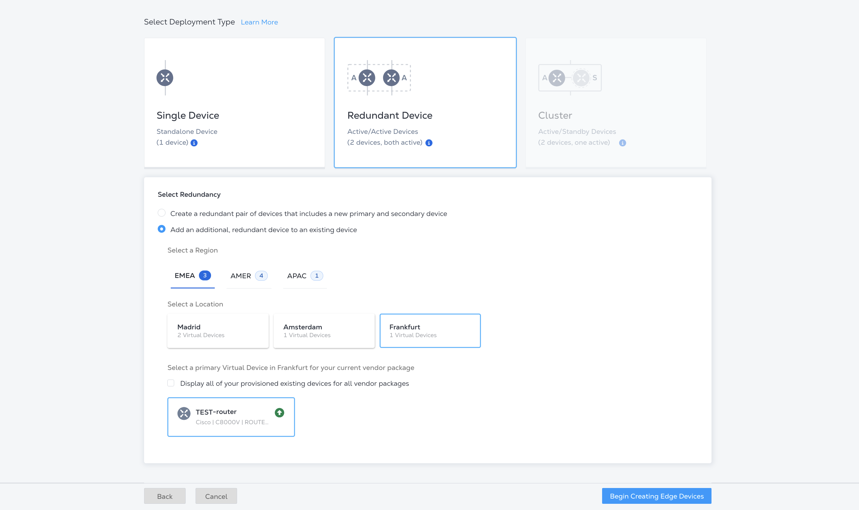

The vendor package is automatically set to be the same as your primary device. You don't need to select or configure the vendor package for the secondary device.
For Select Deployment Type the following options are automatically configured:
- Redundant Device
- Add an additional, redundant device to an existing device
- The location and the primary virtual device
Click Begin Creating Edge Devices.

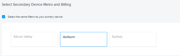

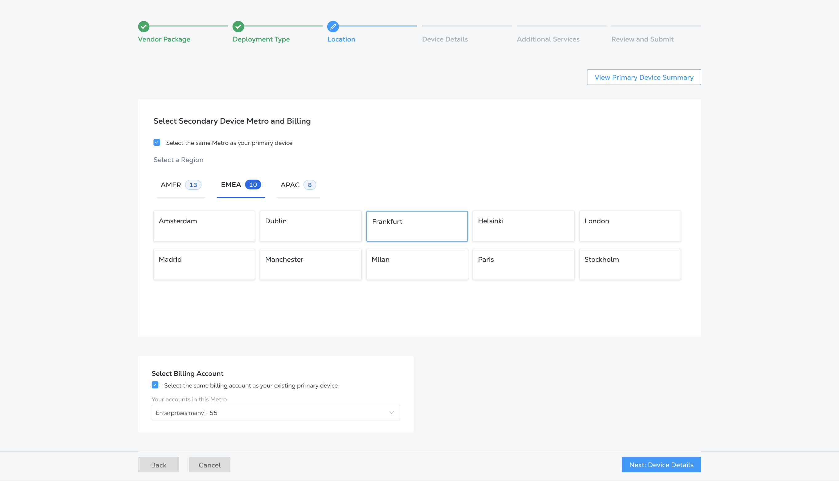

Select a location for the secondary device. By default, Select the same Metro as your primary device is checked, and the Metro of the primary device selected.
To select a different Metro location, uncheck Select the same Metro as your primary device, and select a different Metro.
Select a billing account from the drop-down list, or click Select the same billing account as your existing primary device.

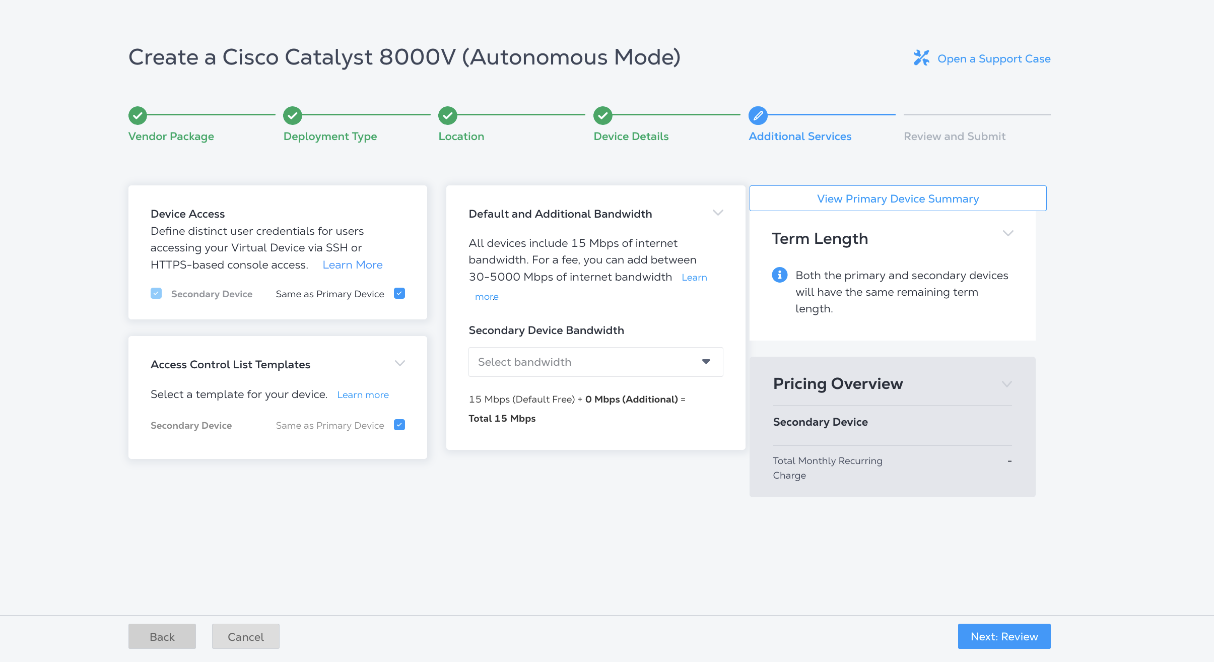

Select any additional services for the secondary device. They default to the same selections as the primary device.
To modify Device Access, uncheck Same as Primary Device and configure the secondary device's access configuration.
To modify the Access Control List Templates, uncheck Same as Primary Device and select one from the drop-down list or create a new one.
To add additional bandwidth to the secondary device, select a bandwidth from the Secondary Device Bandwidth drop-down.

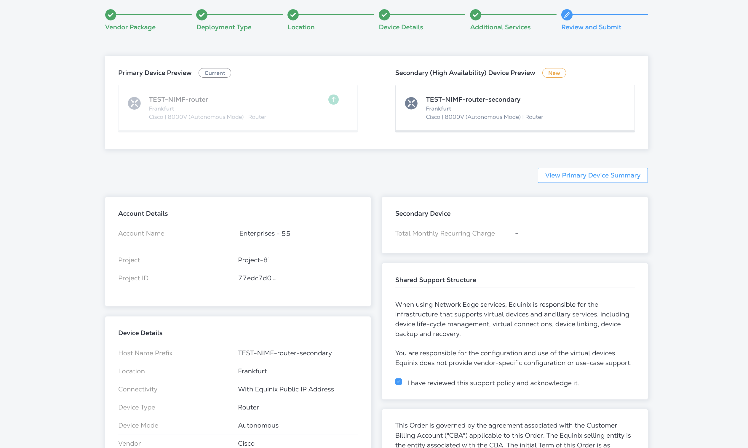

Click Next: Review and review your order. In the Shared Support Structure section, you must click I have reviewed this support policy and acknowledge it.
Click Create Virtual Device.

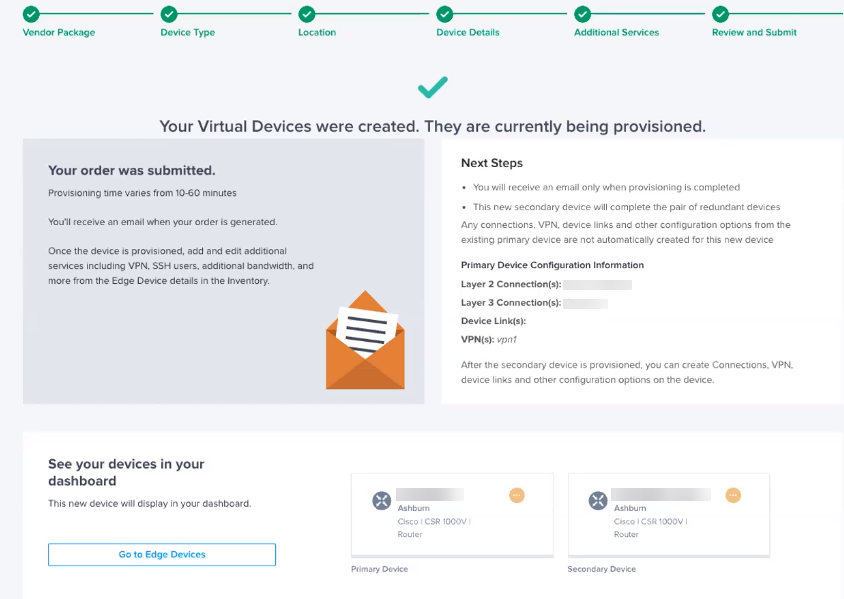

While the secondary device is being provisioned, the status of the primary device will change to
WAITING_FOR_SECONDARY. If the secondary fails to provision, the primary will move back to the
provisioned state. If the secondary provisions, then the status of both the devices will change to
PROVISIONED.
