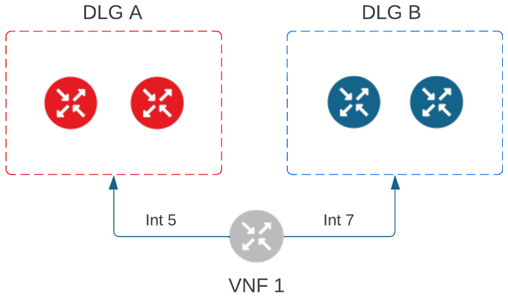

To create a device link among multiple devices, a unique Device Link Group needs to be defined. This group has a common name and requires the use of a single interface on each device that’s part of the group. A device can be part of more than one group, but each device is on a discrete interface:

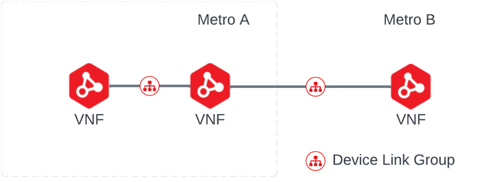

Users can add one device per metro per device link group. Traffic travels from one device to another between the Metros using the same backbone Equinix Fabric uses.

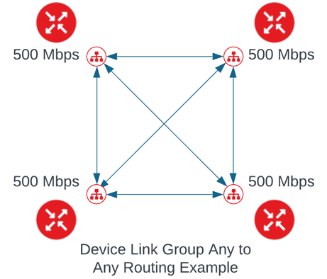

The traffic that moves in and out of a metro is policed as a single measure of throughput for each metro. This is important to understand so that users can set up the device link to optimize the traffic flow and overlay routing that is intended.
For example, in a full mesh setup users typically have the same throughput setting in every metro, as shown:

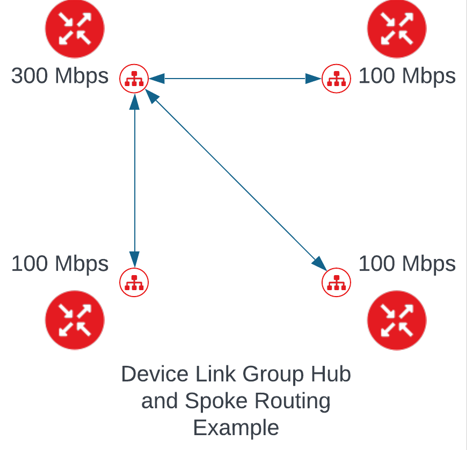

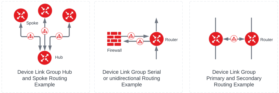

Alternatively, if the intention with a Device Link group is to set up a hub and spoke routing schema, users can add throughput limits like the below:
As functionality is added to allow more than one device per metro into a device link, this design and throughput setup becomes critical. This configuration remains a per metro setting, not a per device throughput setting. Within the metro, there is no enforced throughput policy, but there might be other limitations, such as the throughput of the device itself, the available capacity in the compute node or the best effort traffic competing with other traffic.
When more traffic flows to or from a metro than is allocated (such as from routing design or throughput), packets are dropped as it's a best effort service. Users can edit and change the amount allowed for each metro at any time.

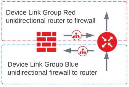

Because a single device can be part of multiple device links, users can also use this to overlay unidirectional traffic patterns for some use cases, such as firewalls that filter traffic and then return it to another device. The diagram below is an example of this:
Device link is always capable of being bidirectional, depending on the overlay routing rules that the user creates.

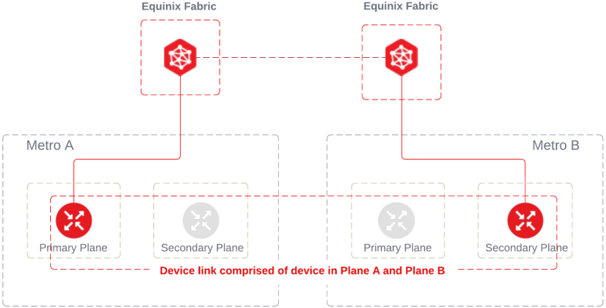

A device link can contain any combination of primary and secondary devices that are also part of a redundant pairing. This is the case even if the combination does not represent the same pairs. For example, a device link could theoretically include the primary device of redundant pair A and the secondary device of redundant pair B.

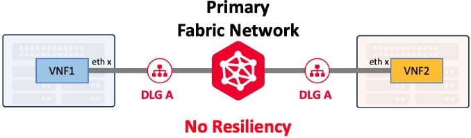

Device Link Groups (DLGs) can be created with or without redundancies. It is important to understand how redundant DLGs are created for better resilient architecture of the Network Edge service. See Device Link Resiliency for more information.
