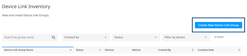

  2. From the Network Edge menu, select Device Link Inventory.
  3. Click Create New Device Link Group to start the DLG creation workflow.

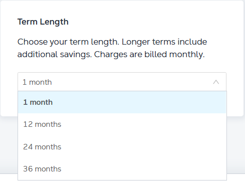

  9. In the Term Length section, select a term length.
    All Device Link Groups have independent term lengths regardless of the individual device term lengths.
