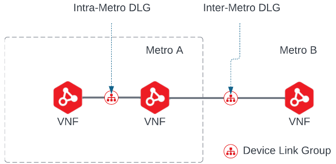

Network Edge users can connect devices together and pass traffic directly between any devices that are part of the same metro, or across metros. Customers can take advantage of service chaining, taking two devices that serve different functions and sending traffic between them.
The connectivity options for Device Link Groups (DLGs) are:
  • Intra Metro – Connection where devices are connected within the same metro. There is no charge for Intra-Metro DLG connections.
  • Inter Metro – Connection where devices are connected between different metros. There are charges for Inter-Metro DLG connections.

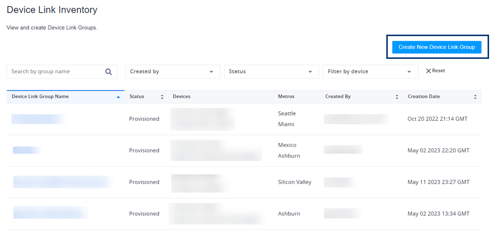

  1. Sign in to the Equinix Customer Portal and go to the Network Edge Dashboard.
  2. From the Network Edge menu, select Device Link Inventory.
  3. Click Create New Device Link Group.
  4. All of your devices will display. Click the devices you want to link.
  5. Click Next: Device Link Details.

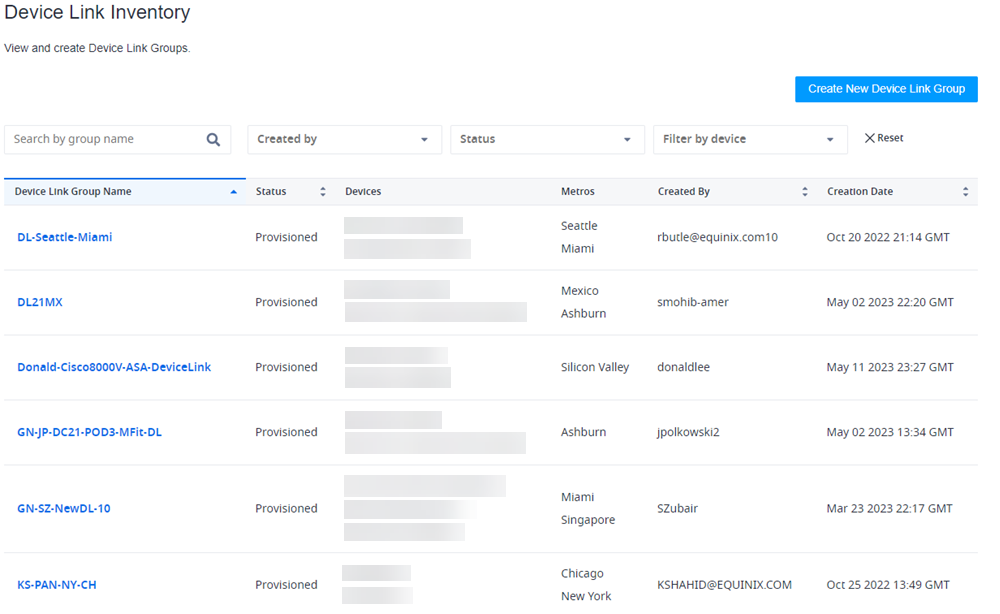

  1. From the Network Edge menu, select Device Link Inventory.
  2. Click the DLG from the inventory list. The basic device link details, device details, and pricing overview will display. From here, you can edit the device link.

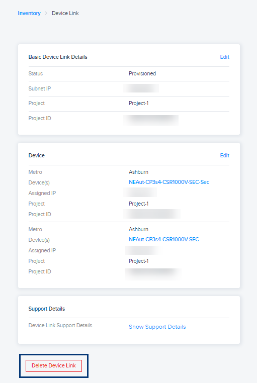

  2. Click the DLG you want to edit.
  3. In the Device section, click Edit.
  4. In the Pricing Changes prompt, click Continue Editing Device Link Group.
  5. All of your available devices will display, and the devices in this group are selected. Click any device(s) you want to add to the Device Link Group.
  6. Click any of the selected devices to delete them from the group.
  3. Click Delete Device Link.
