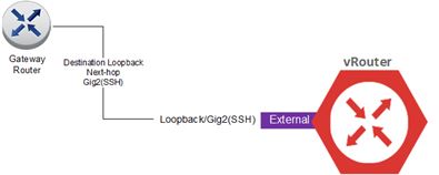

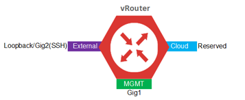

Three VRFs are created for virtual devices
  • MGMT
  • Cloud
  • External
The MGMT interface is associated with the MGMT VRF. The SSH and Loopback interfaces are assigned to the external VRF, the remaining reserved interfaces are assigned to the cloud VRF.
Each device comes equipped with a loopback interface that is created and placed in the external VRF and assigned an Equinix-owned public IP address during device creation. This interface is used for external connectivity requirements such as creating IPSec VPN tunnels and SSH access. External reachability to the virtual device is achieved by adding a host route on the gateway router that points the loopback address to the SSH interface on the virtual device as the next hop. The gateway router is part of the Equinix infrastructure for Network Edge and the routes are configured automatically as part of the provisioning process for virtual devices.
The MGT interface is placed in its own VRF and is used for management and provisioning activities.
The remaining interfaces reserved for cloud connectivity are associated with the cloud VRF and connected to the Equinix Fabric. These interfaces can then be used for virtual connections to respective cloud service providers.
The remaining interfaces are there for user customization and some forthcoming features, such as dedicated NSP links, service chaining, and others to be announced. Equinix orchestration won't provision cloud services on these reserved interfaces.
