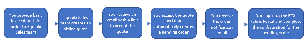

In scenarios where you require assistance from Equinix Sales team to get a formal quote and place an offline order (that doesn’t start from the Equinix Customer portal), the ordering and configuration work flow is:
The basic details that you must provide to receive a quote are:
  • Vendor Package
  • Throughput
  • Choose Single Device or High Availability Pair
  • Location where the device will be instantiated
  • Billing Account Number
  • Choose Equinix-Configured or Self-Configured
  • Subscription or third-party license (BYOL)
  • Cores and Memory (instance size)
  • Contact Information
The Equinix team will create an offline quote. An email will be generated, detailing the quote and providing a link to accept the quote. Once the quote is accepted, an order confirmation will be sent with a link to the Equinix Customer Portal.

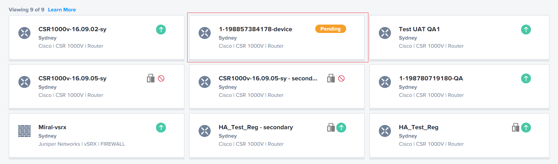

  1. Sign in to the Equinix Customer Portal and navigate to Network Edge.
  2. From the Network Edge menu, select Virtual Device Inventory.
  3. Click the pending device.
  4. Click Complete Pending Order Configuration. You will be prompted to complete the device creation work flow. (See Creating a Single Virtual Device for instructions on creating a device.)
  5. Click Create Virtual Device. The order is complete.

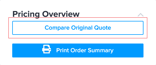

If you modify any configuration parameters that affect the price, Compare Original Quote appears in the Pricing Overview section.
Click Compare Original Quote to review the difference between the original draft device and the device you are currently configuring. If you would like to continue with modifications that impact the price, you will need to accept the Order Terms during the review step.
