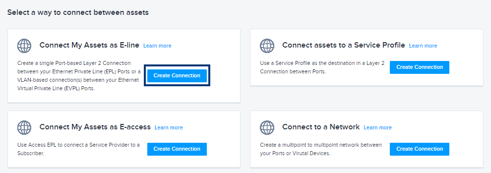

  4. On the Connect My Assets as E-line card, click Create Connection.
