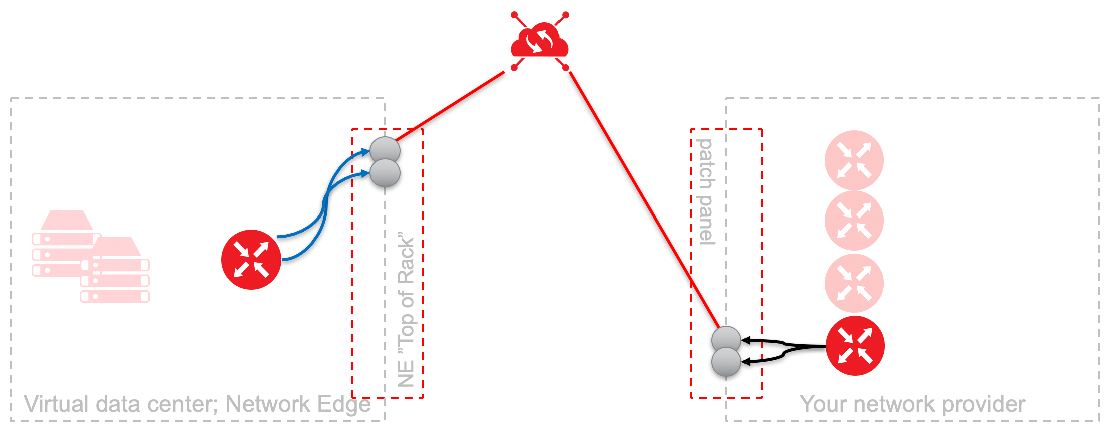

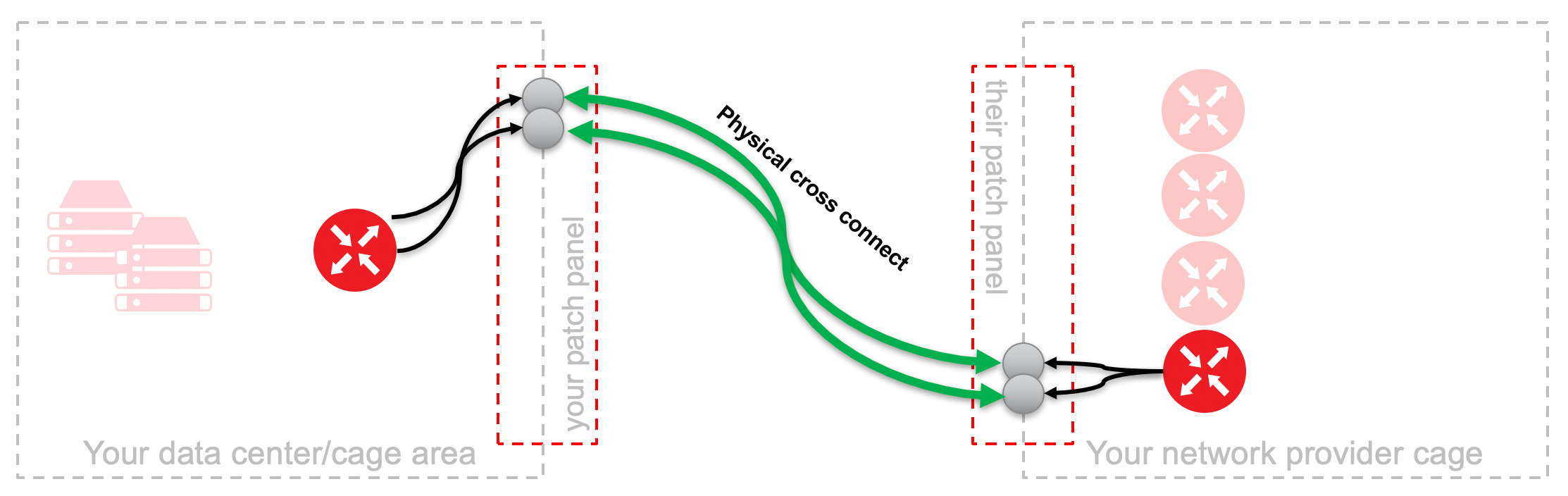

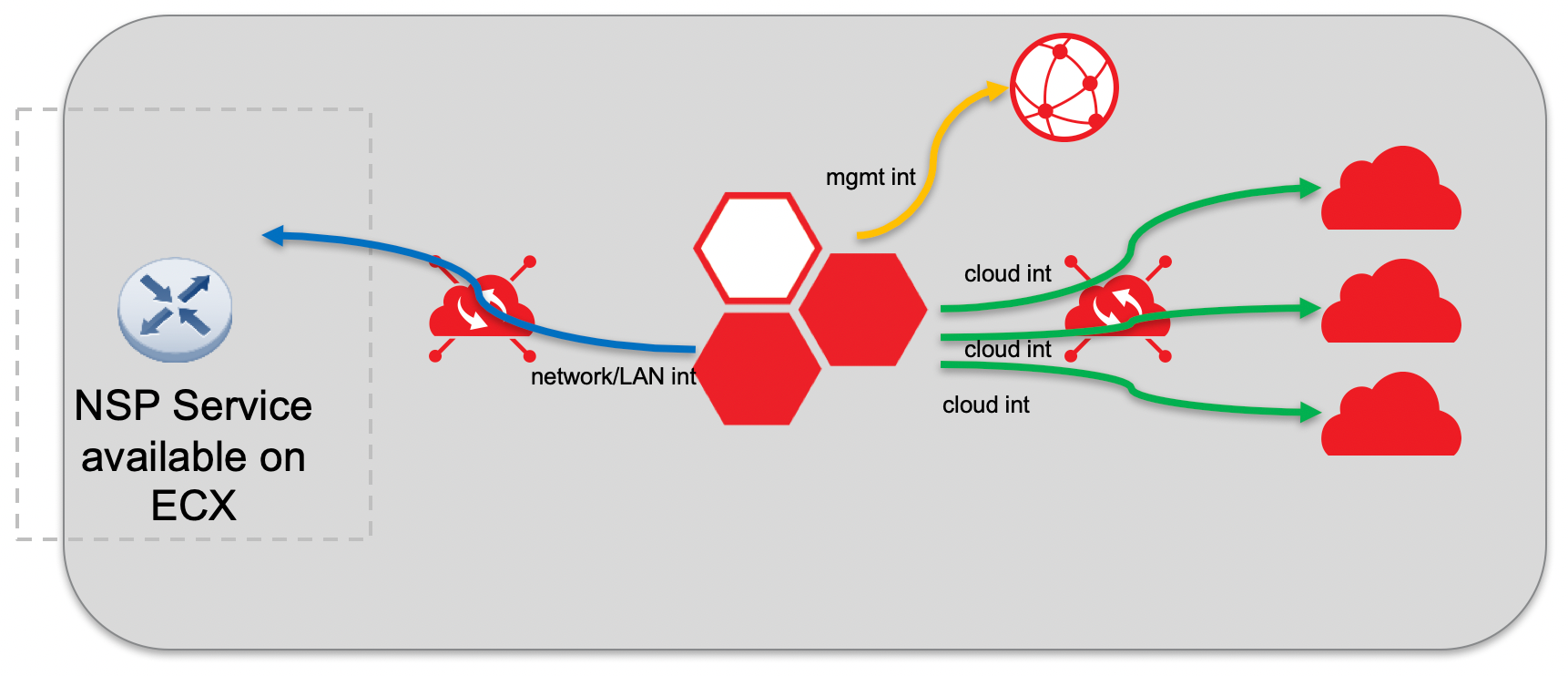

To connect a virtual device to a physical environment, the user needs to access the outside physical world from a device that is deployed on a shared compute node with virtual interfaces. This is usually done with cross connects from one data center or cage space to the next.
To facilitate this same activity with a virtual device that doesn't occupy a cage, we virtualize certain aspects of the solution, and there are many ways to do so.
All Network Edge devices connect to the outside world through the Equinix Fabric platform or through the internet (Equinix Internet Access), as this satisfies many use cases with no further connection needs. However, many users find that they want their virtual devices connected to an NSP that they want to or are already doing business with. Often this helps normalize the device with the rest of a global network deployment by integrating it with an existing MPLS network.
Connection is facilitated through the Equinix Fabric, and all traffic flowing in and out of the Equinix Fabric does so through a physical port, whether it's dedicated to a single user or service, or it's used in a multi-tenant way.
For a virtual device user to get to a network service that you have procured, there are a few ways this can be done through the Equinix Fabric with BYOC.
NSP is a Seller on Equinix Fabric​
In this scenario, the network provider offers its network products and services publicly through the Equinix Fabric. The virtual device owner creates a connection to the known, published service Equinix Fabric. This is the simplest method for virtual device owners, and we encourage network providers to participate in the Equinix Fabric ecosystem wherever possible.
If the NSP has a presence on the Equinix Fabric, find them in the list of services available and create a connection.

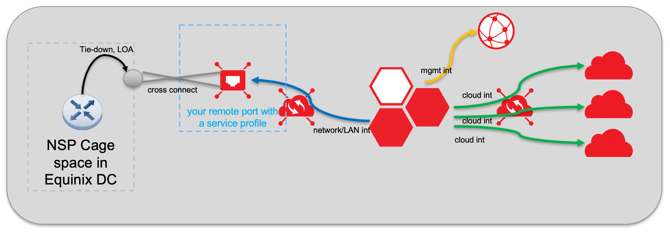

Remote Port​
A port is a physical place where interconnection occurs between two parties. The cables from each party are physically plugged together so that data can pass. With a remote port, the port is owned by the customer, but the location is not. The virtual device customer procures a remote port and owns that port in a physical location that the customer has no actual presence in.
A remote port can be used when there is no physical CPE router colocated in an Equinix data center. The virtual router can be connected to the Equinix Fabric switch through a Layer-2 service profile with the NSP connection terminated directly on the Equinix Fabric switch. The service profile is owned by the customer who is responsible for setting the correct attributes to establish connectivity.
To connect, place an order with your NSP and then provide Equinix with the LOA/CFA giving Equinix the authorization to connect between the NSP demarcation point and the Equinix Fabric switch. As in the case of a physical connection, you can also connect to any location on the Equinix Fabric (local or remote).

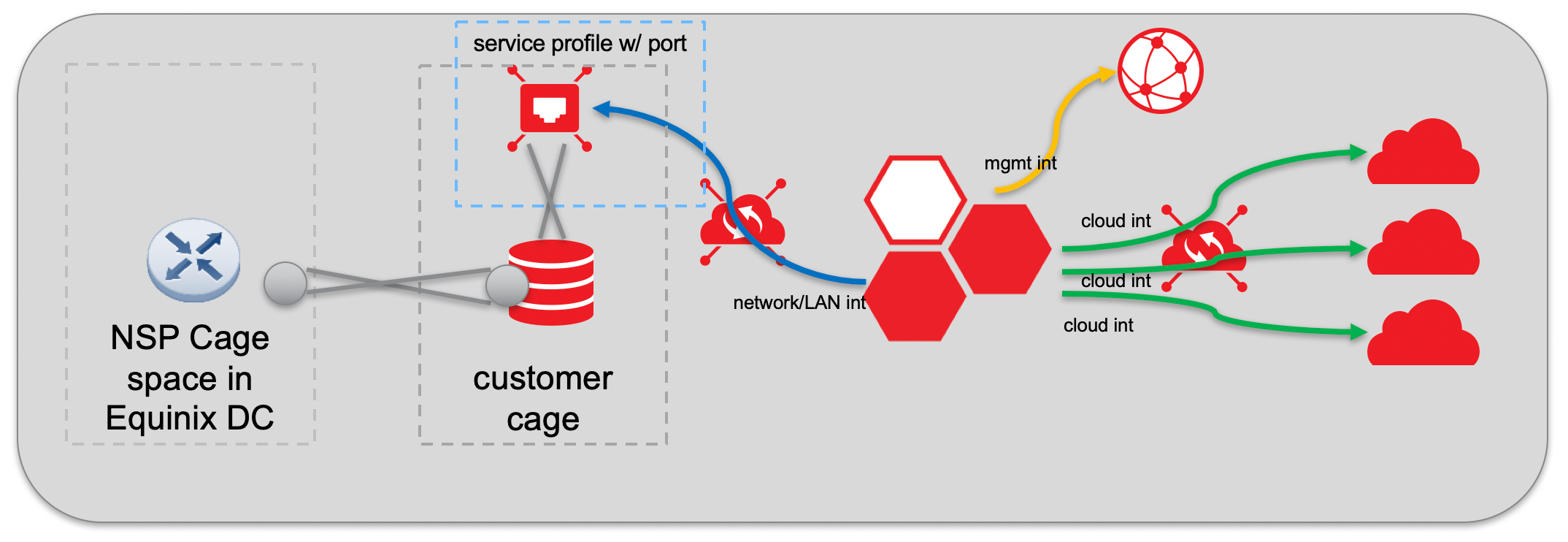

Connect To Your Colocated Resources​
Customer provided equipment can be colocated within an Equinix data center. To reach it, you need a physical port on the cloud exchange and a defined service profile to connect the virtual router. The virtual cross-connect can happen between any two locations on the Equinix Fabric (either local or remote). In the diagram below, the owner of a virtual device has connected remotely to a cage in another metro using the Equinix Fabric as the method for reaching the port.

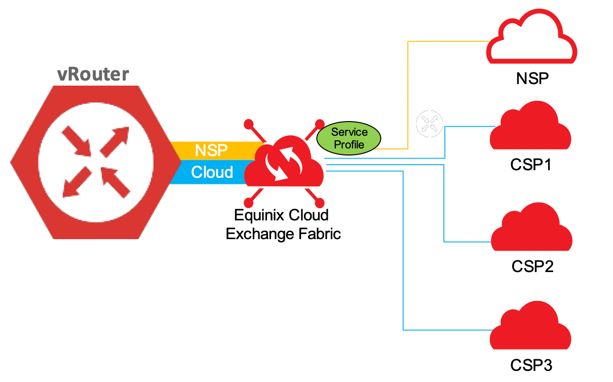

When you opt to connect to your NSP from a virtual device, we recommend that you use the special connection flows rather than standard create connection flows. This ensures your NSP connection is on a discrete interface and VRF that allows you to configure it separately and differently from other Equinix Fabric cloud traffic. Each virtual device is launched with a reserved network provider interface whether you opt to use it or not.
Service Profiles​
Connect to anything on the Equinix Fabric as a destination or Z-end by using a service profile. Anyone can create a service profile on Equinix Fabric with a port, and the service profile can be private so that only authorized users can see and use it.
You can delete the profile or remove the port from the profile immediately after creating a connection from your device to the port, and the connection remains in place. Users can also add BGP settings to ensure peering occurs between the environments. For this type of connectivity, Equinix recommends a Layer2 service profile.
