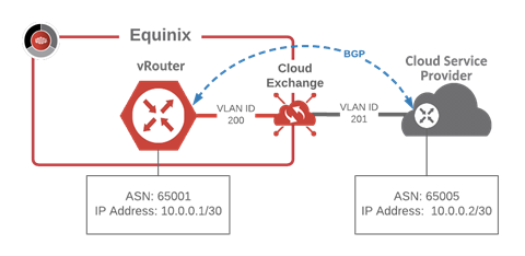

When a BGP service is added to an Equinix Fabric Layer 2 connection, your device can peer with the equivalent settings on the other side of that connection, just as you would set up a physical router to do the same. A typical setup with a connection from your device to a public cloud provider might look something like this:
Unless the user specifically requests or configures a custom setup, all connections to the Equinix Fabric traverse a single VRF from multiple virtual interfaces.
See Platform Architecture for more information about the typical set up and architecture.
These various connections can then peer with each other or with sessions on other interfaces (such as toward the public internet or a VPN tunnel).

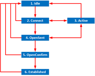

The BGP service goes through a series of states that conform to the standards defined by RFC 4271, but might have some vendor-specific nuance. This state transition is different from the state of the overall device and should not be confused with a broader failure.
Although the BGP session can cycle through all seven standard stages, the most notable BGP states are:
- Idle – The connection is not actively peering
- Established – The connection is peering and route tables are being updated
- Failed – The attempt to peer or find the ASN has failed and should be deleted or tried again
Consult with your vendor guidance or common BGP tutorials for more detail and state possibilities if you see one not mentioned here.

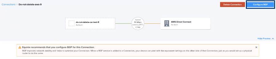

To add a BGP session, you must have a connection to your device. After you have at least one connection, go to your Connections Inventory and select the connection to view the connection details and configure BGP.
Sign in to the Equinix Customer Portal and navigate to Network Edge.
From the Connections menu, select Connections Inventory.
noteIf your connection does not already have BGP peering configured, a message will display on your connection details page indicating that Equinix recommends adding BGP to the connection.
Click the connection to which you want to add BGP peering.
On your Connection Details page, click Configure BGP.
