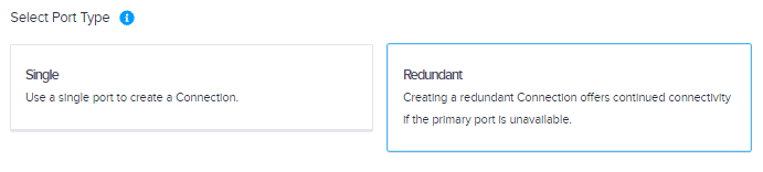

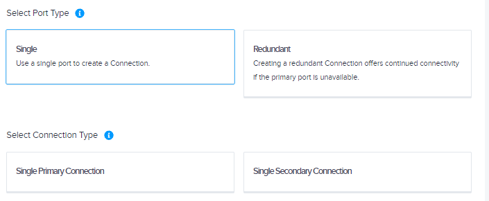

  2. In the _Select Port Type section:
    • Click Single if you want to use a single port to create a connection. If you click Single, select a Connection Type.
    • Click Redundant if you want to create a redundant connection for continued connectivity if the primary port is unavailable.
    While creating a single connection is an option, redundancy is not guaranteed without a redundant connection.
