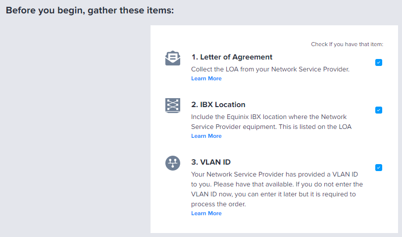

Prerequisites – The following items should be available:
  • NSP VLAN information
  • Letter of Authorization (LOA)
  • The LOA should contain IBX and patch panel information.

  6. On the prerequisites checklist, check each item indicating that you have the LOA, the IBX location, and the VLAN ID in hand. You will not be able to proceed until you check each item.

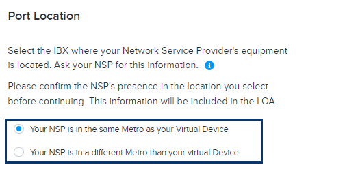

Configuring the Port​
  1. Click Start Standard Configuration.
  2. In the Port Location section, indicate whether the NSP is in the same metro or a different metro as your device.
  3. Select the IBX where your Network Service Provider's equipment is located. Your NSP will provide the location.
    • If your NSP is in the same metro as your device, select Your NSP is in the same Metro as your Virtual Device and then select an IBX.
    • If you NSP is in a different metro than your device, select Your NSP is in a different Metro than your virtual Device and select a location.

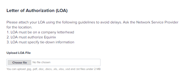

  6. Upload your LOA file by clicking Choose File and browsing to the file. You will not be able to proceed with the order if you don’t upload an LOA.

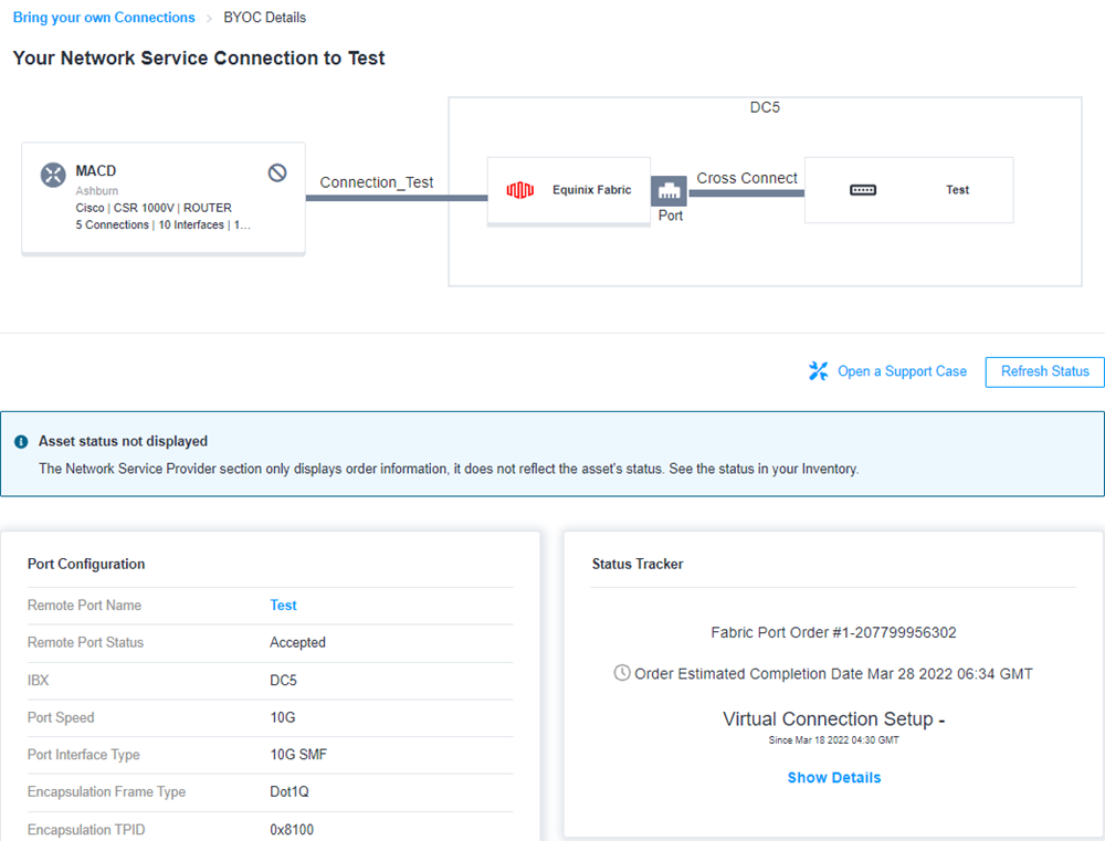

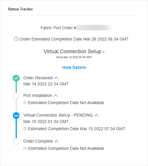

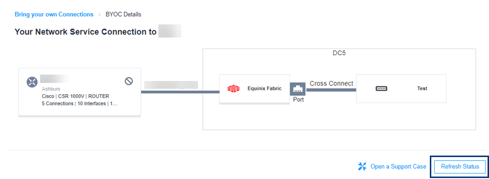

Status Tracker​
You can check the status of your connection order by going to the BYOC Inventory and clicking on the connection. The preview at the top of the page will display a diagram of the connection you configured.
The Status Tracker will display the current status of your order, including the progress of the order and the estimated time of completion.
Click Refresh Status to get the most up-to-date status.
Order Summary​
The Order Summary section provides the port, Network Service Provider, and Virtual Connection details as well as a pricing summary.

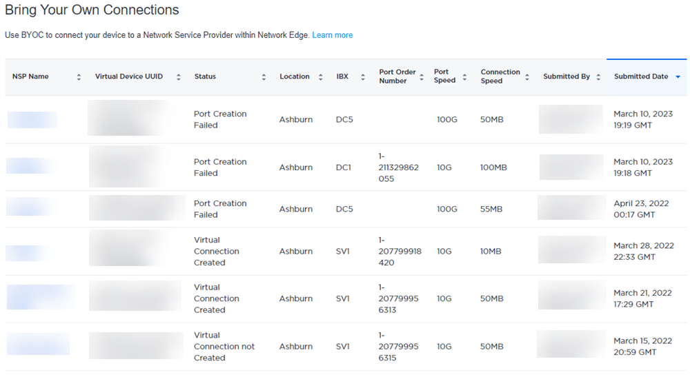

Bring Your Own Connections Inventory​
From the Network Edge menu, select Bring Your Own Connections to access your inventory.
Your connections display in a table. Columns include:
  • NSP Name – Network Service Provider name
  • Virtual Device UUID – Your device’s universally unique identifier (UUID)
  • Status – Connections status
  • Location
  • IBX
  • Port Order Number
  • Port Speed
  • Connection Speed
  • Submitted By
  • Submitted Date

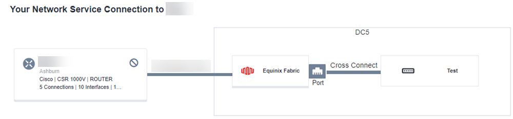

BYOC Details​
Click on any connection in your inventory to view BYOC Details and check the status of your connection order.
