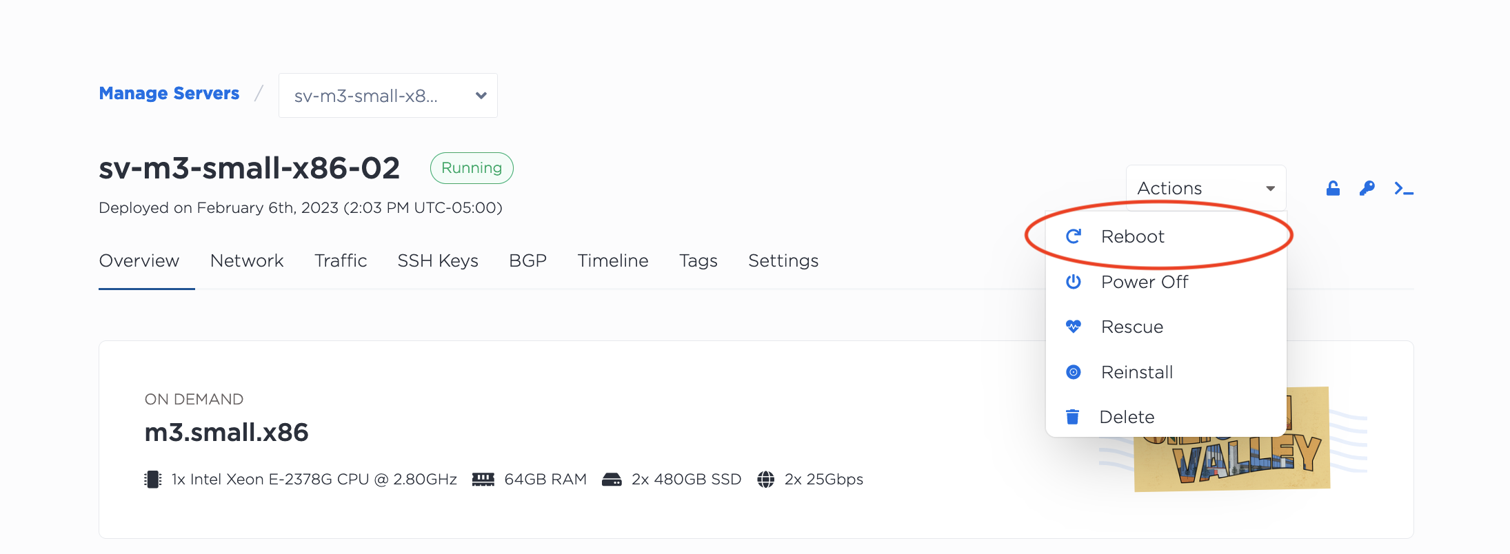

Click the Actions drop down menu and click Reboot. When you confirm the server reboot, you should get a "Server Action Succeeded" message.

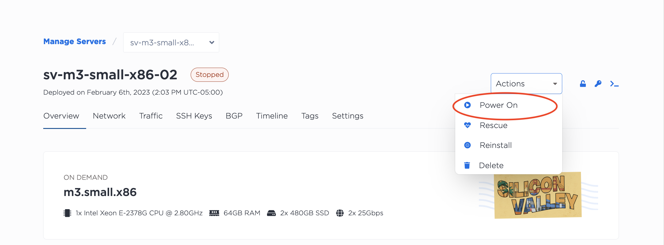

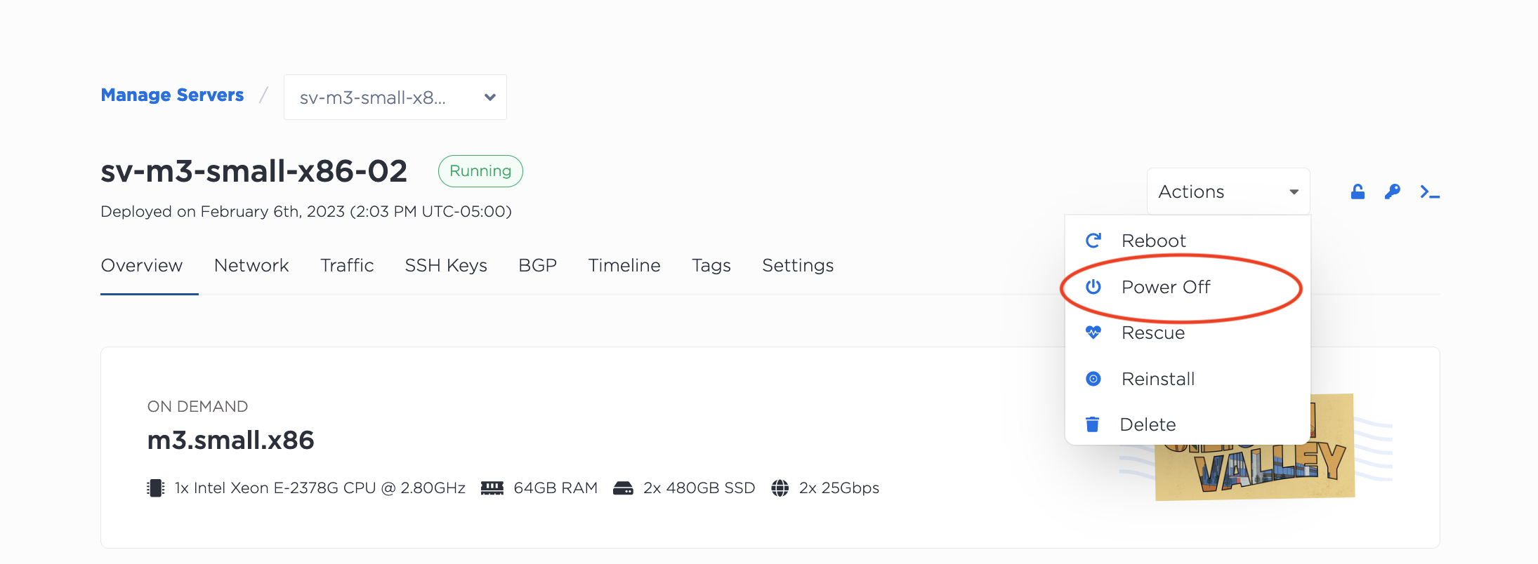

To Power Off a server, click the Actions drop down menu and click Power Off.
When you confirm that you would like to power off the server, you should get a "Server Action Succeeded" message and the server status is updated to Stopped.
To Power On a server, click the Actions menu and click Power On.
Once you have confirmed that that you would like to power on the server, you should get a "Server Action Succeeded" message and the server status will update first to Starting and then to Running.

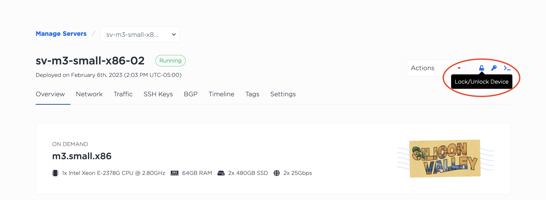

To lock or unlock a server, click the lock icon next to the server Actions drop down menu.
