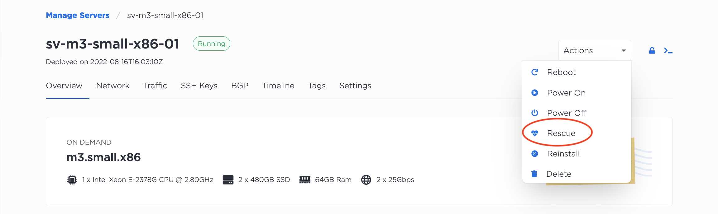

To enter Rescue Mode, you can find Rescue Mode from your server's main Overview page. Click on Server Actions, and select Rescue OS from the dropdown.
Rescue OS in the Server Actions Menu
This reboots the server, loads the Rescue OS Alpine Linux image into RAM, then boots the server into Alpine Linux. The public IPv4 address of the server stays the same.

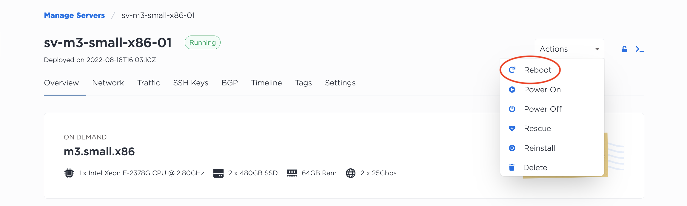

From the console:
To reboot your server from its Overview page, click on Server Actions, and select Reboot from the dropdown.
Rebooting a Server from the Console
Once the server has finished rebooting from either process, it will boot back into your original operating system.
