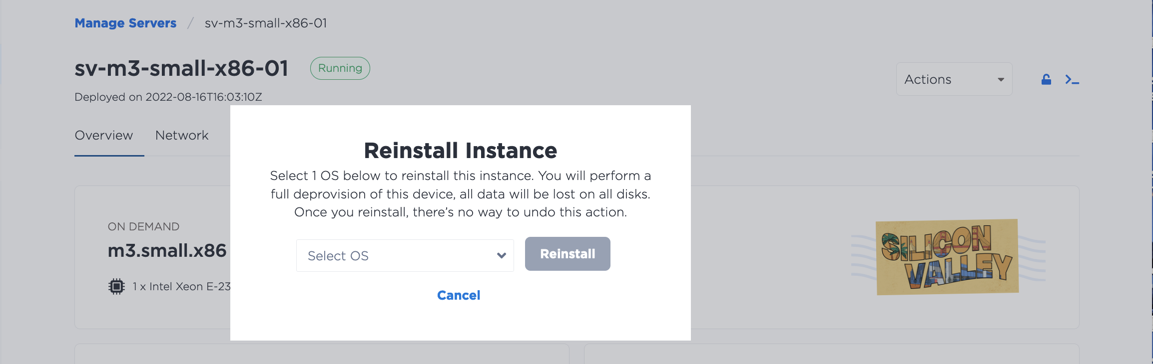

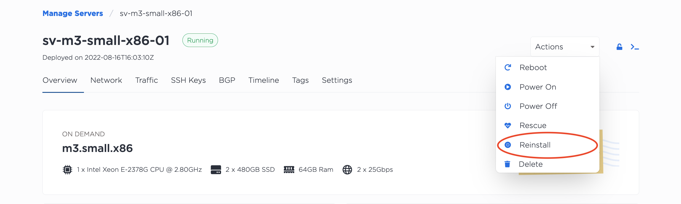

To reinstall a server, click Server Actions from the server's Overview. Click Reinstall.
Then select the operating system you want to be installed from the drop-down. The current operating system is selected by default. If you choose the Custom iPXE, a field for your iPXE script URL will appear.
Note that you do not have to option to preserve data when you reinstall a server through the Equinix Metal console. If you want to use those options, you will need to reinstall through the API.
