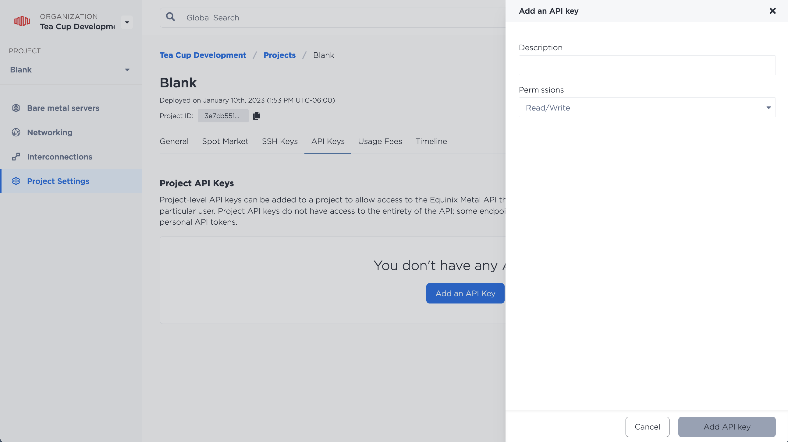

You can create a Project API key in the Project Settings, on the API Keys tab. Click Add an API Key. Add a description for the key, and chose whether it has Read/Write or Read-only permissions.

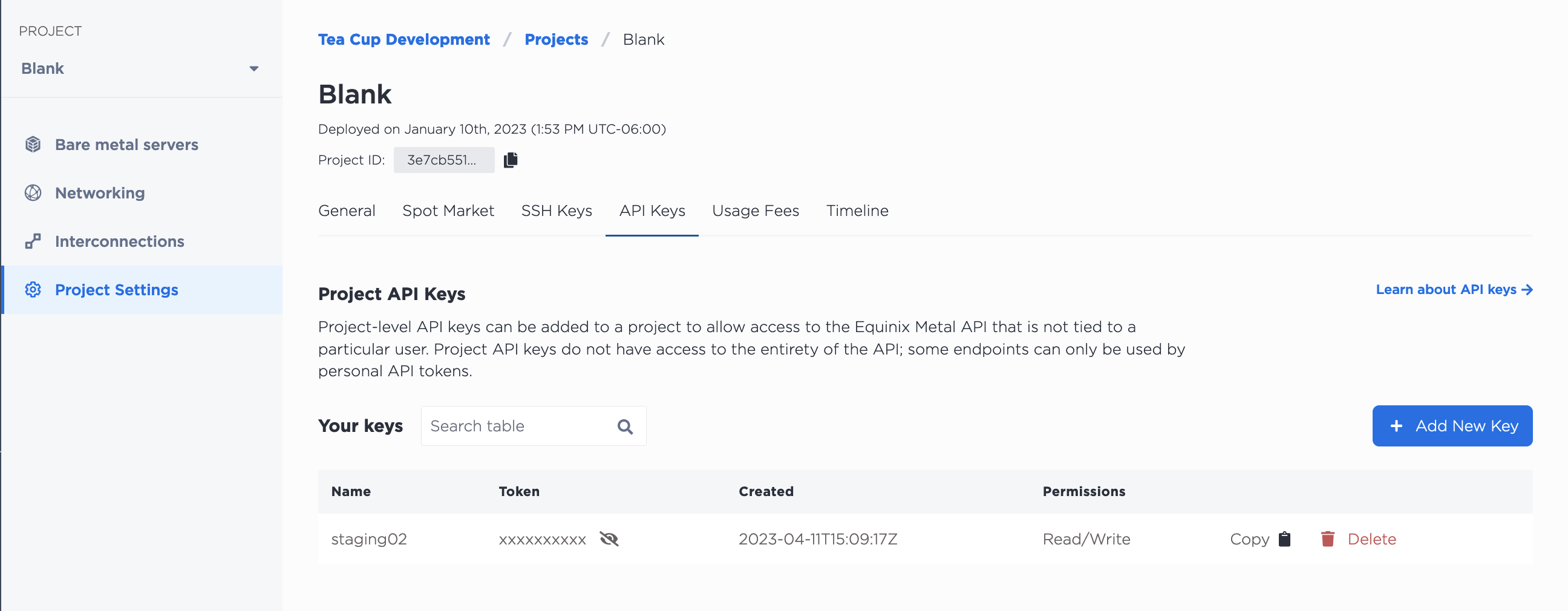

A Project's API keys are listed in the API Keys tab of the Project Settings.
