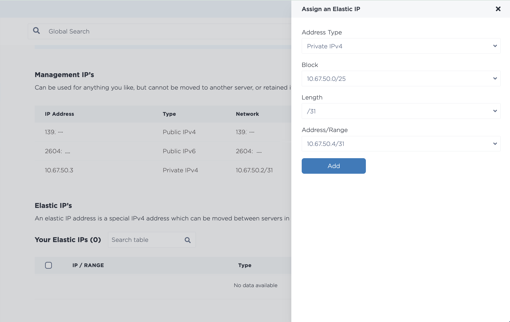

From the server's Network tab, in the Elastic IPs section, click + Assign New Elastic. A slide-out appears that allows you to select the subnet and IP Addresses to assign.

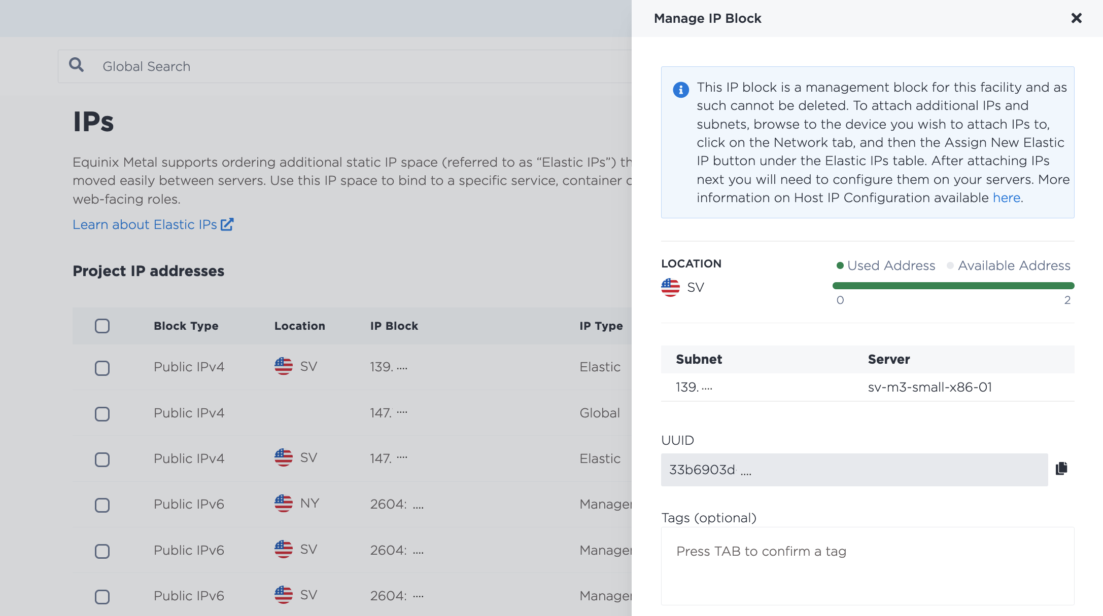

To check the status of subnets and IP addresses in the console, click your Project's IPs tab. Click on the Actions menu of the IP block and you can see which subnets and IPs are assigned to which servers.

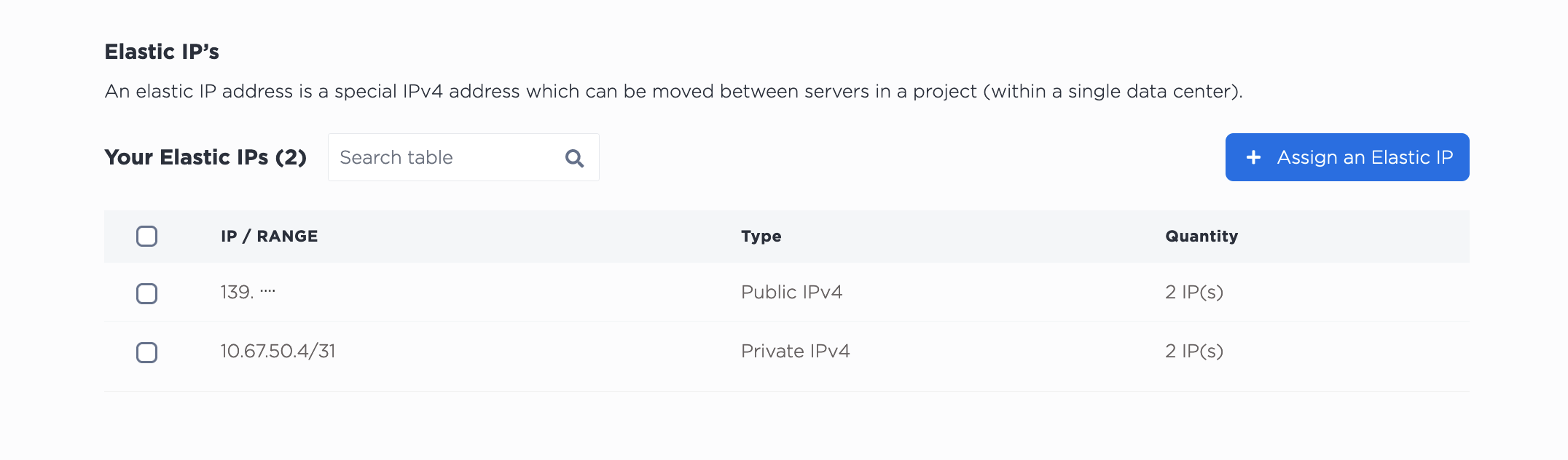

For a server-level view, navigate to the server's Network tab. Under the Elastic IPs section, you can see the Elastic IPs assigned to that server.

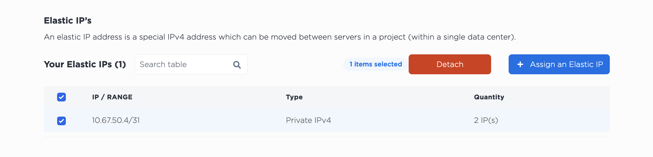

To unassign a subnet or IP address from a server, navigate to the server's Network tab. Under the Elastic IPs section, select the Elastic IPs, and click Detach to unassign it from the server.
