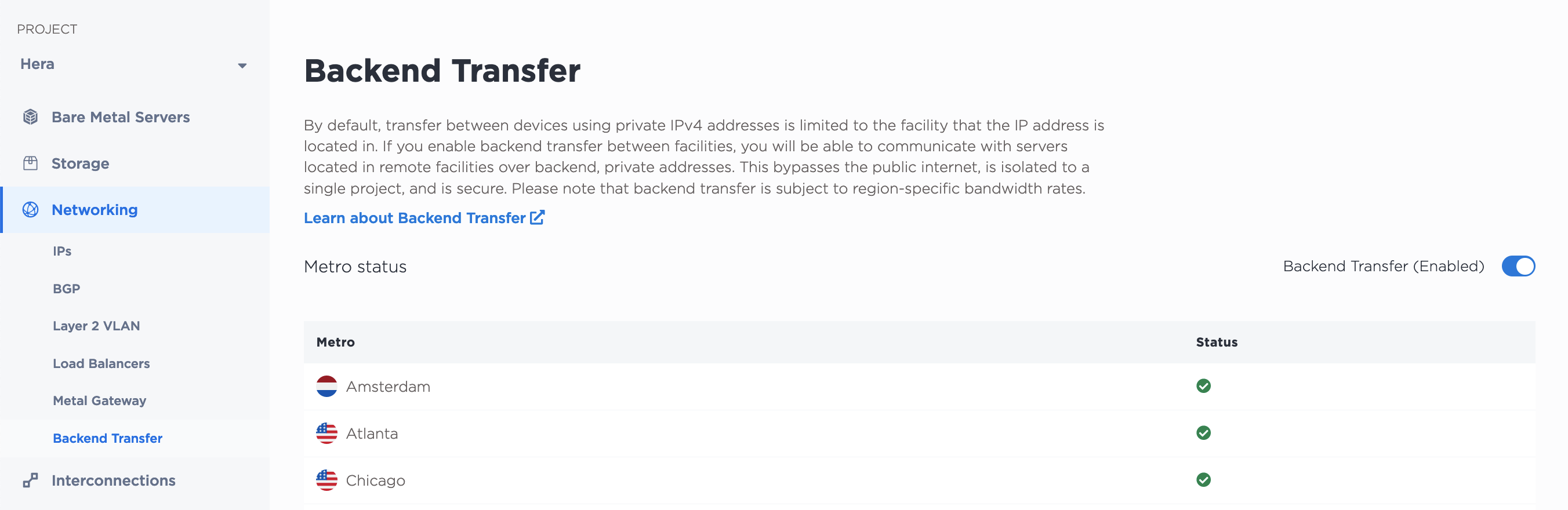

In the Equinix Metal console, you can enable from the Backend Transfer page, found in the Project's Networking section. Click the toggle to enable. When enabled the text says, "Backend Transfer (Enabled)".

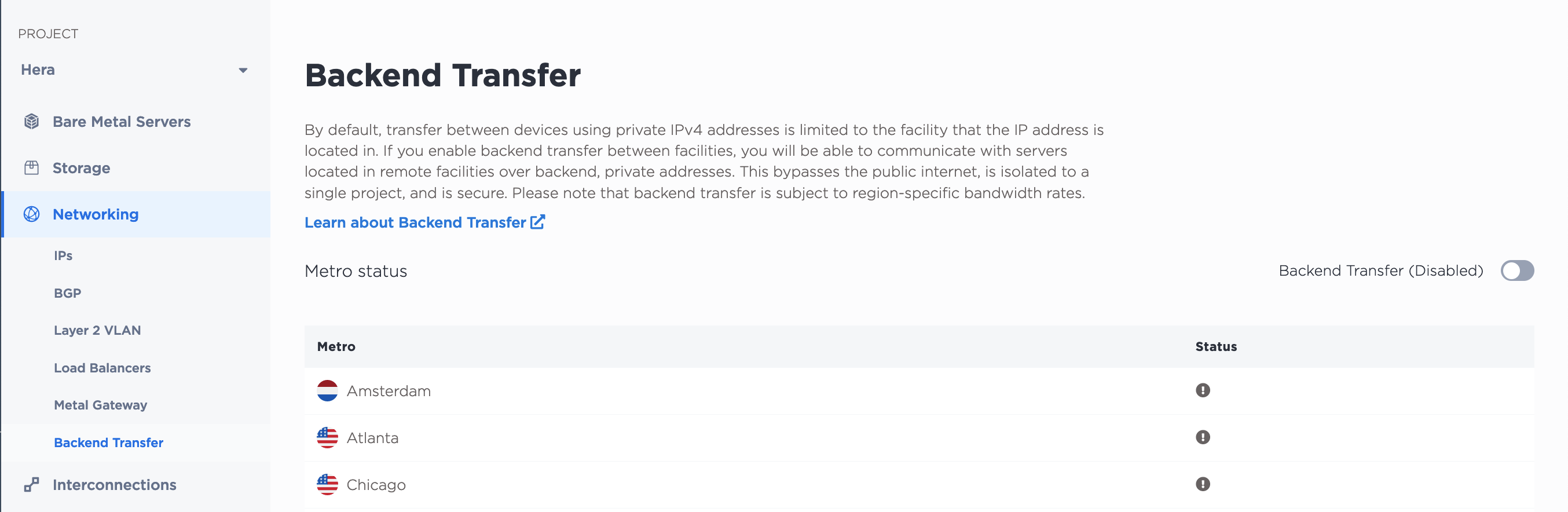

- Console
- API
To disable Backend Transfer on a Project, click the toggle on the Backend Transfer page. When disabled, the text says "Backend Transfer (Disabled)".
