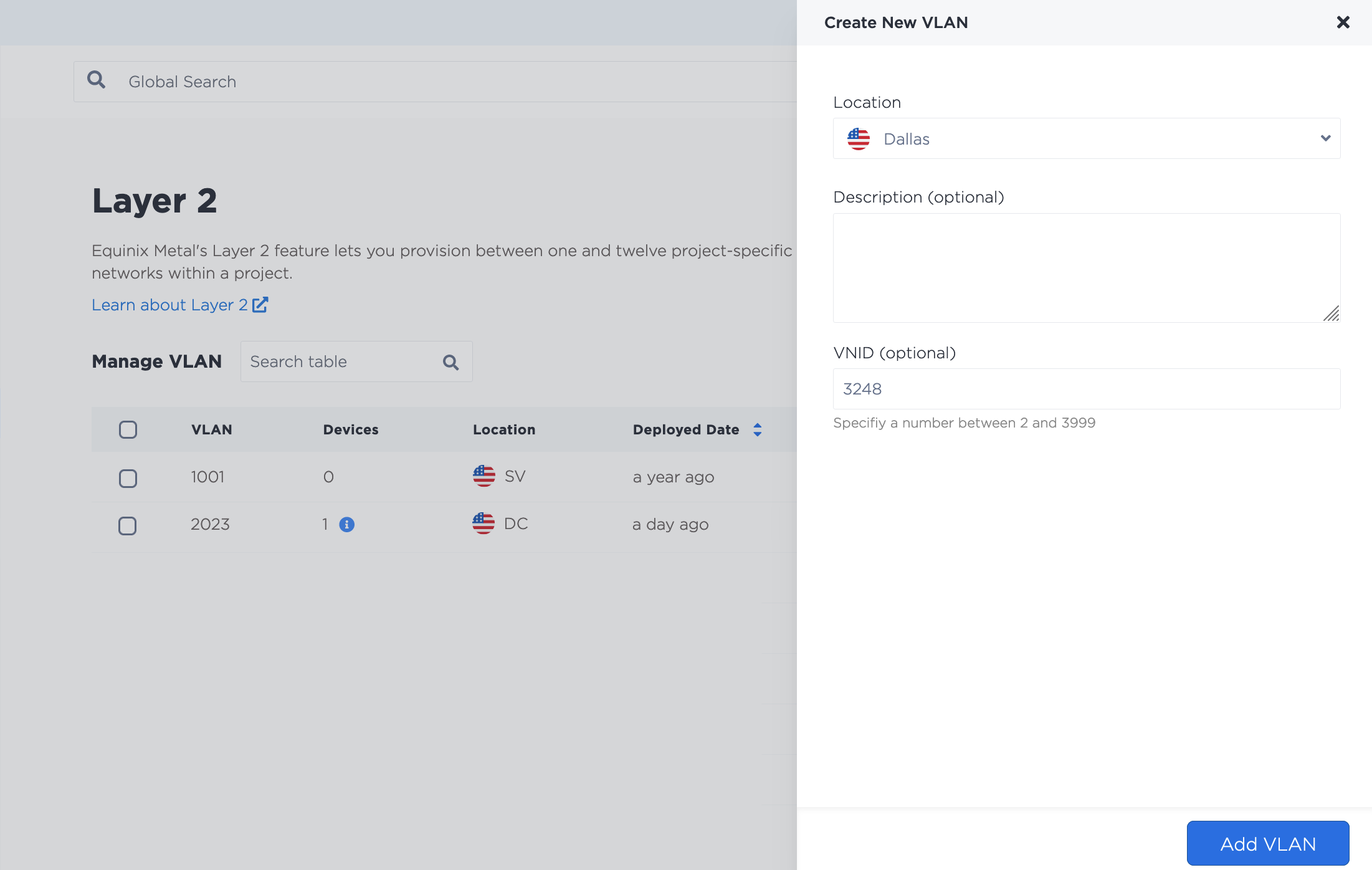

You manage VLANs on the project's Layer 2 VLAN page. To provision a VLAN, click + Add VLAN.
- The only required field is Location. Pick the Metro where the VLAN is going to live from the drop-down.
- You can give your VLAN a friendly, human description in the Description field.
- The optional VNID field can be filled with integer between 2 and 3999 to serve as the VLAN ID. If omitted, the VLAN ID is auto-assigned incrementally by metro, starting at 1000.
Clicking Add provisions the VLAN. Once it's done provisioning, the new VLAN will be listed on the Layer 2 page. The assigned VLAN ID displayed here will be used when you attach servers to the VLAN.

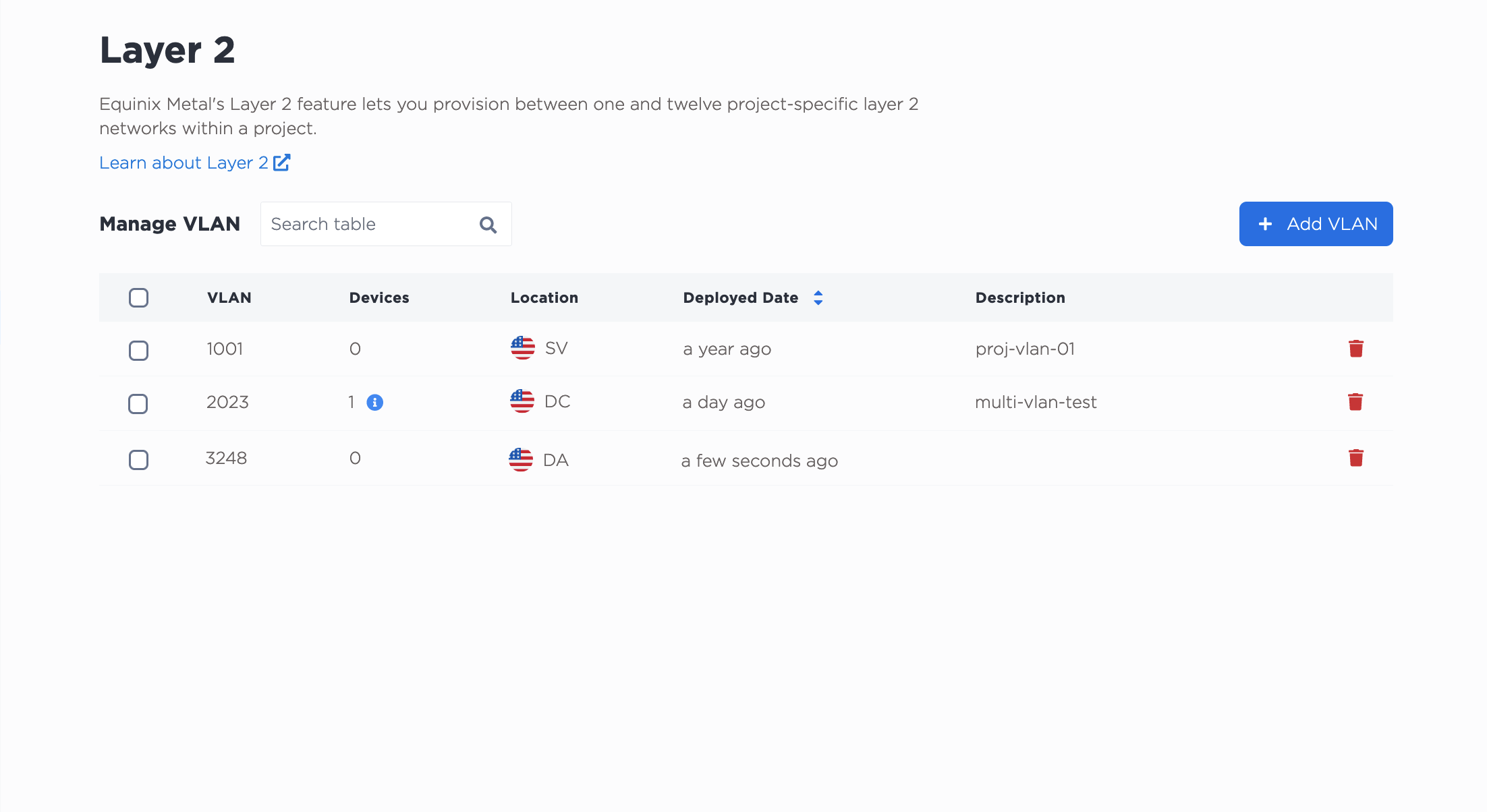

You manage VLANs on the project's Layer 2 VLAN page Each VLAN in the Project is listed with its ID, description, location, number of connections, and the option to Delete it.
If the VLAN is in use, you are able to see how many devices are connected to the VLAN in the Devices column, and clicking on the number will bring up a list of those devices.

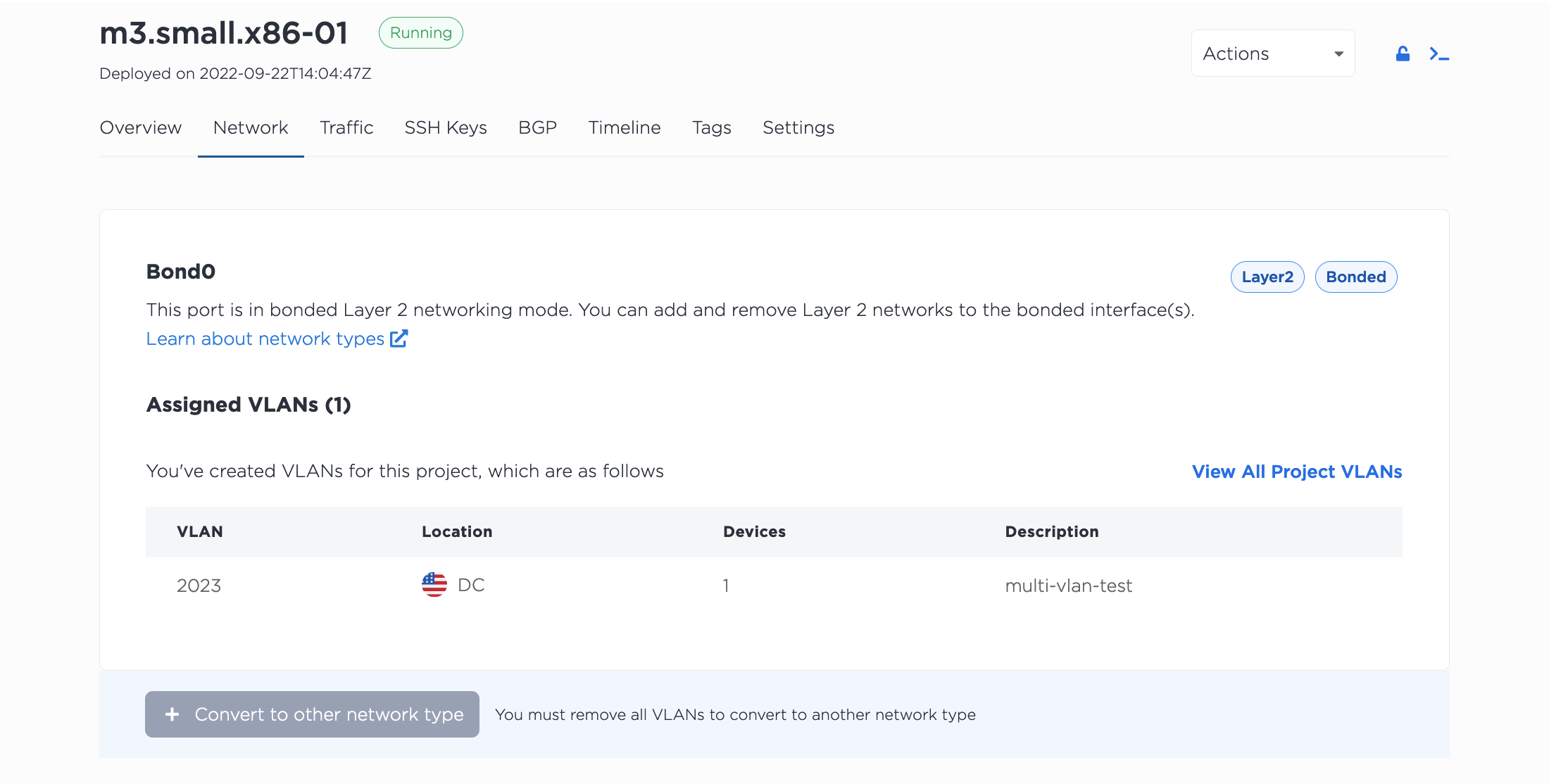

From the Server's Network tab, you can see which VLANs the server is attached to.
And in the Layer 2 section, you can see which ports the VLANs are assigned to.

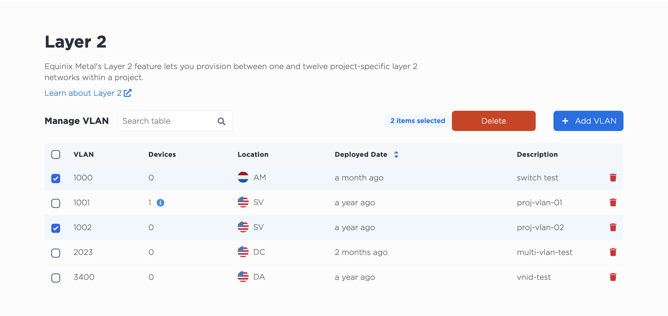

Open the Layer 2 VLAN page. Select the VLAN you want to delete and click Delete. If you wish to confirm multiple VLANs, select each VLAN you want to delete and click Delete.
