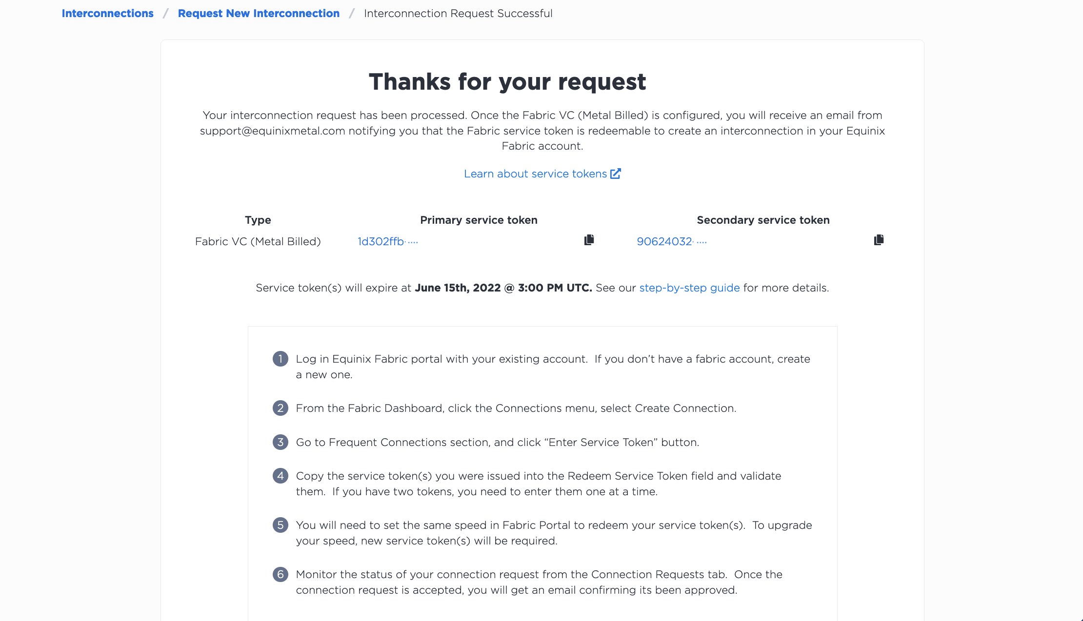

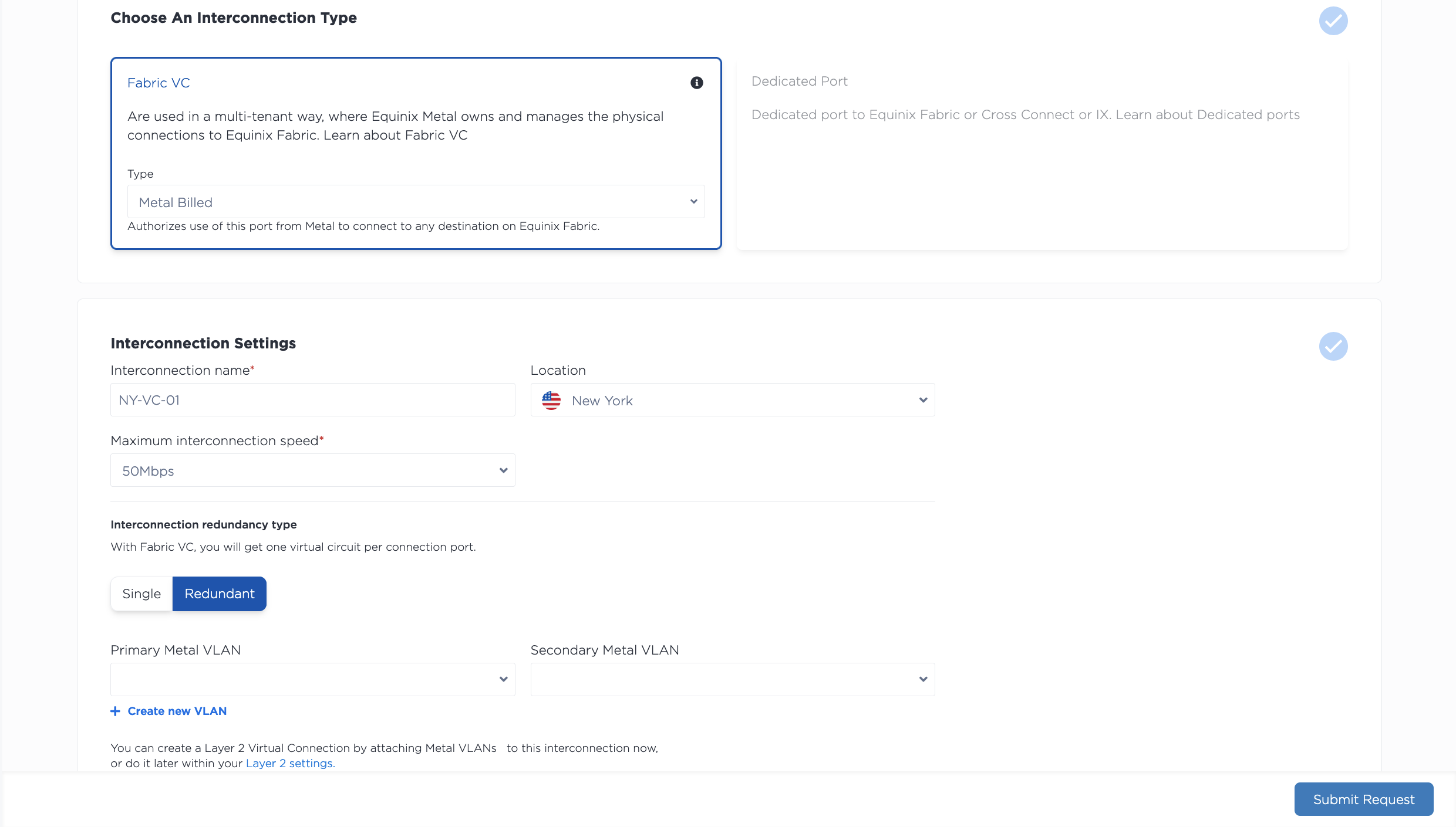

To request a Fabric Virtual Connection, open the Project's Interconnections page. Click + Request New Interconnection.
In the Interconnection Type section, click the drop-down under Fabric VC, and select Metal Billed.
- Select the location for the new connection from the drop-down. You will want to select the metro where both your Equinix Metal infrastructure lives and the metro where the CSP you are connecting to on Fabric is: these interconnections are metro-bound.
- Give a name to your connection.
- Choose whether you want a set of redundant ports. Redundant ports are highly recommended. Selecting a single port may result in significant downtime due to planned and unplanned outages.
- Set the connection speed by selecting it from the drop-down. Note: the speed cannot be changed after a service token is issued. A new request and service token is required to change the speed.
Next, select whether you are attaching your ports to a VLAN or to a VRF.
If you are using just VLANs, select the VLAN or VLANs that will be connected to your ports. The VLANs need to be in the same project and location as your Fabric VC. If you do not have any eligible VLANs, you can click + Create a VLAN to create them. The same VLAN can't be connected to two or more virtual circuits, so if you are requesting redundant ports, select a VLAN for each. Note: You will not be able to update or change the VLAN after the Fabric VC is created.
If you are using VRF, select the VRF for your ports. There is additional documentation on the VRF for Interconnections page.
Review the summary of your request. Click Submit Request to receive your a-side service tokens.
Tokens expire in 7 days. You should also receive an email with your tokens and expiration information. On the Interconnections page, your newly requested Fabric Virtual Connection will be listed on the Pending Requests tab.

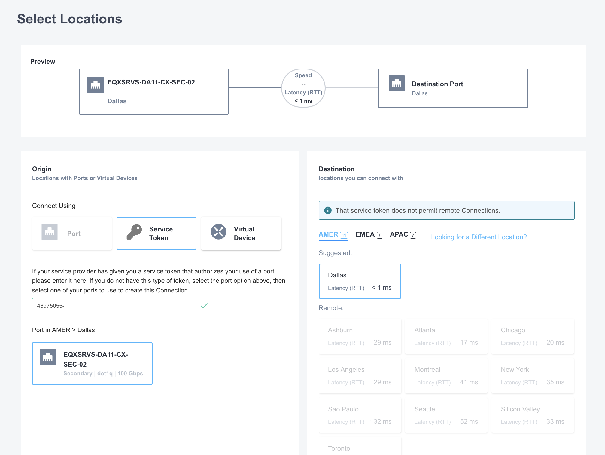

Redeeming Your A-side Service Token

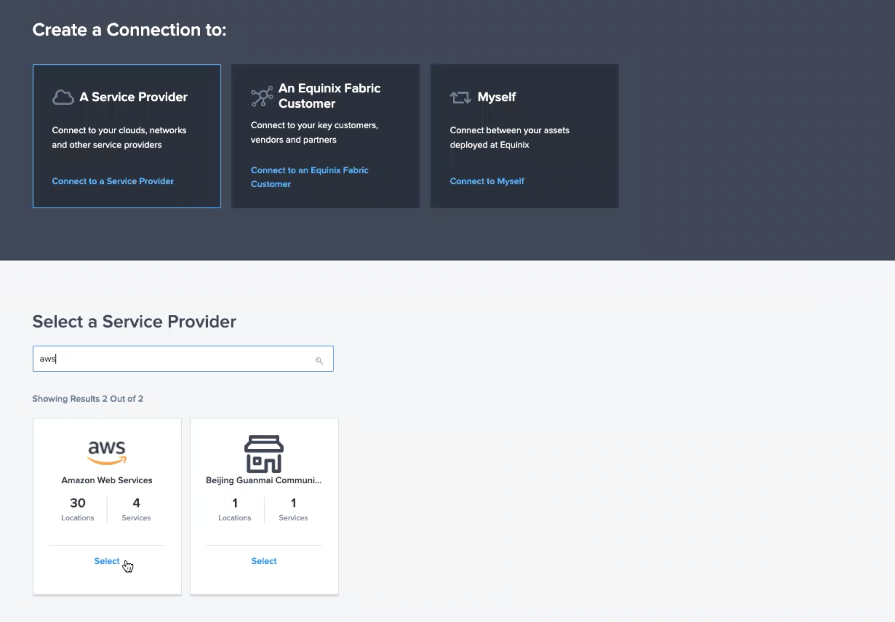

To redeem your token, login to the Equinix Fabric portal, and from the Connections drop-down menu, click Create a Connection.
Select the destination of the connection, which can be a cloud service provider such as AWS or Azure, or a Fabric port that you own. Equinix Metal as the destination is NOT supported.
If connecting to a cloud service provider, select A Service Provider and select the one you are looking for.

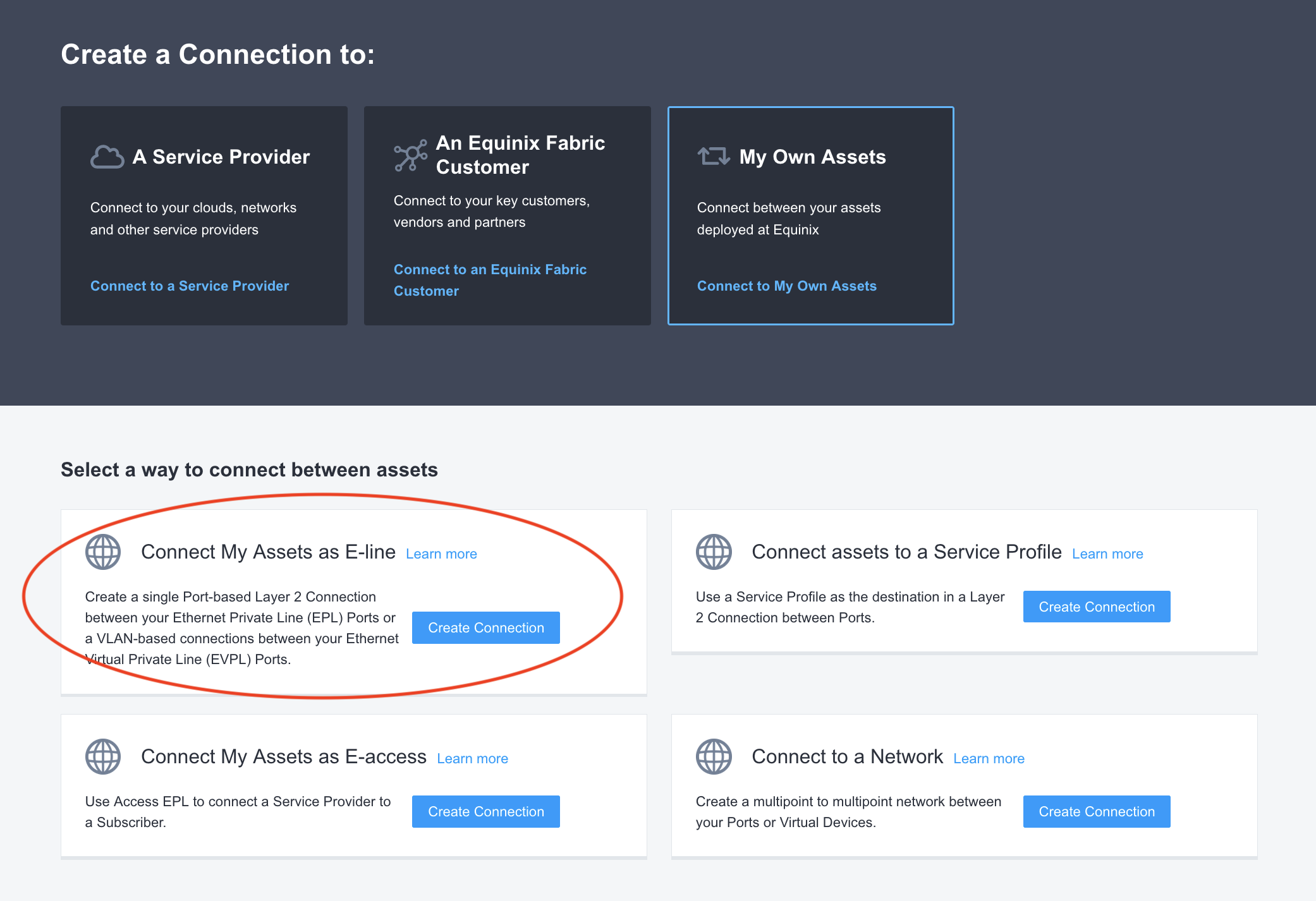

OR
If connecting to your own Fabric port, select My Own Assets and Connect My Assets as E-line.

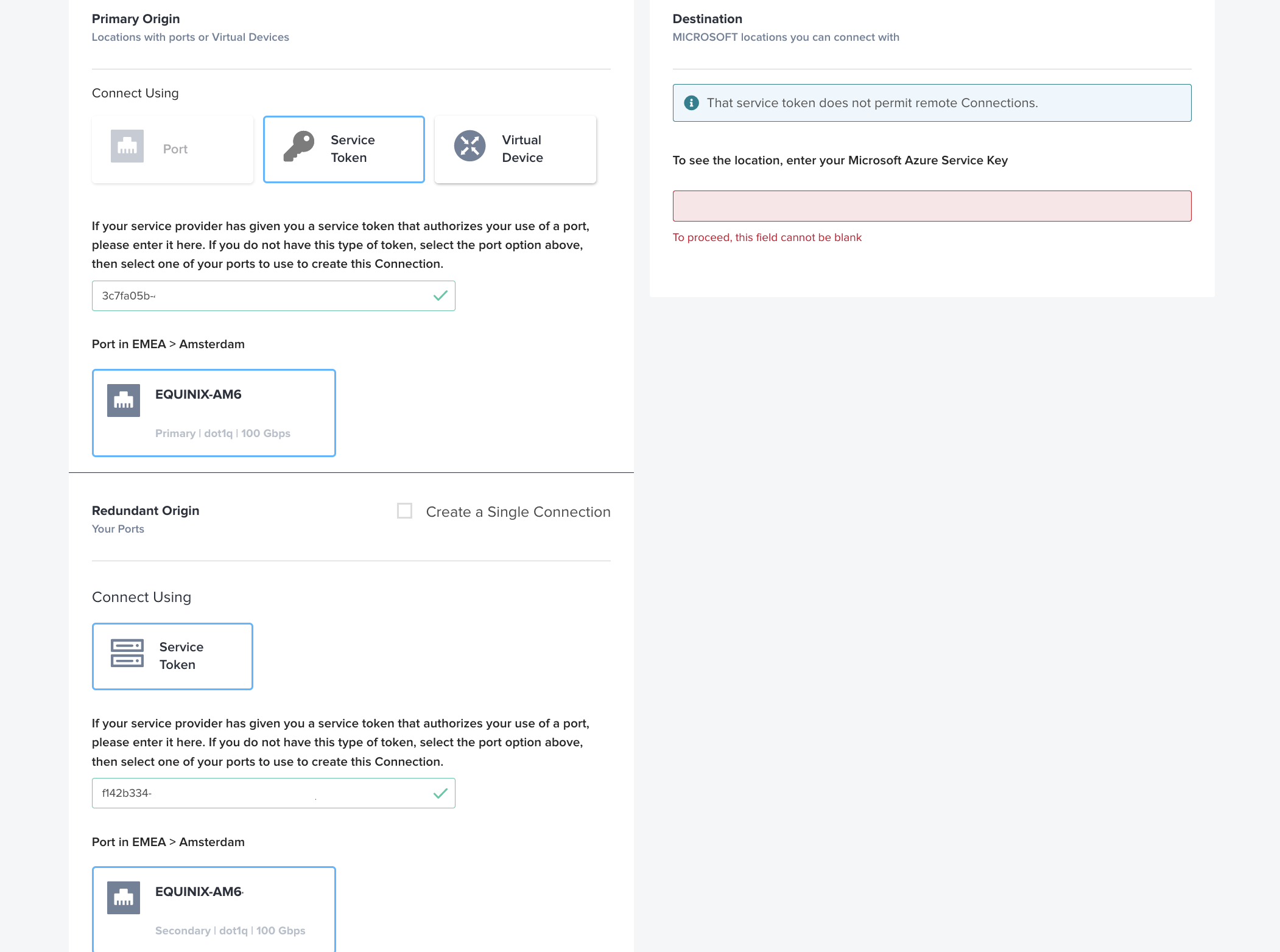

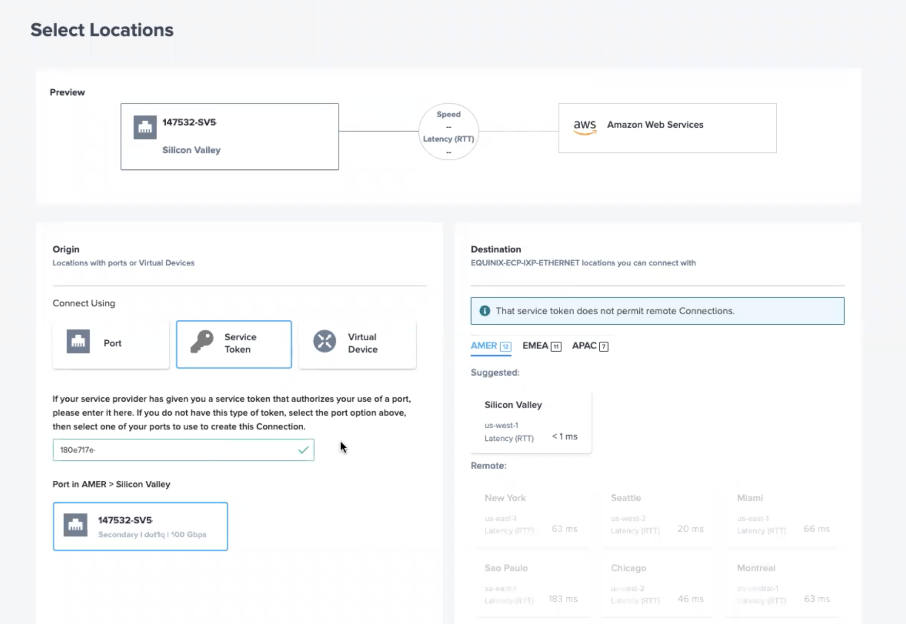

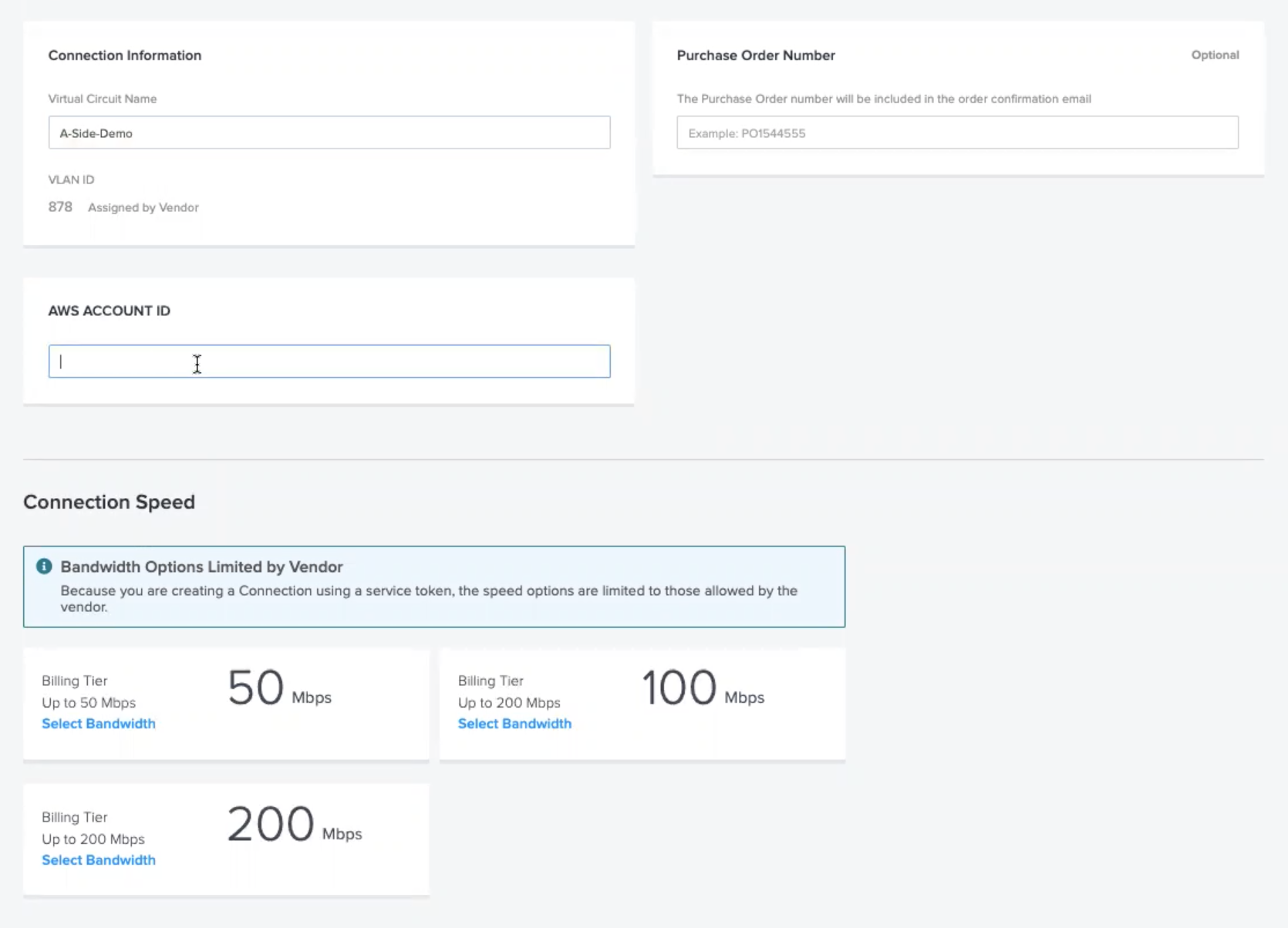

Once you have selected your destination, use your service tokens to set Equinix Metal as the origin of the connection. Select Service Token and enter the token in the field. The origin port information will be automatically populated once you enter the token.
If you are connecting to a cloud service provider, they may offer redundancy options that allow you to redeem both tokens at once.
Otherwise you will have to repeat this process for each token.
OR
If you are connecting to your own Fabric port, the origin port information will also be automatically filtered, and you will be able to see your options for selecting your destination Fabric port.
The destination options will be filtered to the metro that you requested on Equinix Metal. Select the one you want to connect to, and click Next.
Give the connection's virtual circuit a friendly name, and enter any information that is required by the service provider that you are connecting to, like your AWS Account ID. Set the speed of the connection, up to the limit that was set on Equinix Metal.
Click Next to review your choices, and when you are ready to place the order, click Submit Order.
Note: After submitting the order, you may also have to log into the account that you use to manage the service provider you are connecting to, in order to approve the connection from Equinix Metal and Fabric.

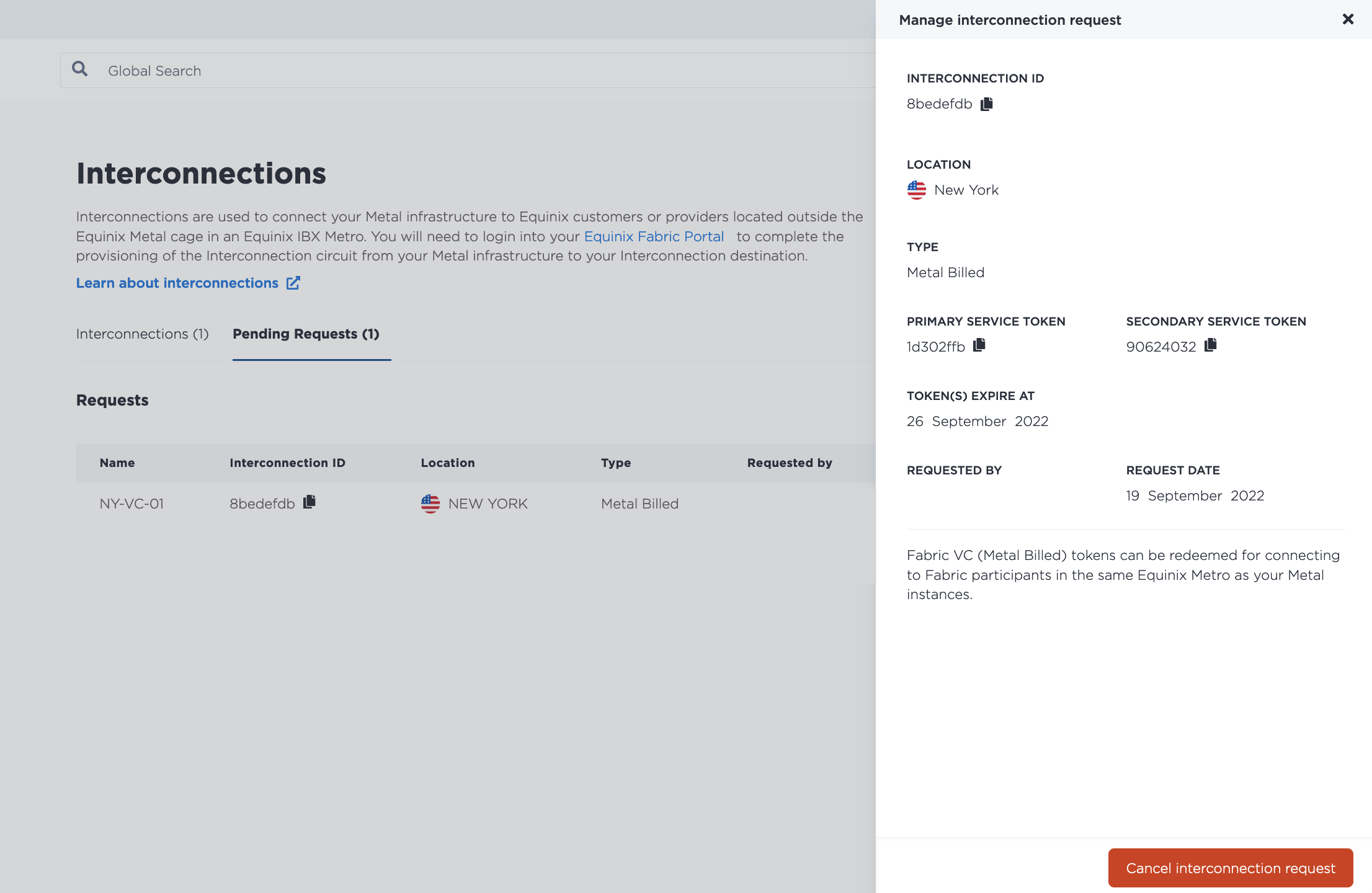

If you received two tokens for a redundant connection, and you were not able to redeem both tokens when connecting to the CSP, be sure to repeat the process to redeem your second token.
If you need to retrieve the tokens, they are available in the Interconnection Request tab. Click Manage on the Interconnection that you want the tokens for.

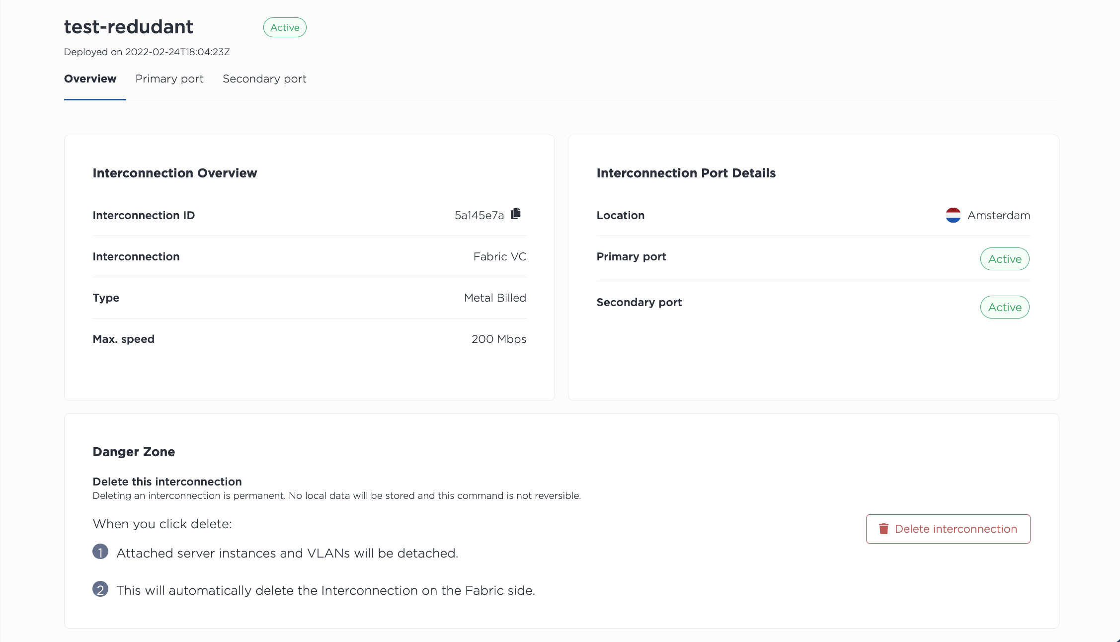

Managing Fabric Virtual Connections
- Console
- CLI
- API
Once the Interconnection is established between Fabric and Equinix Metal, it will appear on your Project's Interconnections page, in the Fabric VC section, with Active as the status. Billing starts when the status becomes Active on the the Fabric Virtual Connection.
- Fabric Billed Fabric Virtual Connections have type Fabric Billed.
- Metal Billed Fabric Virtual Connections have type Metal Billed.
- Interconnections that were set up as Shared Ports are indicated with type Legacy.
Note that Dedicated Ports are managed at the organization level, so if there are any Dedicated Ports in your organization, they will also appear in the Dedicated Ports section.
Clicking on the Interconnection's name brings you to its Overview page, which contains a detail view as well as a summary of the primary port and secondary port configurations.
Clicking either Primary Port or Secondary Port pulls up the port's status and configuration.

Deleting a Fabric Virtual Connection
Deleting a Fabric Virtual Connection is permanent. When you delete the connection, all attached VLANs will be detached, and traffic from Fabric to your servers will be cut off.
Deleting a Metal-billed Virtual Connection from the Equinix Metal side automatically deletes the connection in Fabric. If you delete it from the Fabric portal, it will also be automatically cleaned up on Equinix Metal side. This is an asynchronous process that can take up to 3 minutes to complete.
Please be sure to stop traffic before deletion, and ensure you clean up any resources associated to the connection from the destination Cloud Service Provider. Doing this before deleting the connection from the Metal or Fabric portal ensures the connection will be fully deleted and billing charges are stopped.
- Console
- CLI
- API
From the list of connections on the Interconnections page, click the name of the Fabric Virtual Connection you want to delete.
Click Delete Interconnection to delete the Fabric Virtual Connection permanently.
